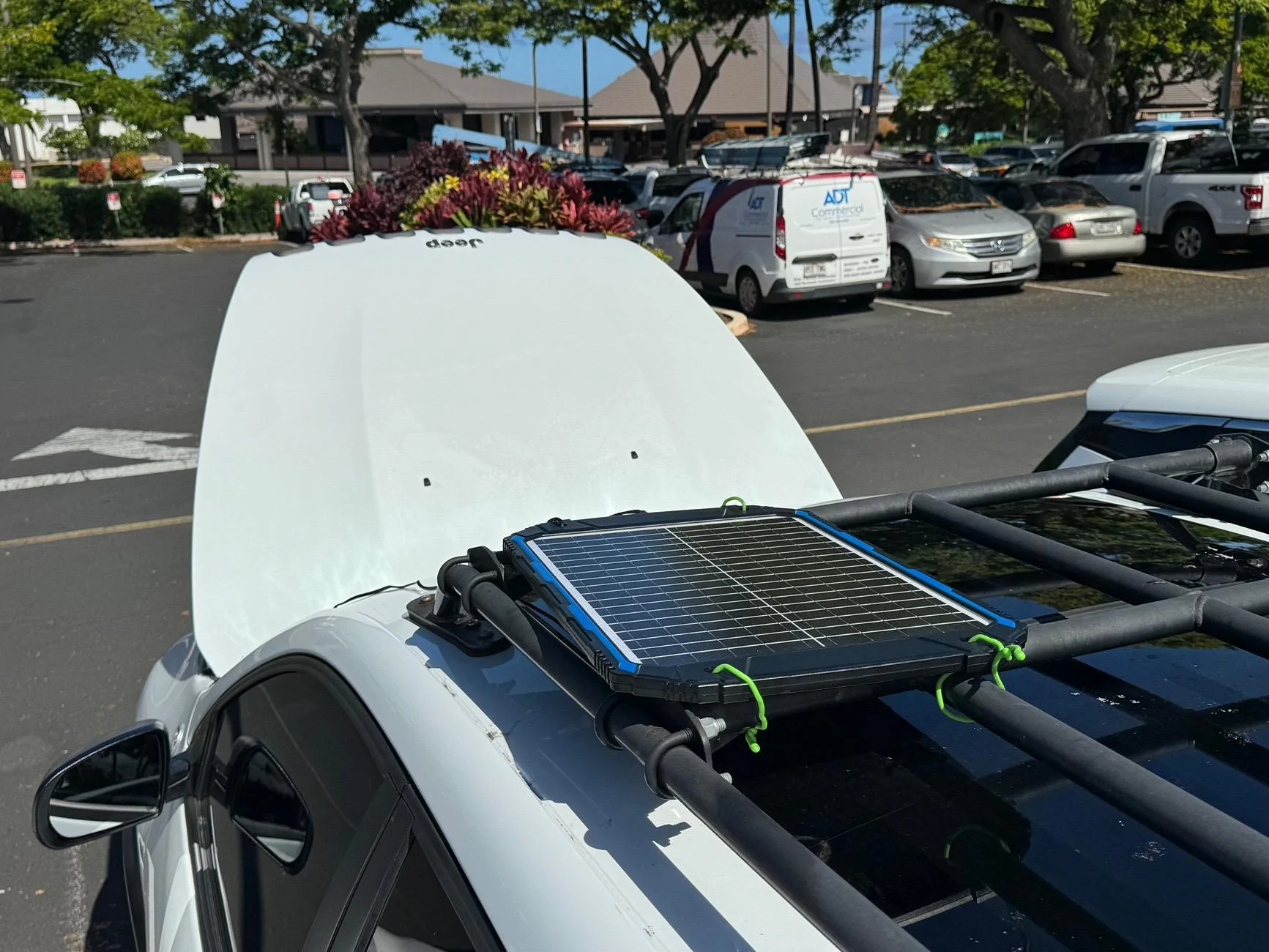

I have the same experience if I leave my camper hooked up via the 7-pin. Camper solar charges the battery and offsets the HV drain.
I have yet to check which battery is being maintained and if it causes issues because only one is.
I actually got this idea from your post about the camper being hooked up. I should have mentioned that and given you credit for the idea. Apologies!
Awesome, thanks for sharing. Did you put a meter behind the battery tender to see what your draw looks like there?
No, I wanted to see if this would work first. But based on preliminary results I plan to attach a Kill A Watt meter when I get back on island.
I mentioned this in another thread if anyone has tested a 12V tender. I'm interested as well in how the battery tender was hooked up. I have an unused BT that I'd be fine hooking up to the 12V battery. The VD is ridiculous and adding up to 1.5kW or more per day.
I hooked it up directly to the 12V positive and negative terminals. Will take some photos when I get back. This R1S was delivered a year ago (7/2023) so I'm pretty sure it was one battery + capacitor, unlike my 2 battery 2022 R1T.

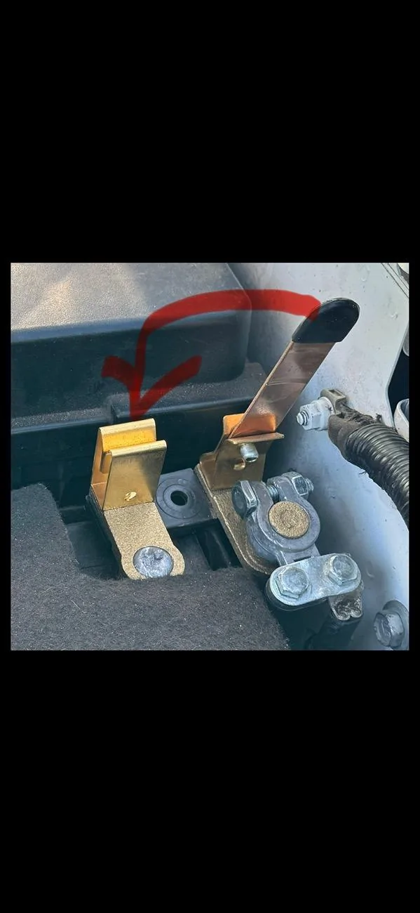

So, the HV battery is constantly maintaining the 12v battery, that is running who knows what. Hence, the vampire drain from the HV battery. Maybe this is a stupid question, but what if one were to just disconnect the 12v battery (maybe with a switch) when VD coud be an issue - for instance, on a multi-day camping trip, far away from any available charging source. Of course, you woud have to leave the vehicle open so that you could gain access, after the battery has been disconnected. If a switch was accessibe externally, maybe you wouldn’t even have to do that. Obviously, the real answer to VD is identifying and disabling, if possible, those sources that are constantly draining the 12v battery. Considering it’s now been several years dealing with this issue, I am not optimistic that Rivian, or anybody else, has an answer to vampire drain.
I can't remember his user name but the owner who shipped an R1T to Germany last year disconnected the 12V during shipping, made sure the frunk didn't close, and had minimal vampire drain.
I actually have a battery disconnect in my Jeep in Hawaii. I used to keep the battery tender on the Jeep, but I started leaving it at the airport, disconnecting the battery AND hooking up a solar panel to charge the battery.

This is cool and all, but its still wildly inefficient. You are still paying for the electricity from the battery tender. Glad to hear the drain on gen2 vehicles are lower.
Exactly why I called it a possible hack. It might look effective but not actually doing much. Need the Kill A Watt to see how much is going towards maintaining that 12V battery. Might be a completely pointless exercise, although fewer cycles on the high voltage battery pack - especial while idle - is a win in my opinion. On the other hand, maybe the car is truly is deep sleep and not using a lot of energy? Who knows?
For reference, this will be a 28-day total experiment so we'll have 4 weeks of data on this.
BTW - still no loss in SOC in 3-1/2 days or 84 hours.

Yeah! This is what I’m talking about. If it’s possible to just disconnect the 12v with a switch, it may solve the problem. No 12v, no drain. I would certainly put the switch externally, where it could be accessed without opening the vehicle. Wouldn’t want to trust the frunk to not close, then being SOL. Although, I believe there is external access to a closed frunk. As a bonus, add a solar panel to trickle charge the 12v, if needed. Additionally, I wonder it this would create any system issues upon reconnecting.
There have been reports of bricking the vehicle if you physically disconnect the 12 volt battery. With early dual battery vehicles, Rivian techs told people about a specific procedure they had to follow when changing batteries to avoid bricking. There are threads here about owners who changed their battery and had issues. I suspect that the number of bricking incidents will increase if people install 12v cutoff switches. IMO not worth if 1%-2% drain really bothers you and if 12v trickle might be the solution.
I'd be interested in the disconnect switch for multi-day camping scenarios ... of course, I'd want to test it really well at home to be sure the car comes back online smoothly.
