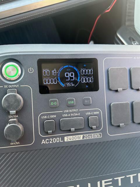

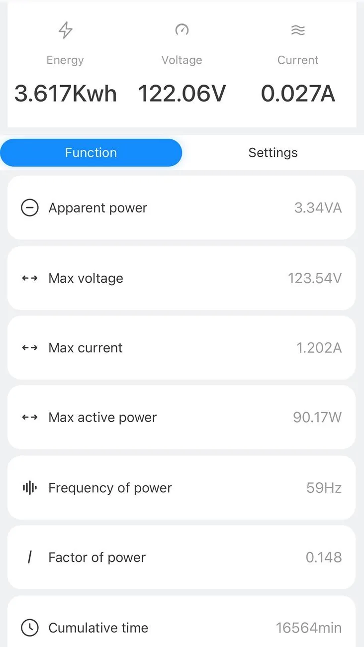

Just wanted to post some battery charger data. I did reset the energy monitor after the 12V was fully charged because I wanted to get a sense of how much juice it takes to maintain the battery. My car has been sitting for 2 weeks now with 0% loss from the HV battery.
Trickle charger usage over the past 11-1/2 days has been a total of:
3.617 kWh
or
0.31 kWh per day
Rivian R1T R1S Gen 1 Vampire Drain (Possibly) Solved (or Hacked) IMG_3255

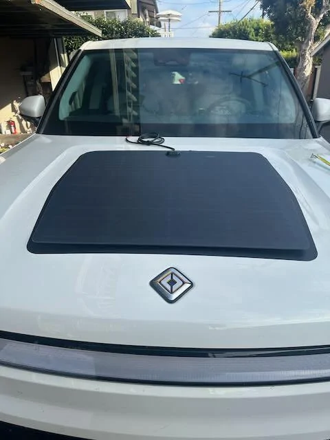

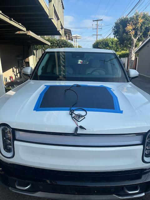

Solar Update:
As mentioned earlier in the post, I pulled the trigger on the Lensun.
It arrived this morning and I played around a bit and took some photos and decided to give my first thoughts.
Rivian R1T R1S Gen 1 Vampire Drain (Possibly) Solved (or Hacked) IMG_1791

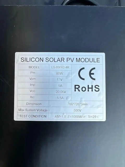

1. This version seems to be their "universal" 85w panel.
It would have been nice if it was cut/ designed to fill the full hood scoop/void

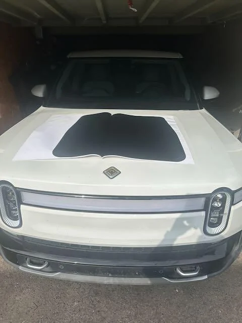

2. This does not have the metal eyelets like some mentioned/were concerned about
3. No Adhesive is provided. I have some 3M tape from other projects so I should be okay but that goes into my major gripe:
Do not buy the vinyl they offer.

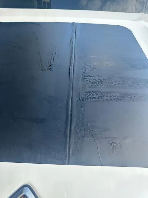

It came folded, even after letting it soften up in the sun most of the day it still had a crazy crease that stayed even after application and squeegee process.
Rivian R1T R1S Gen 1 Vampire Drain (Possibly) Solved (or Hacked) IMG_1787
For unclear reasons, the precut vinyl that is the same size of the panel came folded
(the panel was shipped and boxed flat)
I'm not a pro but I also have done this enough to know how to prep and apply, and holy shit it looks like dog water.
Rivian R1T R1S Gen 1 Vampire Drain (Possibly) Solved (or Hacked) IMG_1790

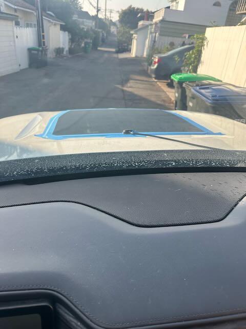

As mentioned it came with no actual adhesive so I mocked it up with painters tape.
Rivian R1T R1S Gen 1 Vampire Drain (Possibly) Solved (or Hacked) IMG_1792
I think it will look okay and it covers the line fine, but, even after being applied and undisturbed for about 6 hours, the vinyl came up with the painters tape!
Very discappointed
Will likely just find a local shop to wrap my whole hood and use VHB on that.
The hood opens and closes no issue, the panel is pretty light weight
I didn't notice any straining or audible struggling from the motors/struts when cycling
Rivian R1T R1S Gen 1 Vampire Drain (Possibly) Solved (or Hacked) IMG_1794
I was giving the vinyl as much time to succeed before a very rough test so by the time I got around to testing the panel itself I didn't have good sunlight (very close to sunset), I plugged the panel into a power station to verify and it works as expected.
Rivian R1T R1S Gen 1 Vampire Drain (Possibly) Solved (or Hacked) IMG_1795

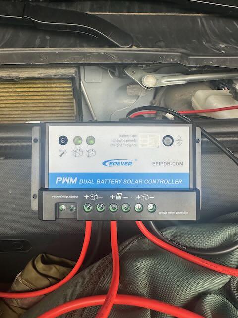

Next up I have to make cables to go between the charge controller and the batteries themselves.

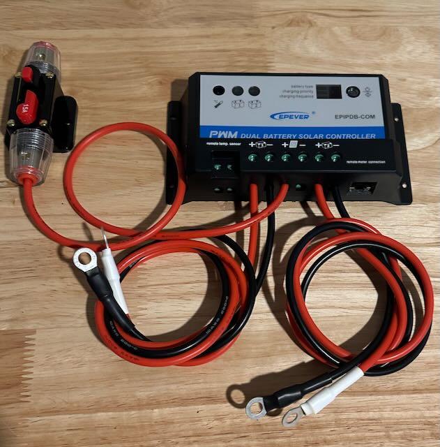

ETA: The panel comes with mc4 connectors, I opted to not buy the cheap charge controller they had as a bundle option as I wanted to use a dual output charge controller.
Here's the main portion of the "wiring harness" that I made this evening:
Rivian R1T R1S Gen 1 Vampire Drain (Possibly) Solved (or Hacked) IMG_1801
I somehow ended up with an uneven number of mc4 pins and plastic bits
and alas, nobody I know of sells connectors in person.
So I'll be waiting on Amazon to send me a new pack so I can make a short pigtail and wire the panel in to the controller.
Rivian R1T R1S Gen 1 Vampire Drain (Possibly) Solved (or Hacked) IMG_1805

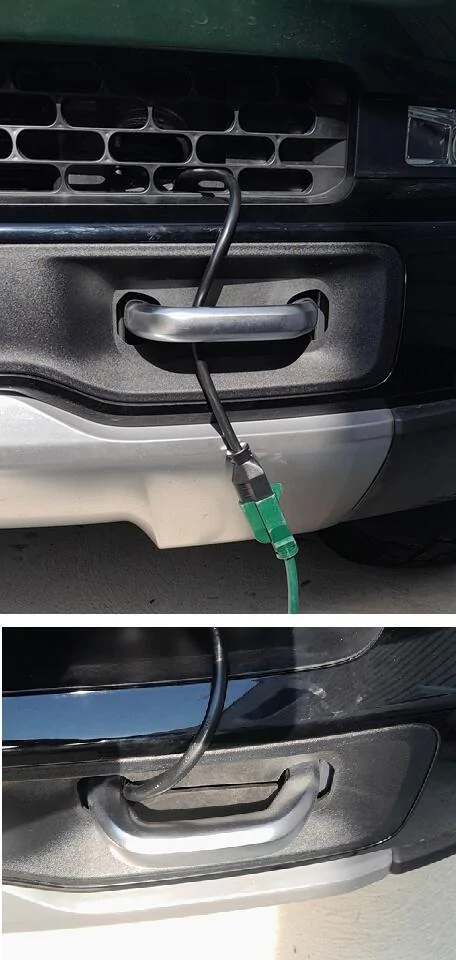

I parked my R1T on Sunday afternoon after backing the boat into it's shelter. I had 152 miles range indicated. I immediately plugged in my NOCO dual bank (I have two 12V batts in my R1T) charger and haven't touched the truck till just a few min ago which means it sat idle/on the trickle charger for approximately 2.5 days. I was happily surprised to see this morning it now indicated 153 miles range :)
Of course the tiny 5 amp NOCO charger can't actually add range, but at least it's keeping up with VD losses at this point!
It's been 6 days since I last touched my R1T, I just checked and now I'm at 148mi range. Lost just 4 miles range over a 6 day span with the trickle charger attached. For reference, without the trickle charger I was losing about 3mi/day on average. To break it down to simple terms, I'm now losing 2mi range every 3 days where I was losing 9 mi range every 3 days without the trickle charger.
