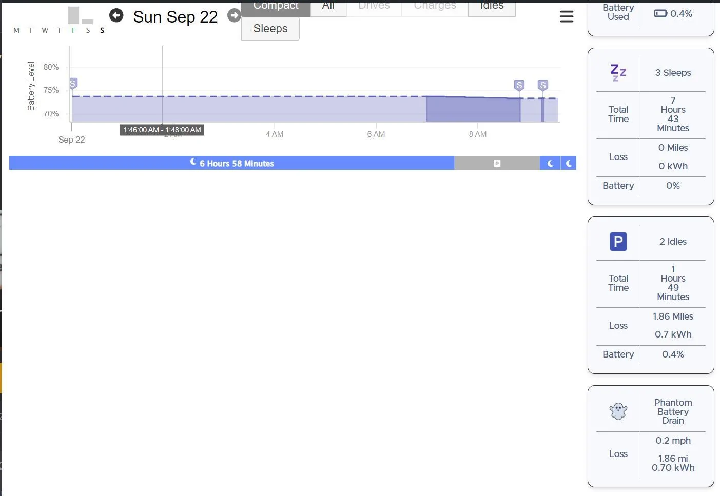

Okey, to expand and recap:
My 2022 R1T's 12V died a couple of weeks back. They were both replaced (dual 12V setup) last week, and I had the truck back in my possession last Friday. Since I saw that my PaaK was waking up the vehicle every time I was close to the living room, I removed both my wife's and my phone from the "keys" and just used the FOB.
It slept from 4:25pm Sunday Sep 22nd to 8:18am Monday 23rd. and the range/battery drain was almost zero.
Rivian R1T R1S Gen 1 Vampire Drain (Possibly) Solved (or Hacked) 1727102786029-ei
Rivian R1T R1S Gen 1 Vampire Drain (Possibly) Solved (or Hacked) 1727102424944-s5
Rivian R1T R1S Gen 1 Vampire Drain (Possibly) Solved (or Hacked) 1727102461424-jn
I think it's a great baseline to know and monitor in the future as the 12V batteries age and see if the VD worsens OR maybe Rivian changed the supplier and newer batteries behave better.

I had proximity off at home as well but I could still see Sleep/Idle cycles in Electrafi. Hence why I removed it as a test, I left my Fob in the same place I store the wallet when I'm at home and my other car keys.
Worth saying that I don't think this is the "silver bullet", but it contributes to the VD of the truck. I've seem other posts that suggest that even with PaaK disabled, the battery will drain substancially. I wanted to test the VD overnight with the brand-new 12V battery as a baseline so if in the future I repeat the same test and I see 2%, I know something isn't right.

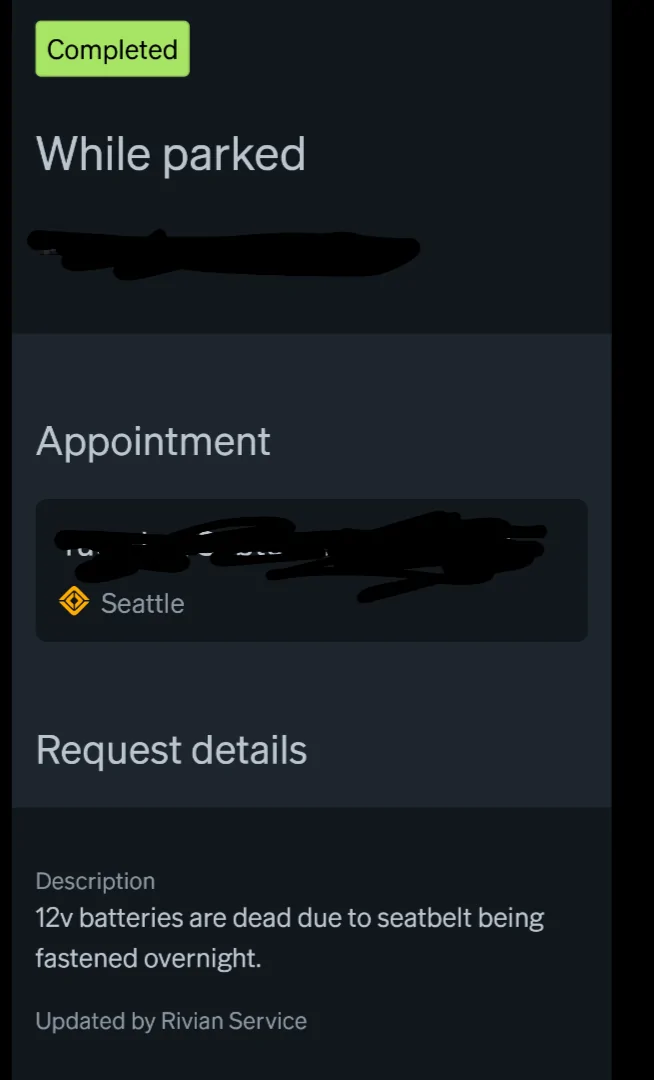

Is there a place that says that you can not do that? Or that you must disconnect belts?
But even then, how this can kill a 12V battery while you still have plenty of HV battery that should charge 12V !?
I mentioned this in another thread (I think...) An "emergency" circuit that does DC-to-DC not only for charging the 12V but also for bypassing it. In the event of a total 12V failure (shorted battery that won't accept charge), the charging circuit could be bypassed and feed the car with 12V and with a BIG emergency sign saying "Dude, if the SoC of the main battery drops, you're in big crap..., keep your truck plugged to an L2 charger and visit the Service Center ASAP".
