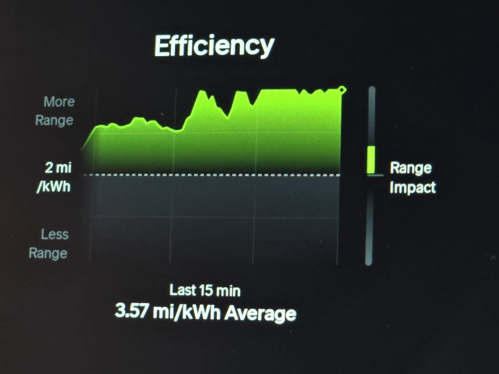

Also, I did notice that I was getting better range and efficiency, I did not know if it was just a placebo or real, so I did pay attention last night when driving back from a place that I frequent weekly and got this:
(Conserve mode, and mind you, it's a bit downhill from this place to my garage). Normally, I was getting 2.50 to 2.85mi/kWh in that same stretch at the same speeds.
There's definitely less 12V charging happening in my vehicle and that's 100% impacting my range/efficiency and battery drain.

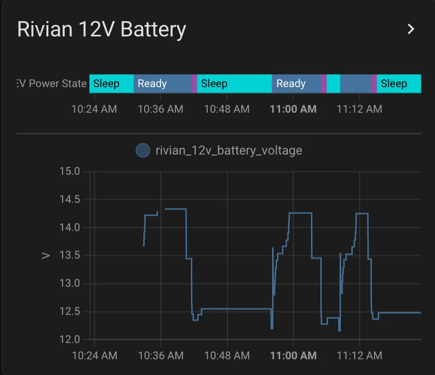

That is a bit strange as as much as charging a 12V battery takes per 24 hours (let's say 2kWh) - it should not affect driving efficiency in any visible way, IMHO.
I installed 12V battery sensor that reports to my Home Assistant:
I will continue to monitor this. I took delivery in May 2023, the car production date is March 2023, 1 battery. 23k miles
Which monitor did you get? I just picked up a Shelly Uni Plus for this exact reason.
I connected Shelly to home assistant (built-in in). And the rest was done in HA. If that what you asked.
In Shelly you need to add peripheral and choose voltmeter.
I also suggest to check the reported voltage by other tool and make an adjustment when calculating. In my case it was off by 5-10%
So you have a Plus Uni as well.
Wish we had have had this convo a few days ago... Not very intuitive. I ended up doing exactly what you said last weekend. FWIW, I ended up getting more precision (two decimal places) using Analog Input mode and Javascript to convert percentage to voltage (with the offset you mentioned).
