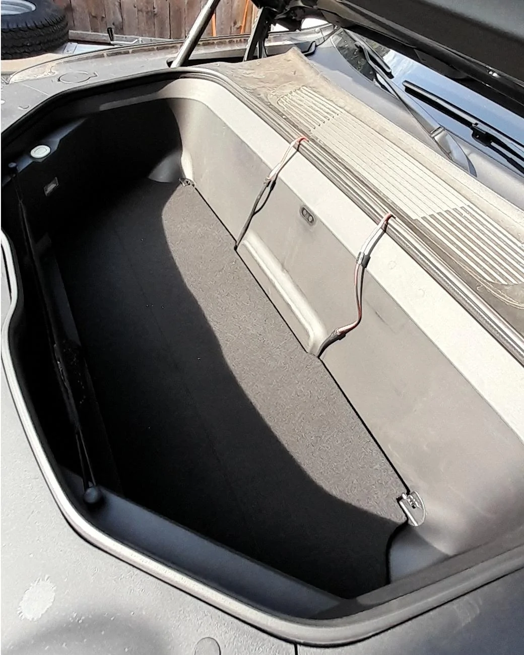

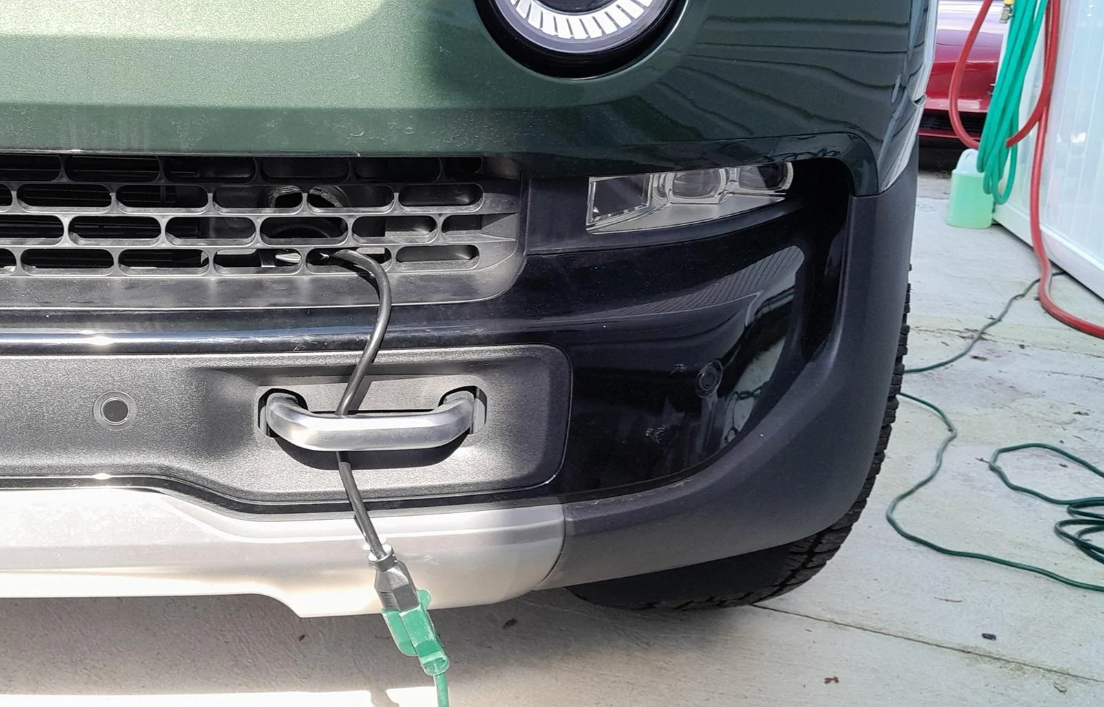

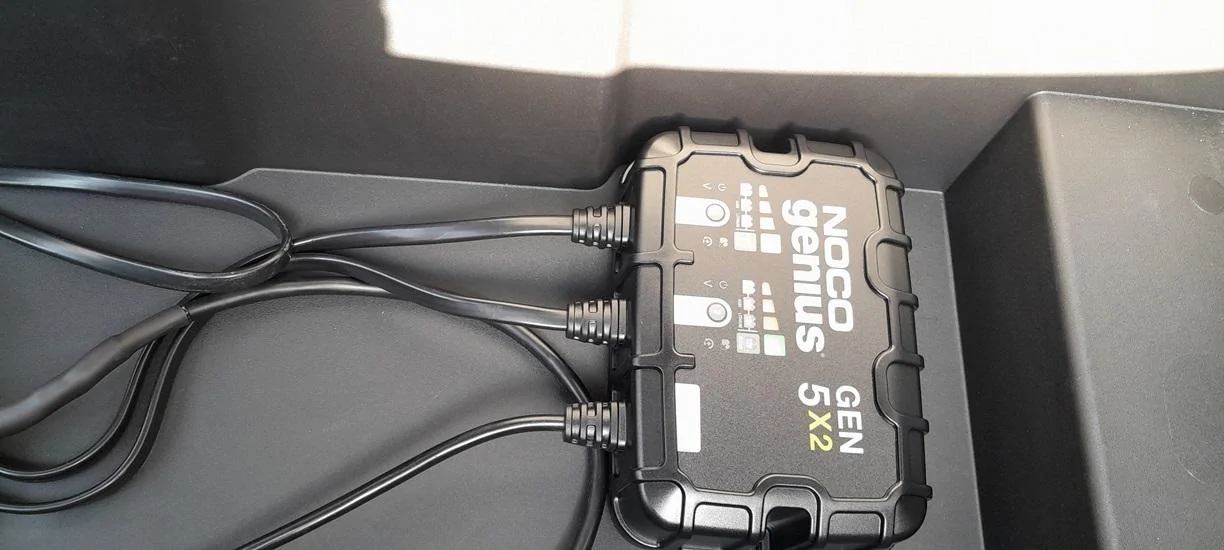

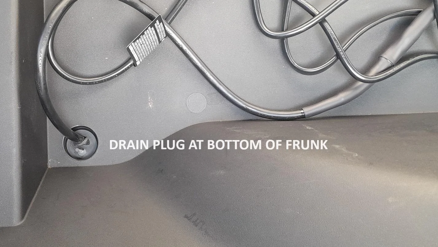

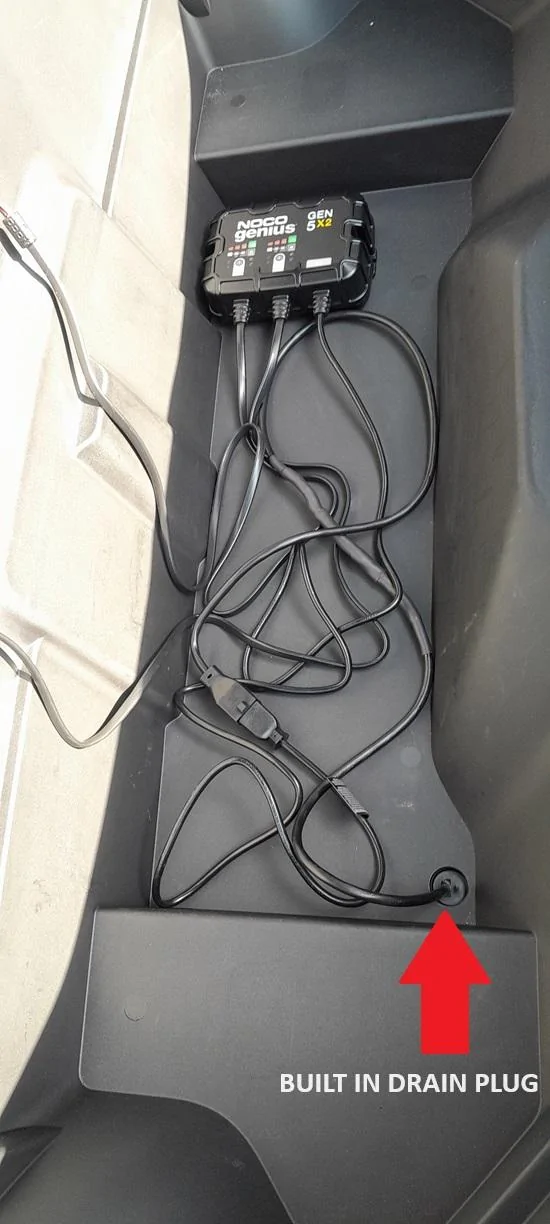

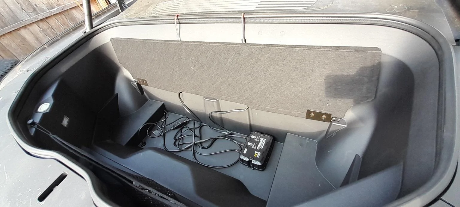

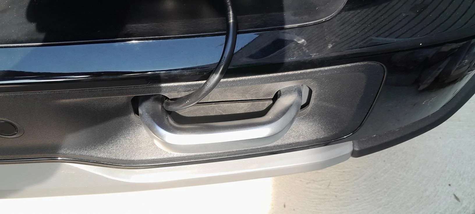

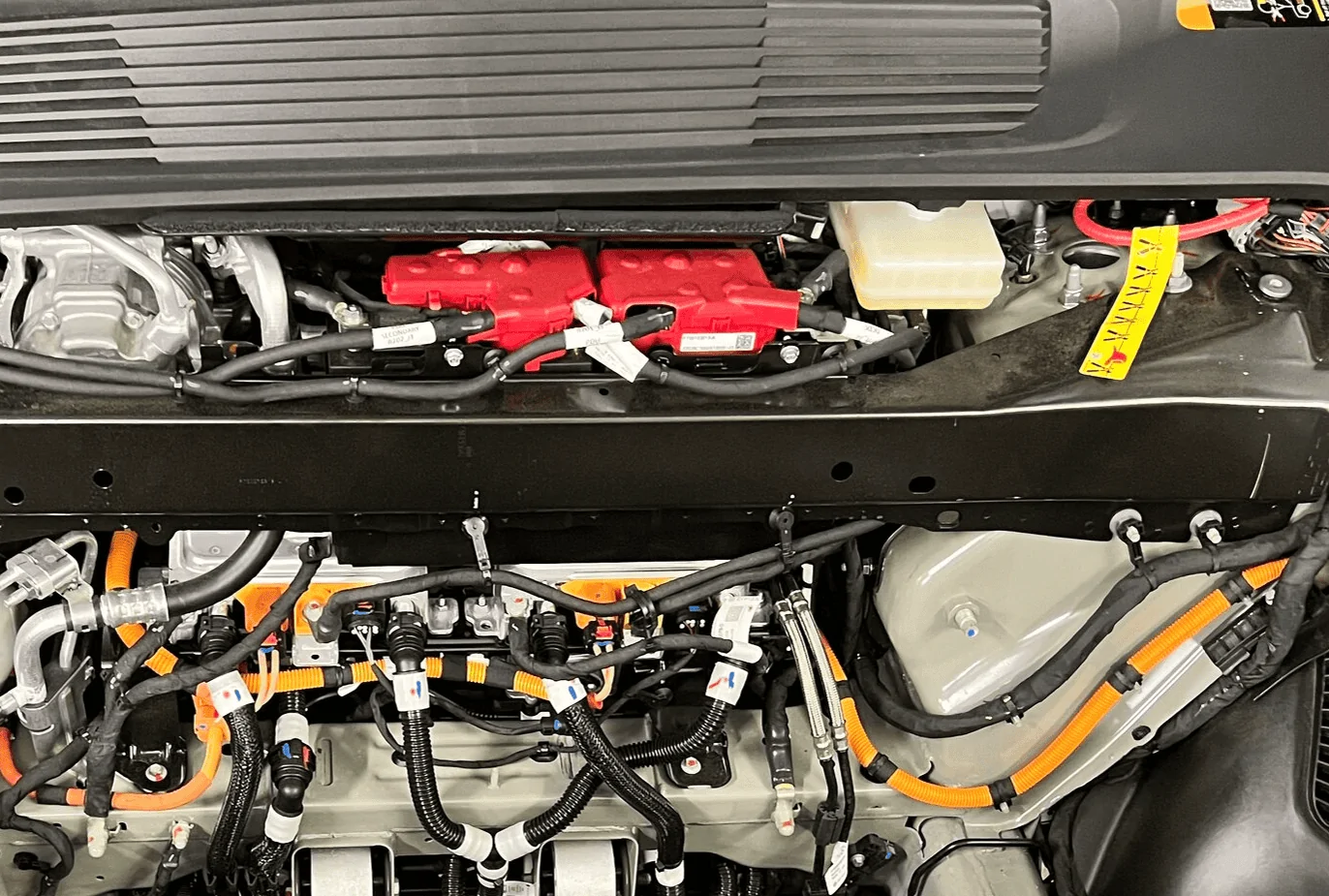

Here are some photos of my trickle charger install from yesterday.
- I removed the frunk tub (6 bolts and two cable connectors) so I could climb in and work on routing the 120V feed from the front tow hook under and across to the drain port at the bottom of the frunk tub.
- The 120V AC feed to the trickle charger runs through the horn opening that's right above the driver side tow hook in the front grill.
- When not plugged in, I just tuck the male 120V plug end in to the tow hook pocket and the tow hook rubber gasket holds it snugly in place, nice and neat.

Can you also please post a picture of how you hooked up the leads to the batteries? I am wondering if there is a common terminal that would charge both batteries in my dual-12V-battery R1T.

If you had the frunk tub off why did put the trickle charger in the frunk and run the wires back out of the frunk? Seems like you could have put the charger and wiring someplace outside of frunk tub.

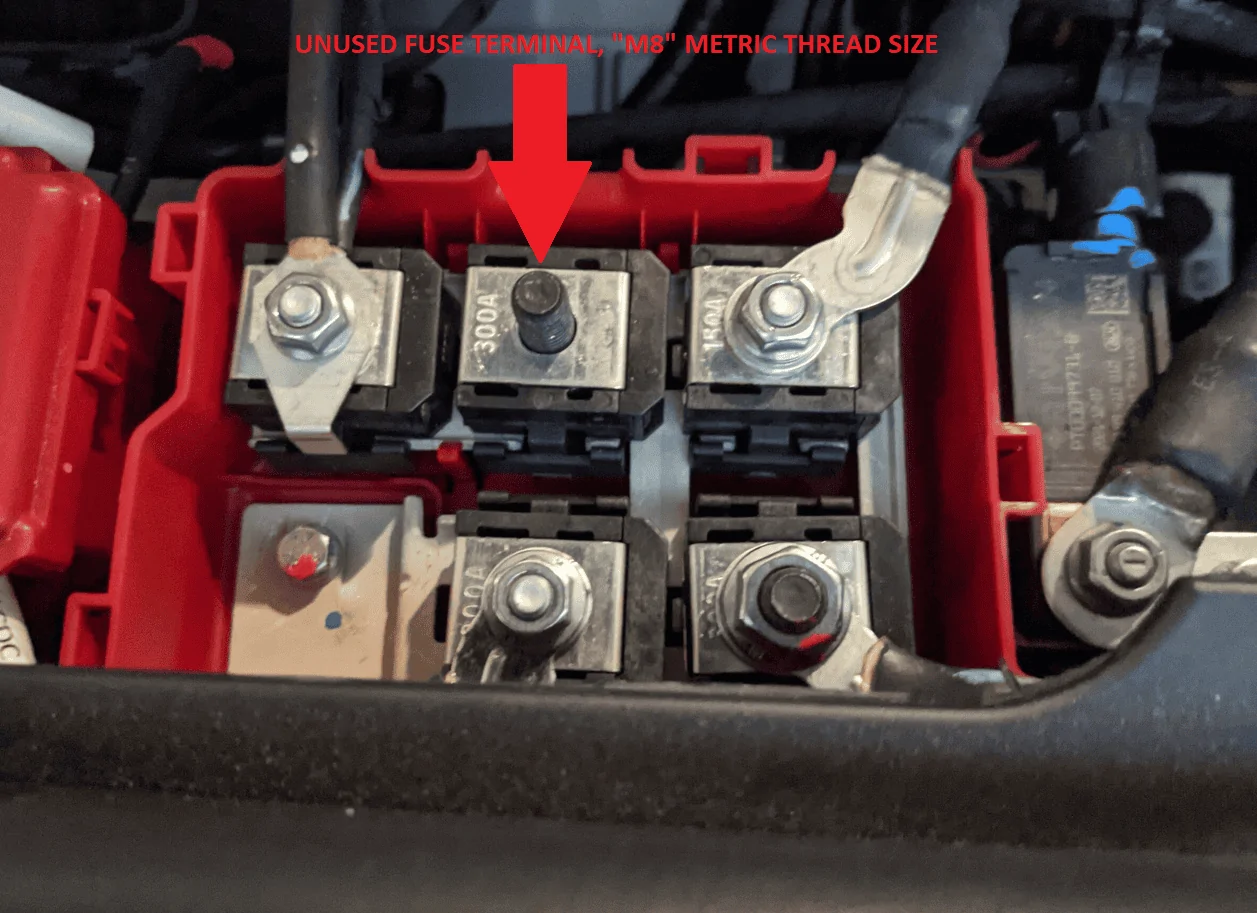

For @CO-rayman....
If you pop the lid off the red fuse/connection terminal covers in the top photo, you'll see each battery has one unused 300 amp fuse terminal stud inside. That's where I connected the positive leads for the primary and secondary batt charger, it takes an M8 size metric nut. I used the negative lead post on each battery for the negative charger leads. If you hold the negative leads down tight on to the post when you remove the nut to install the charger ring terminal the vehicle won't throw any codes because the 12V batts stay connected during the procedure. Mine didn't throw any codes when I started it after the install.
I'm not comfortable hiding a non-factory 120VAC device under the frunk.
I'd like to be able to check on it from time to time, and just in case it "forgets" my particular settings (maintain/charge flooded lead/acid battery) and I need to reset it, having it in the frunk makes it easily accessible. When I first plugged it in fresh out of the factory box, it defaulted to the "off" state, you then had to choose the function/battery type, it then started charging. Now it starts charging my batts whenever I plug it in (I tested it half a dozen times to be sure), but I'm worried on day it will "forget" and revert to factory OOB default of "off" which means I'd have to pull the frunk tub just to start it charging again.

For @CO-rayman....
looks like you have dual 12V batteries. did you hook it up to both? (passenger side has a negative terminal).
i'll post pics of my single 12V setup in a few days. it was a lot easier. since it was just one 12V and i used the 8mm bolt on the bottom left most for my 800ma tender. it's been 4 days with 1% loss in range which is insanely good. my car is still waking up whenever i walk into the garage (i hear it clicking and beeping), but at least the car has stopped waking up to charge the 12V!

For @CO-rayman....
Thank you!
I guess my only remaining question is whether we can just trickle charge one of the batteries and have the other second one charge too.
First, for jump starting using the leads in the hitch area (mentioned in the manual), only one pair of cables is provided. Second, when switching to Lithium batteries, Ohmmu instructional video mentions that if you replace one battery at a time, the car won't need a full reset.
So, I am wondering if the two batteries are somehow linked anyways and we could just trickle charge one battery and effectively trickle charge the remaining one too.
