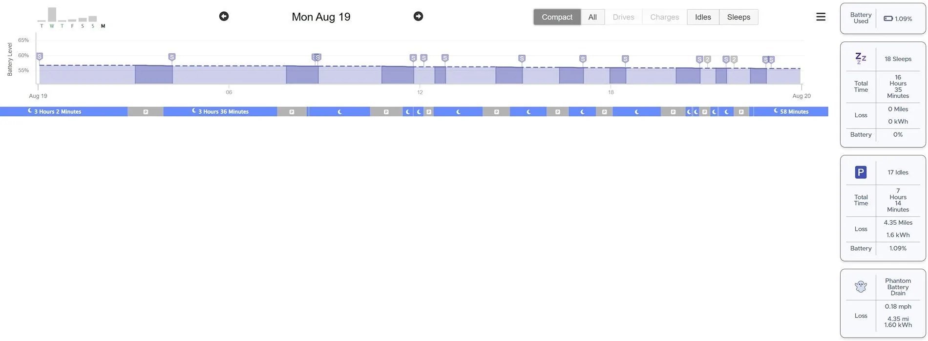

FWIW here's some baseline data, 24 hours of my R1T PDM Max unplugged at a moderate SOC, no gear guard or proximity locking and of course no driving, and a very typical 1.60kwh gone like the wind:

2-week update
8/16/2024 to 8/23/2024
0% loss from the high voltage battery
SOC remains at 68%
Cumulative over 14 Days: 8/9/2024 to 8/23/2024
1% loss
69% to 68% SOC
I mixed up my calendar. I'll be back on island in a week, so this will be a 3-week experiment.
I know we still need to see some draw from the battery tender, but looking at my smart meter readings I don't think much is happening. Car is sleeping every time I glance at it in the app and the app seems to update once a day.
I'm calling this a win.
