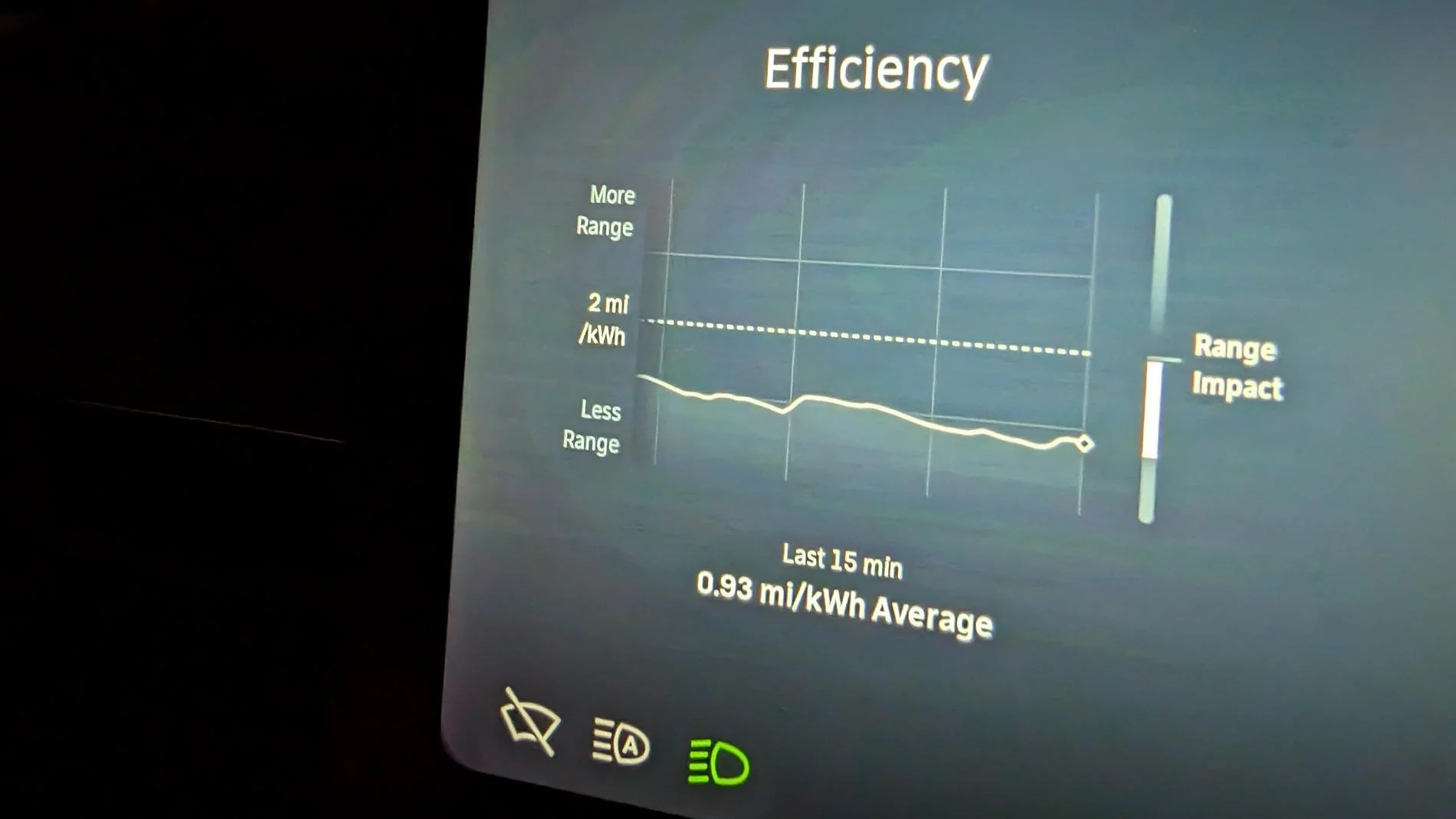

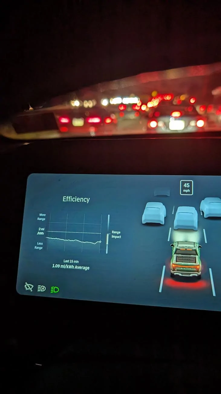

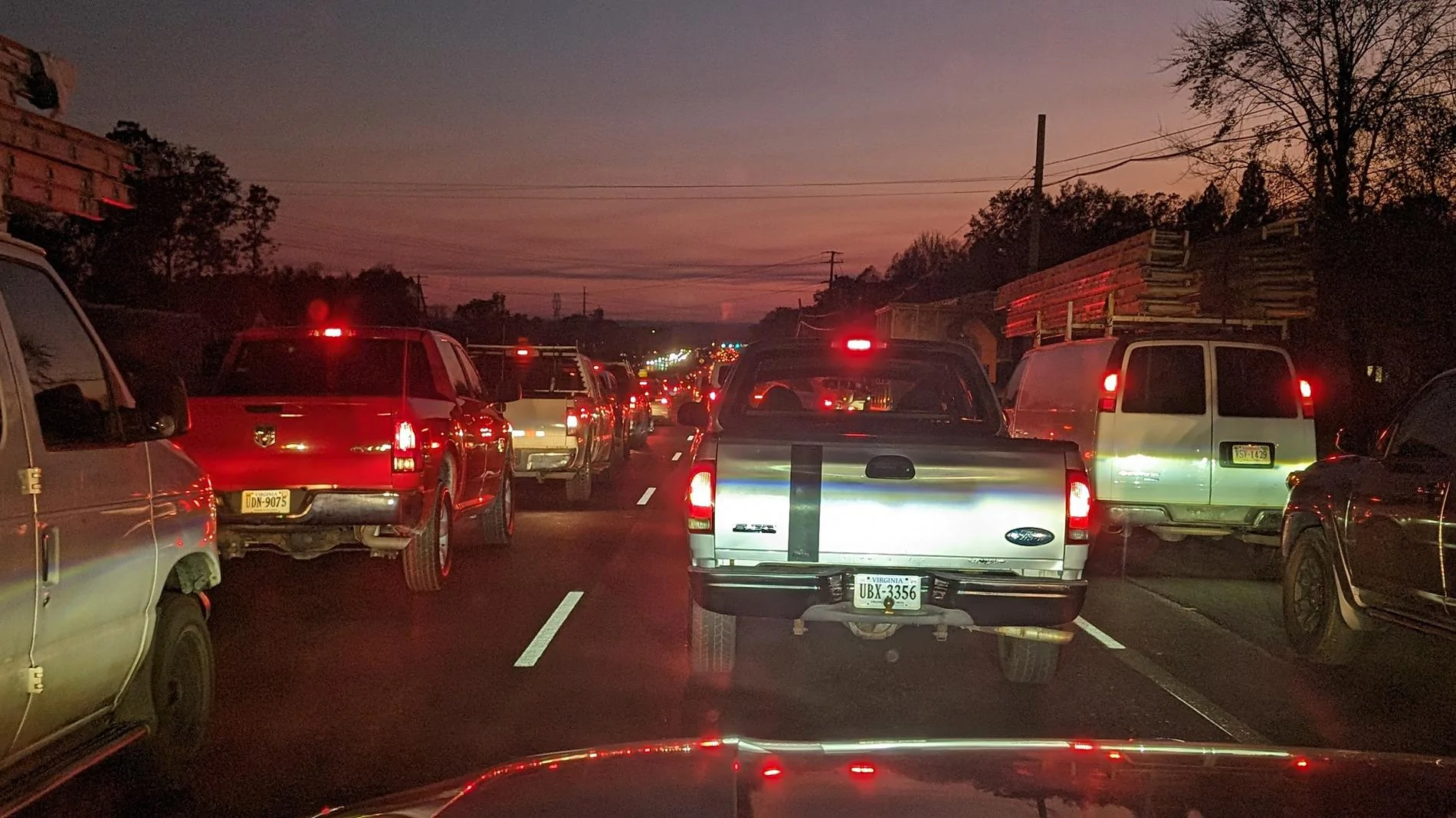

I've never seen lower than 1.8 on mine
Haha. Just sharing again because I had the pictures handy. You guys must not spend a lot of time in traffic. An example of a typical road near my house. It'll hit 1.0 and keep dropping, if I sit long enough. ??
Rivian R1T R1S Gen 2 R1S battery expectations 1733977047287-n7
Rivian R1T R1S Gen 2 R1S battery expectations 1733977059598-xi
Rivian R1T R1S Gen 2 R1S battery expectations 1733977075701-tm
And again, I hate all of you who get to do fun things like go camping and off-roading while I sit in this hellscape of Northern Virginia traffic. ?
SoCal isn’t much better. Routinely take 45 minutes to cover 15 miles. Strange to think this, I miss the open roads during lockdown.
