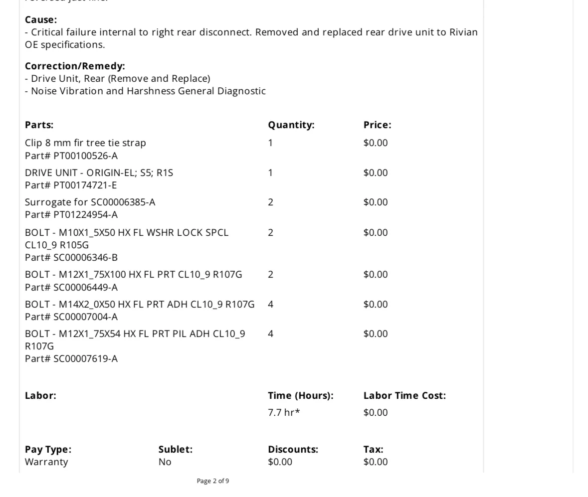

Well I experienced a loud clunk attempting to re-engage all-purpose from conserve on the highway once and a message that said it was unable to engage. So yes, there is software that decides or at least monitors and notifies you of the problem with engagement.
Yes, some of this is speculation...we are on a forum. Everyone is providing anecdotes. Hard to refute the example from @DKM_R1S though. The risk is worth the trade off of convenience for many people. Fine. The engineers may believe the risk is low and Rivian still has the option through software to always limit this if they start seeing too many cases.
It sounds more like an instance of a bad part:
the vehicle was 2 months old with less than 3K miles on it. It happened on the first road trip in the middle of Montana about 1/2 way into a 2,000 miles drive to the west coast.
I don’t recall seeing many (any?) other cases of a failure like this on here.
