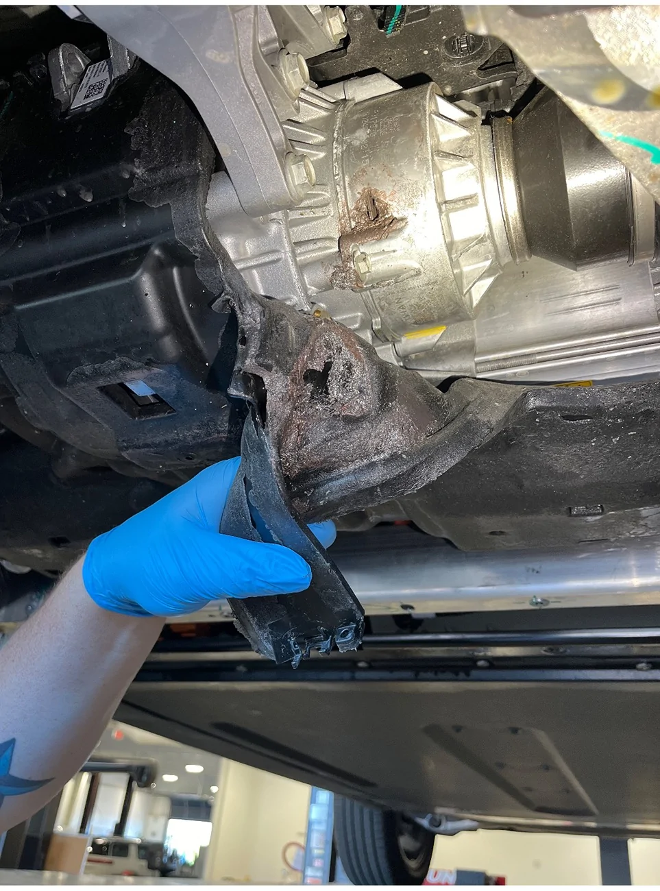

This is what can happen if the clutch fails to engage properly.
I'm glad someone has finally posted something like this.
Note to these people who keep saying they switch back and forth, in and out of conserve in their Gen 1 Quads while moving: There is risk of damage if you re-connect / switch to all-purpose from conserve if the vehicle is not at a stop. Maybe there's less risk if you maintain constant velocity and/or drive under 25mph according to the various reports of what some people were told by some Rivian employees. But there is still risk. Saying "it's fine" because you haven't had a problem yet doesn't mean you won't. I certainly hope no one develops an issue, and I wish Rivian just made this clarification in the drivers manual.

the vehicle was 2 months old with less than 3K miles on it. It happened on the first road trip in the middle of Montana about 1/2 way into a 2,000 miles drive to the west coast.

If Rivian was worried about us switching between modes while in motion, wouldn't they would have prevented it with the software? I'm afraid I often see the "Driver Assist not available above 85 MPH" message - that's purely a software limit. Software prevents us from changing drive modes while Driver Assist is engaged - I really believe they wouldn't let us change modes if there was concern about damaging something.
I suspect there was something else wrong with the motor shown above. I don't experience any clunks or other noticeable changes when switching modes at speed. I don't do it while accelerating - I typically get to my 12 MPH over the posted limit and then engage Conserve. I have, however, switched back to AP mode while slowing down if there's unexpected traffic.

Well I experienced a loud clunk attempting to re-engage all-purpose from conserve on the highway once and a message that said it was unable to engage. So yes, there is software that decides or at least monitors and notifies you of the problem with engagement.
Yes, some of this is speculation...we are on a forum. Everyone is providing anecdotes. Hard to refute the example from @DKM_R1S though. The risk is worth the trade off of convenience for many people. Fine. The engineers may believe the risk is low and Rivian still has the option through software to always limit this if they start seeing too many cases.
