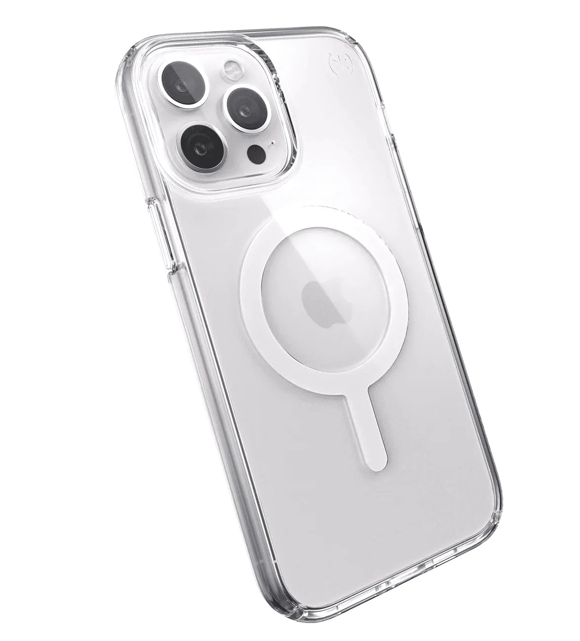

Wanted to love it, but it would not stay put for me on a 25 mph trip. Was sliding and not keeping connected. Unfortunately, sending it back.
Edited for clarity: The whole charger pad moves, without a phone on it.
twraps
twraps
Iliya
May 18, 2022
920
1,476
Concord
twraps.com
Wanted to love it, but it would not stay put for me on a 25 mph trip. Was sliding and not keeping connected. Unfortunetly, sending it back.
You need a MagSafe case. This is a MagSafe charger, without a MagSafe case the phone won't hold and will slide. MagSafe cases are available for most phones nowadays. A proper MagSafe case is the kind that has a magnetic ring on the back.
