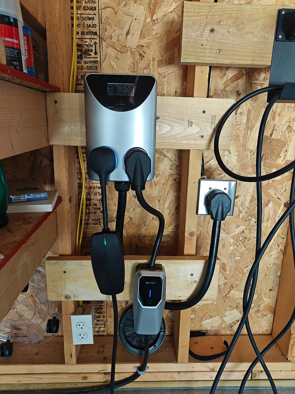

I have a 50amp dedicated circuit for the charger. We actually have two chargers and I am using a Lectron NEMA splitter. The 50amp circuit and the 32amp L2 chargers are more than ample to keep both the Rivian and the Tesla appropriately charged.
Rivian R1T R1S Got Electrician - What do I need to know? IMG20251002131720
