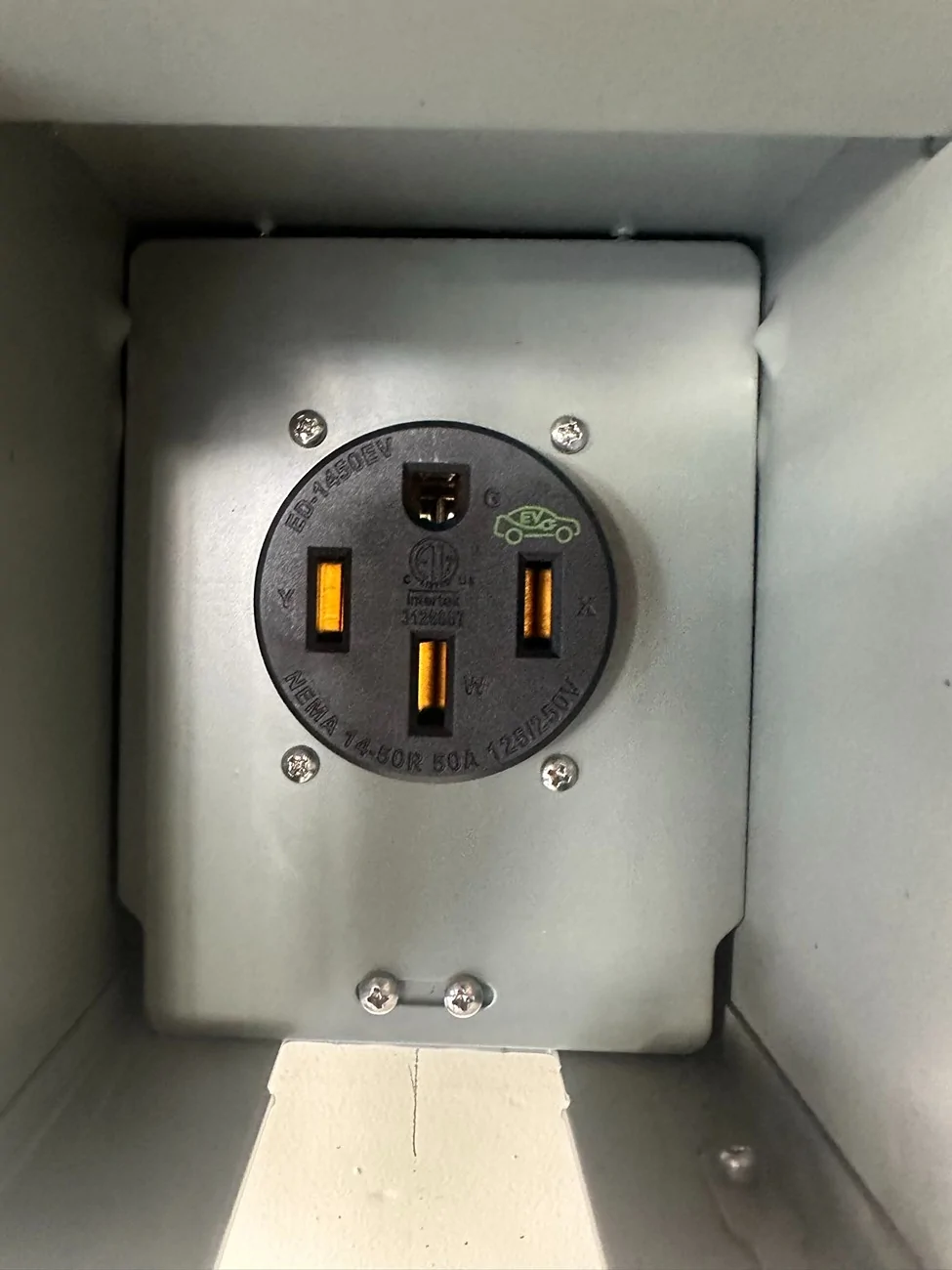

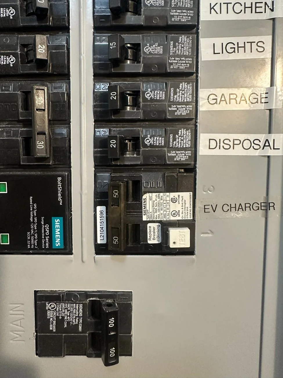

Excellent! I got room and was told about $4K for a new panel. As a renter, hell no. So, I’m going to do as you all recommended.
Hubbell 9450a
Metal conduit
6 ga THHN
50amp (I’m fine with 9.6)
$525 - I provide outlet & breakers
That's the most reasonable way to go. Your code area may mandate a GFCI breaker for that outlet. You should consider looking for one that matches the panel. Two panel spaces will be needed for that otherwise the electrician will need some duplex or quad Plex replacements as well to make space. You'll need a deep outlet box that fits the 14-50; either a retrofit or surface mount. Several companies are making ev considered receptacles now as well.

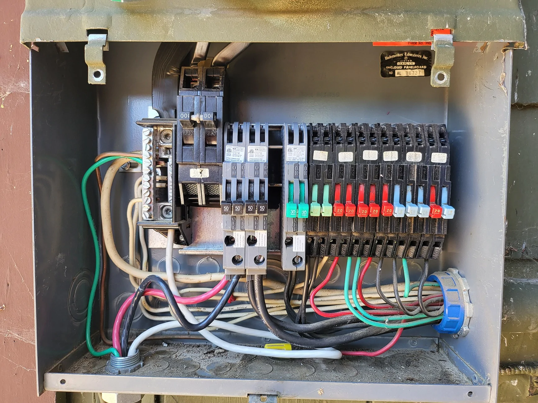

I build stuff
use metal conduit
When I did mine, I didn't use conduit / armored cable. Granted, my install is only this far away from the garage sub-panel:
Rivian R1T R1S Got Electrician - What do I need to know? 1766522272249-o5
But now you've got me wanting to pull my wall board down and add it, LOL.
One of these days! 😆
