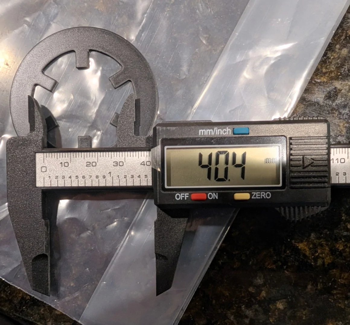

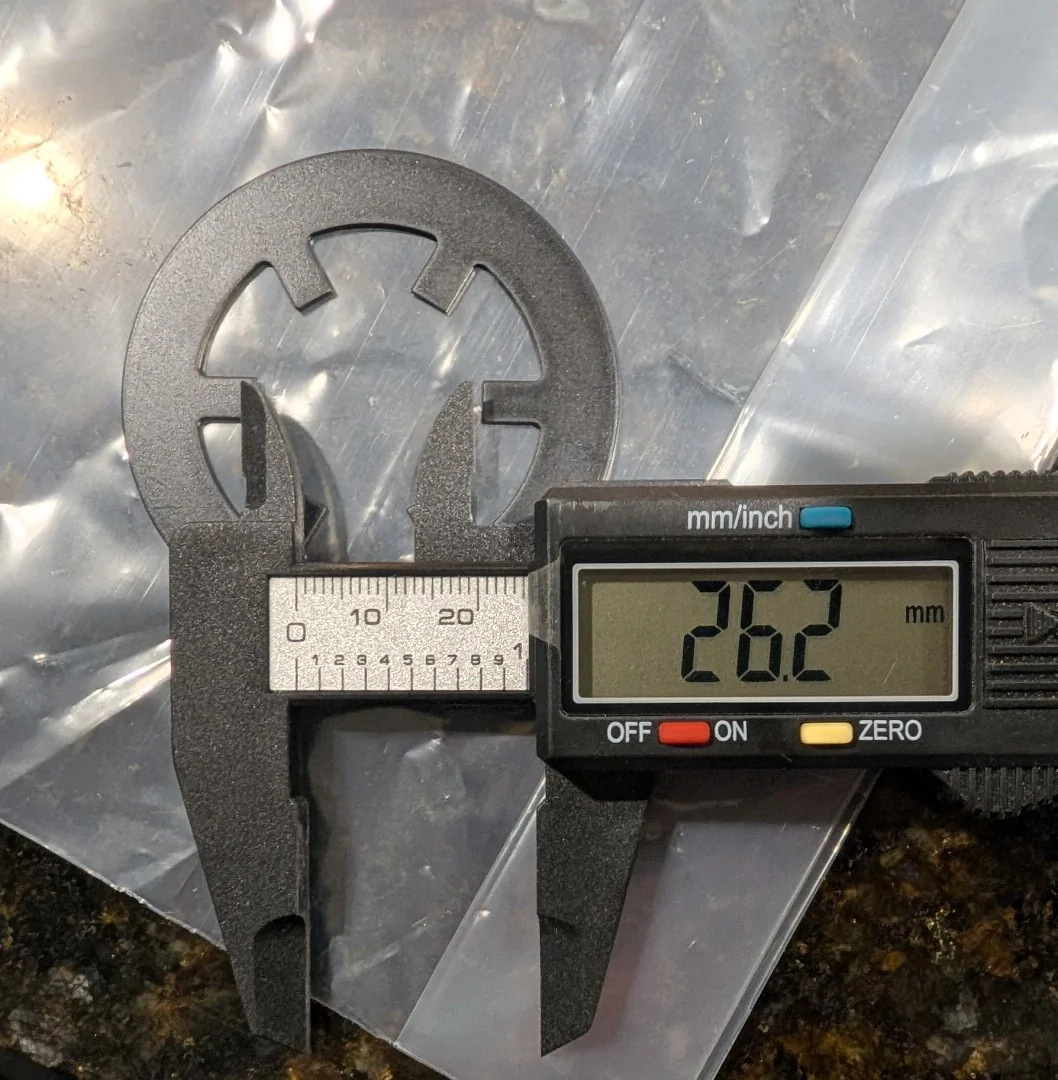

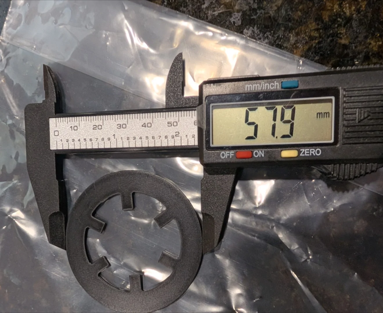

Was this document I think for that. Probably a piece of PVC with the right ID would do.
That's the doc! And a great idea, I expect forum wide deployment of PVC based DIY ting washer presses by Sunday evening.
Rivian R1T R1S Half-Shaft issue thread 1000005977
But seriously, I might bring one to Lowe's and see what I can craft!

I'd say you want a sleeve that is slightly larger than the stub shaft to allow the locking tines on the washer to bend as it is pushed on. Chamfering the inside of the "tool" surface might help. Without the Rivian tool you can't prebend the tines.
Nixapatfan
Aug 23, 2024
605
1,229
Massachusetts
Put some measurements up for the ting washer I'm sure someone can model it for 3d printing. Just need a tube and cone. I might be able to but short on time at the moment.so not sure I can get done quickly.
Y'all are way smarter than me. Standby!
I also have access to a 3D printer and smart shipmates who make cool stuff for training aids. I'll see if the can whip it up too. I know if I had access to a real tool, they could scan and clone it.
These bad boys are real stiff... I'm not sure 3D printed, or even PVC, would be able to press/bend them.

So that'll be a piece of 2-2.25" steel Pipe to hammer those on and hope they go on straight and flush.
Maybe putting the edge in a vice, bending a tine slightly, rotating in the vice and repeat.
I'm guessing the tines get wedged between the CV and the hub. Then the cap screw sandwiches it all so the parts can't move independently and squeak.
Yeah 3d print won't work if they are thick. Maybe a long 40mm socket and a 30mm ball bearing to prebend the tines, the halfshaft spline is 35mm.

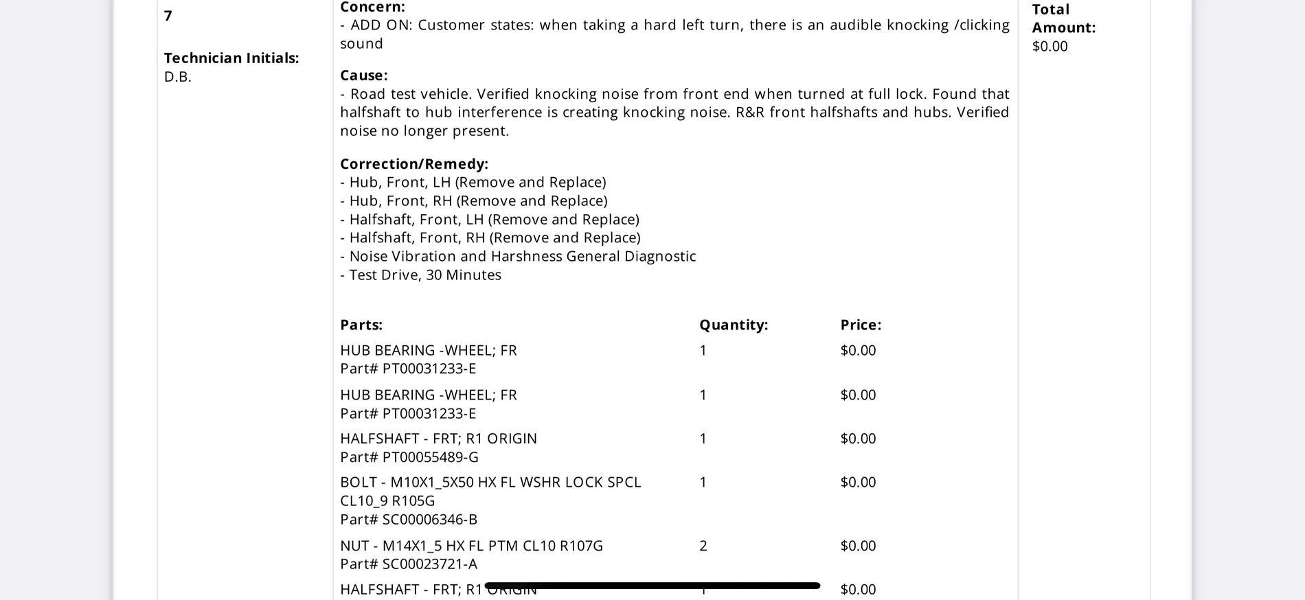

I have not read many of these pages. But I just had my half-shafts replaced after noticing “the sound” when slowly doing a turn, usually to my left, kinda like a U-turn.
23 G1 QT
