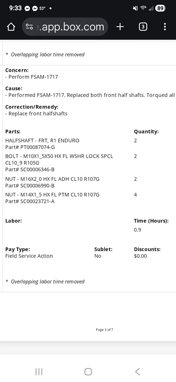

Took my Gen 2
Rivian R1T R1S Half-Shaft issue thread 1000014924
R1T in for headlight recall and the SC replaced my front half shafts

Took my Gen 2
interesting how your Dual Motor half shafts got replaced with the Enduro G where others including myself last month have gotten the Enduro F. There was a mention that the G was for Quad's but perhaps not

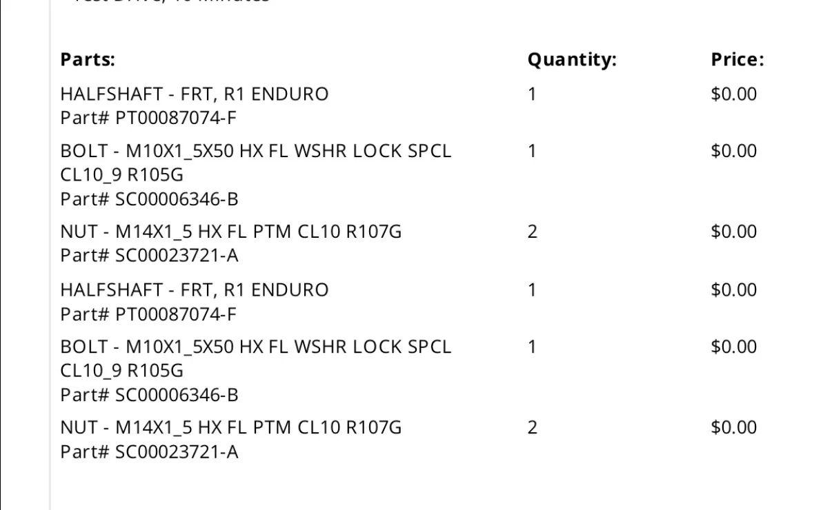

I got the F revision on Sept 18th. So those are faulty and now being replaced with G?
PT00087074-F are my Sept 18th installed Enduro front half-shafts.
