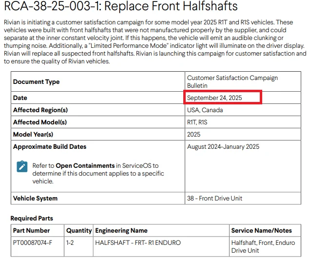

interesting how your Dual Motor half shafts got replaced with the Enduro G where others including myself last month have gotten the Enduro F. There was a mention that the G was for Quad's but perhaps not
Quads are not under recall, and are a different part number.

I got the F revision on Sept 18th. So those are faulty and now being replaced with G?
PT00087074-F are my Sept 18th installed Enduro front half-shafts.
My truck was in the SC on October 10 and received the Gs...

Had the half-shafts replaced with the defective parts on Sept 18th. The (F) is now replaced with the (G). They came out with this notice like a week after I had my replacement done.
I have the (F)
I might just drive on these until they start wearing out or making any noise. Maybe pull the trigger at 59,999 miles.

Seems strange how some get the G yet the recall says to use the F. I think my originals from 2023 were C. I’m quite pleased with the fix and we’ll see if it holds out. Service told me it’s under the 8yr drivetrain warranty so I have time
I have the dual.
I have the (F)
does the notice not say that the Required Part is the F? Not sure where this G part is coming from
I think the "required part" is the part that has to be replaced. The replacement part is not mentioned.
