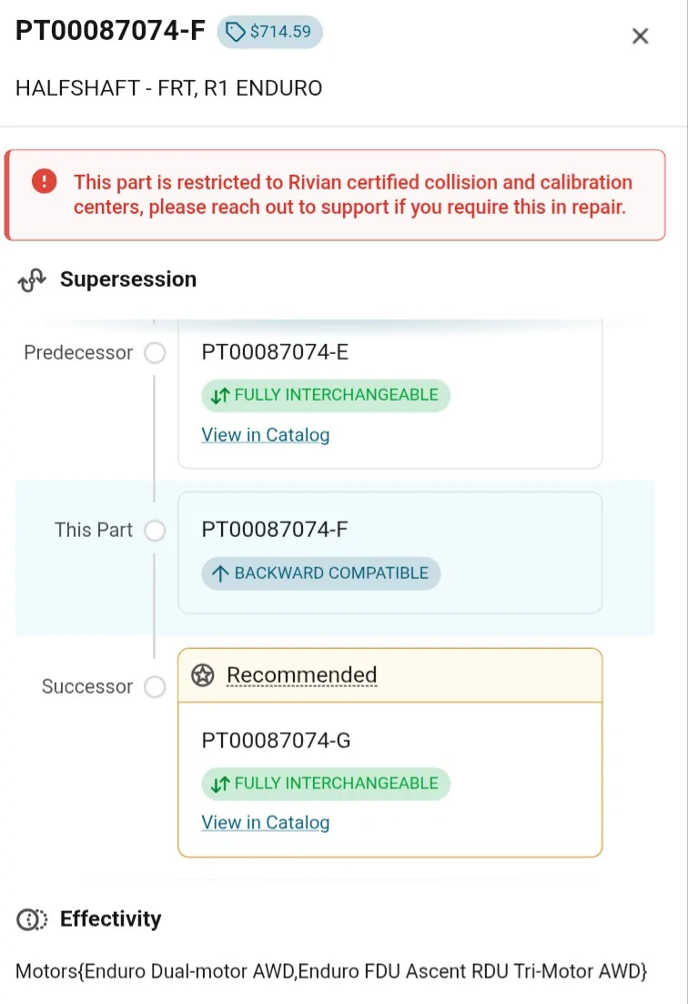

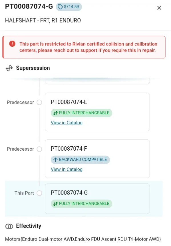

(F) is Dual Motor front half-shafts. (G) is the Quad motor half-shafts.
You have to look at the whole part number, the variant is the ending letter. In this case, the newest variant is G for Enduro (in house dual motor).

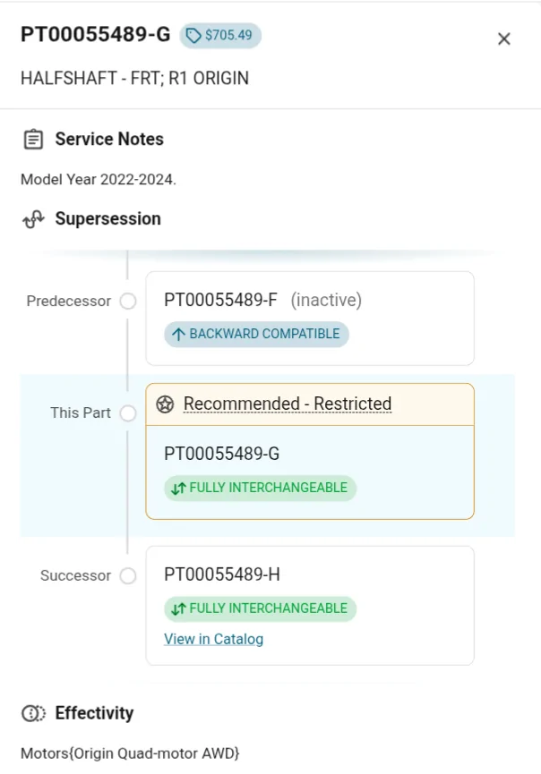

The Bosch quad did have a G, but they're now on H. Also, completely different part number.

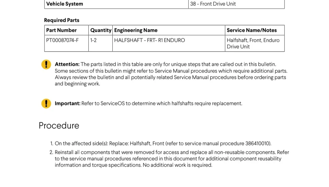

So the (F) I had installed 2 weeks ago is the part that's being replaced?
The "required parts" is the outgoing part. I read that backwards.
I also had the “F” installed a few weeks back in my 2023 R1T. The “F” is the most recent half shaft that the recalled vehicles will get updated too from what I can see in the notice
Does H stand for Hardened?

Please post screenshots of your work orders showing the exact full part number... Folks are focusing too much on the revision and not enough on the full part number.
