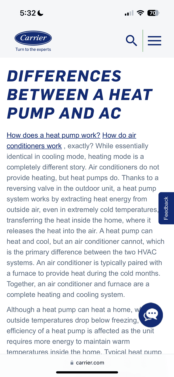

Air conditioners also transfer heat from inside to outside by the exact same process as a heat pump. If an air conditioner did not transfer heat from the cabin to the outside then what do you understand to be cooling the cabin?
Regarding efficiency, if both systems use the same compressor, refrigerant, insulation, and heat exchangers (a.k.a. radiators or coils) then my understanding is any difference in cooling efficiency is too small to make a difference either way. So if a heat pump is trying to cool the inside by pumping heat to the outside there is no significant efficiency gain compared to an AC system doing the same thing with the same components.
I think you're arguing with a bot that doesn't actually understand how a heat pump works.
For some reason they are arguing a heat pump is better at cabin cooling because it can also heat the cabin.

Agree with this based on engineering experience and personal experience with heat pumps in another car. Helpful but not magic.
There are some wacky posts on this thread about how heat pumps cool the cabin vs air conditioners. The reality is, they are the same in cooling mode.

I atleast am not saying that at all. Maybe I need to read stuff up again but in my mind, an air conditioner cools but letting compressed air rapidly expand - similar to how a can of compressed air chills; similar to a refrigerator. of course the AC still “pumps” the air out from the room/car but it’s mainly for circulation. This is compared to a heat pump that moves hotter air out, over a mechanism to exchange the heat, cooling it down and finally circulating it back in.
just how I understand it until this point.

Like others have echoed, no innate cooling advantage from a heat pump, unless the compressor itself is more efficient than the older unit. The main advantage is the ability to run in reverse and provide efficient transfer of heat vs inefficient resistive heating.

Here's the real deal: While heat pumps and traditional air conditioners operate on similar principles for cooling, heat pumps offer significant advantages. They're typically optimized with more efficient compressors and advanced refrigerant management.
Heat pumps also integrate with a vehicle's thermal systems, using waste heat from the battery and drivetrain to enhance overall efficiency—something traditional AC systems can't do. This leads to better energy use and extended range in EVs.
Plus, the refreshed Rivian R1S includes both a heat pump and an AC compressor, ensuring it can handle heating and cooling efficiently.

Vehicles with heat pumps have likely had more engineering done with regard to overall HVAC efficiency, and that's where the big difference lies. Being more efficient to redistribute the heat that's already in the system can make a big impact.
