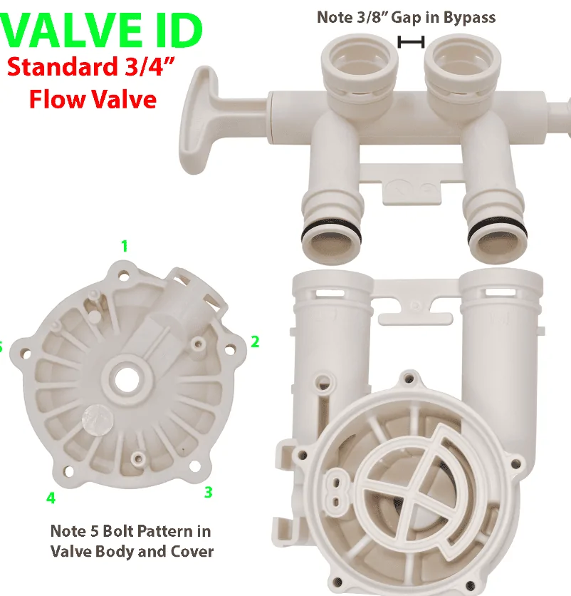

Yes, the octovalve has 8 ports with 5 positions. It's a creative solution to solving a problem, but it's far from magic. If someone has a water softener in their home, you have a rotary valve that conceptually works just like the octovalve.
Yeah, yeah, and if you have a lighter and flatulate you also have a rocket engine that conceptually works like Merlin. Don't act like Elon didn't revolutionize the world.
