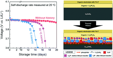

The most recent actual scientific journal article I've been able to find is from 2018 saying 5% per month
The article you link does not appear to say what think it says.
First let's look at the title:
Abnormal self-discharge in lithium-ion batteries
Based on the title alone it's safe to say we're studying cases where batteries have abnormally high self discharge. But let's read on:
Besides their promising electrochemical performance, the low self-discharge rate (<5% of the stored capacity over 1 month) of lithium-ion batteries is one of their most significant advantages for ESSs.
Let's parse this: It's saying that li-ion batteries have a "low self discharge rate" and then it clarifies that "low" is anything less than 5%. So as someone else pointed out, that's the upper bound. Some types of batteries lose 30%/month so anything less than 5% is generally considered low in the battery world.
It goes on:
Herein, contrary to conventional belief, we report that the self-discharge of LIBs can be abnormally accelerated when the battery has been exposed even to a routine short-term thermal exposure. We demonstrate that this thermal ‘history’ in addition to the temperature itself is memorized in the battery and accelerates the self-discharge rate.
It sounds like it's saying that the batteries can be damaged by being exposed to high heat. That damage can lead to high self discharge rates. (IE: Greater than 5%)
They also provide a nice little graph to illustrate their point:
Rivian R1T R1S Hood Mounted Solar Panels? .ManuscriptID=C8EE00186C&imageInfo.ImageIdentifier
Look closely at that graph on the left. A battery that's been exposed to 60 degrees Celsius (140 F) in it's "history" will have a fairly high self discharge. Look closely at that scale: A battery "without history" of a thermal event will drop from 3.9v to somewhere around 3.88 or 3.89 after 20 days. That is an absolutely tiny drop in state of charge.

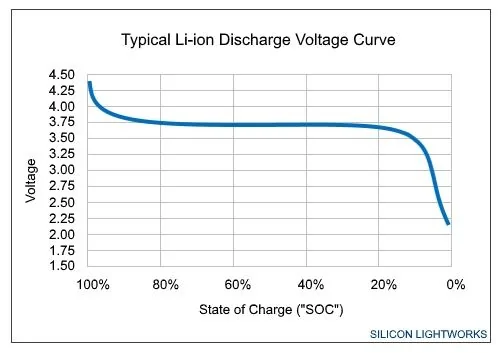

Let's look at a voltage curve for a typical li-ion cell:
Rivian R1T R1S Hood Mounted Solar Panels? li-ion-discharge-voltage-curve-typical-jpg
Notice how steep the curve is from the left? Dropping from 3.9 to 3.88 would probably not even move you along the Y axis enough to represent even 1% drop in SoC. And this is at a fairly high state of charge where self discharge is typically at it's greatest.
I have raw cells that I store around 50% SoC and I've never had one drop in voltage even after sitting for 10+ months on the shelf.
I can also send you some logs from my the BMS on one of my batteries if you like. :) From fully charged they have to drop around 0.3 volts before my BMS registers the drop as even 0.5% SoC. A drop of 0.02 is nothing.
