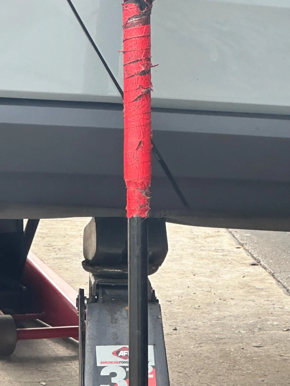

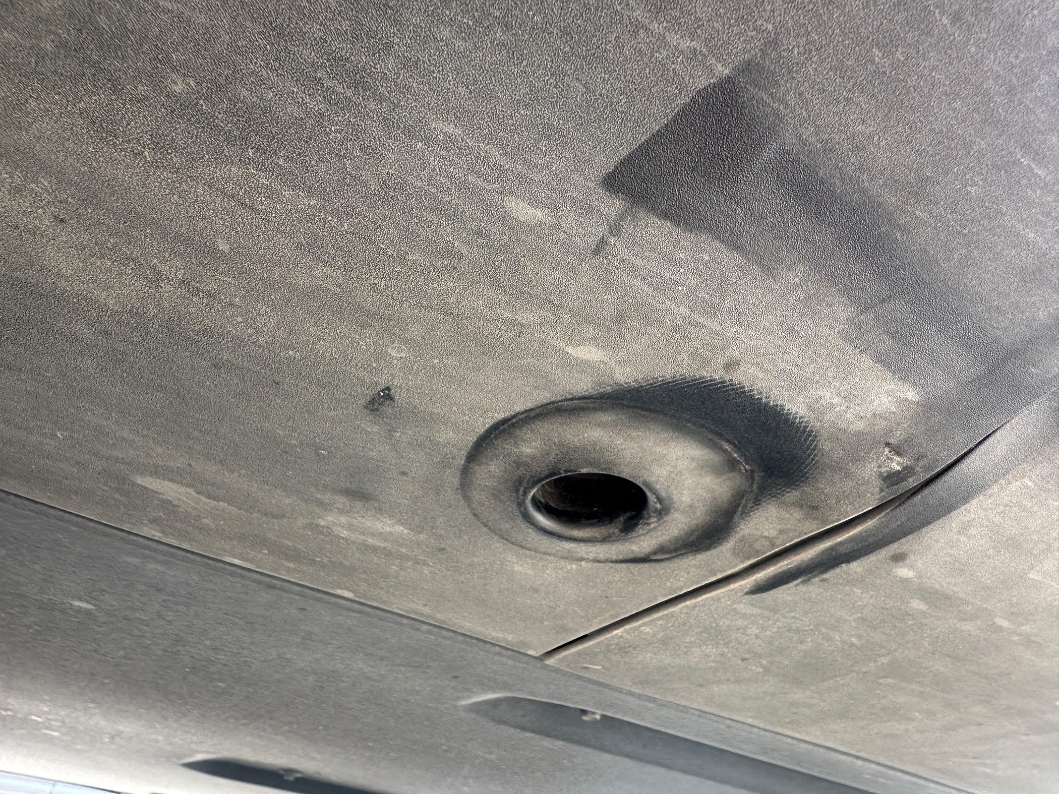

Just had a set of new wheels mounted @Discount Tire .
I told them I had brand new jack pucks in the rear if needed(previous time they used their own.) I noticed from a distance the Jack pucks they were using looked different and that one of the jacks looked to be tilted. They told me it was fine…
When they lowered it down I noticed they didn’t have to reinstall the caps for the pucks at which point I realized they jacked it up in the wrong location. The plastic panels are all warped and no longer sit flush with the bottom, but my main concern(without removing the panels) is could there be damage to anything else underneath those panels? They told me a manager would reach out to me shortly. I don’t want to remove the panels until he looks at it, would just be nice to hear there is no potential for other damage.
Thanks!

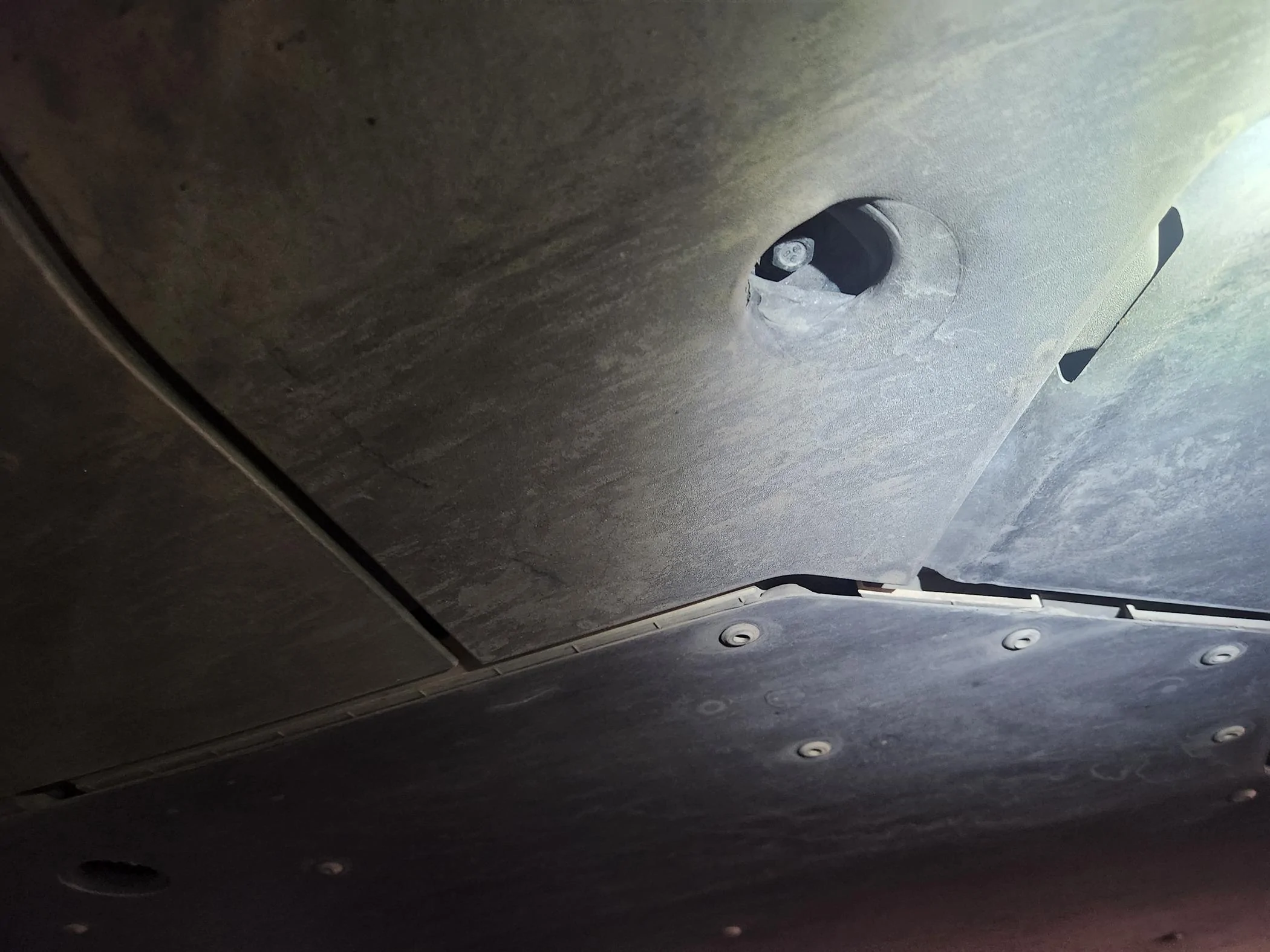

I'm happy to hear from you guys that it's likely only cosmetic, but I still expect them to replace the panels as they are no longer flat under the vehicle. I hate to be "that guy" complaining about stuff like this, but I have a shop myself(unfortunately without a tire machine) and if one of my guys pulled off something like this on a customers vehicle I would raise hell. The sad thing is it was more than one guy jacking the vehicle up....
If they decide to dismiss my concerns, is there an online source for OEM Rivian parts? I'm used to Jeeps etc where I can just call up my local wholesalers and get any parts I need.

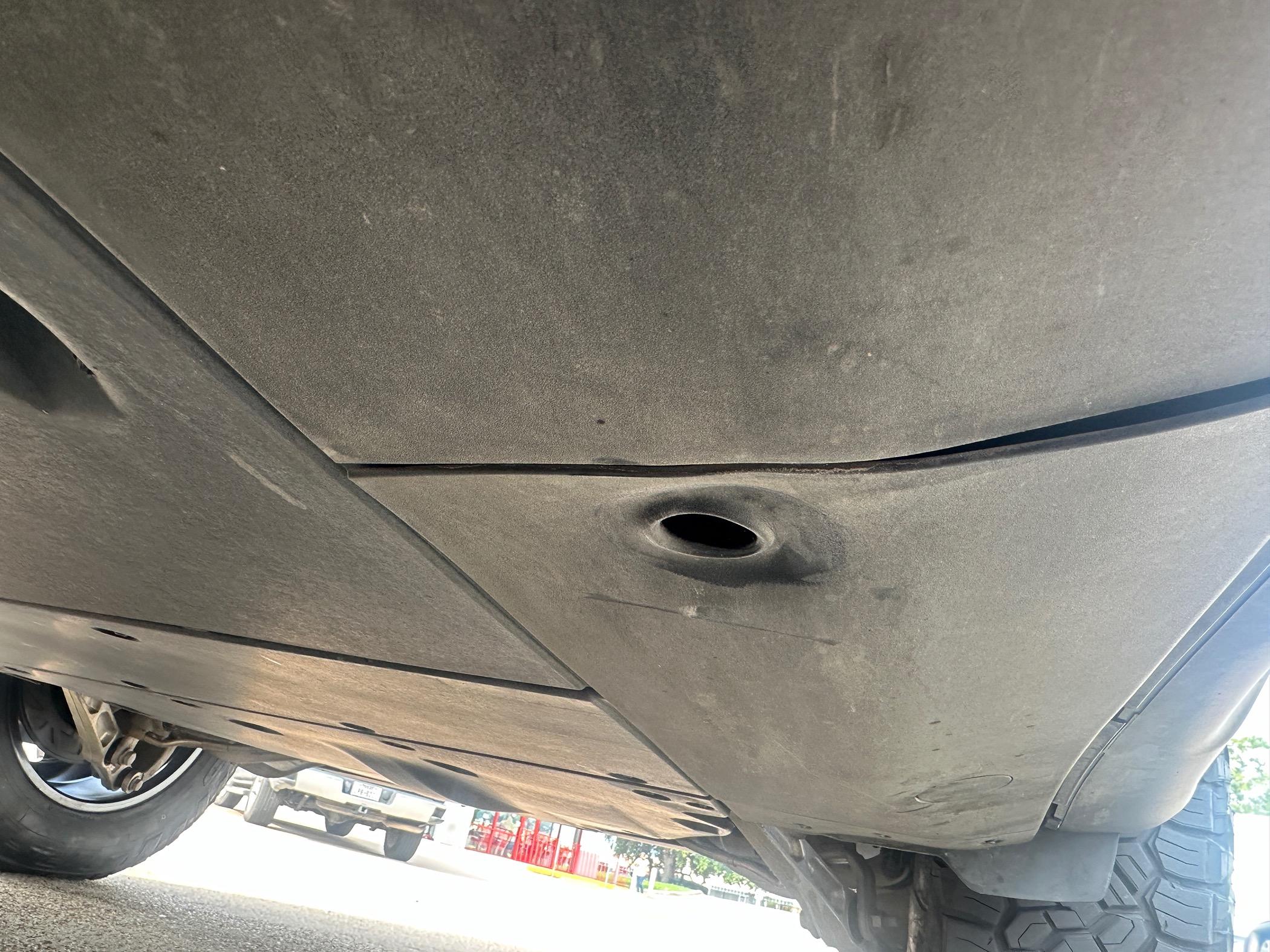

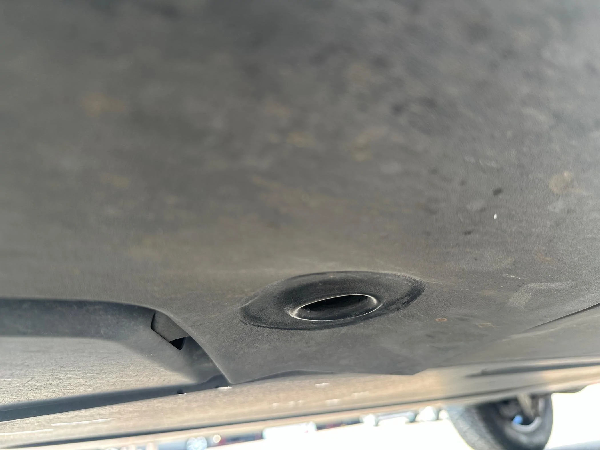

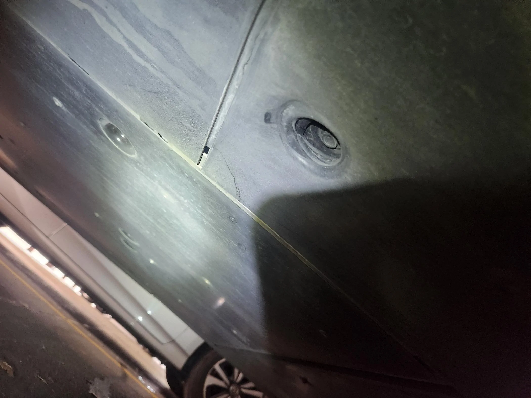

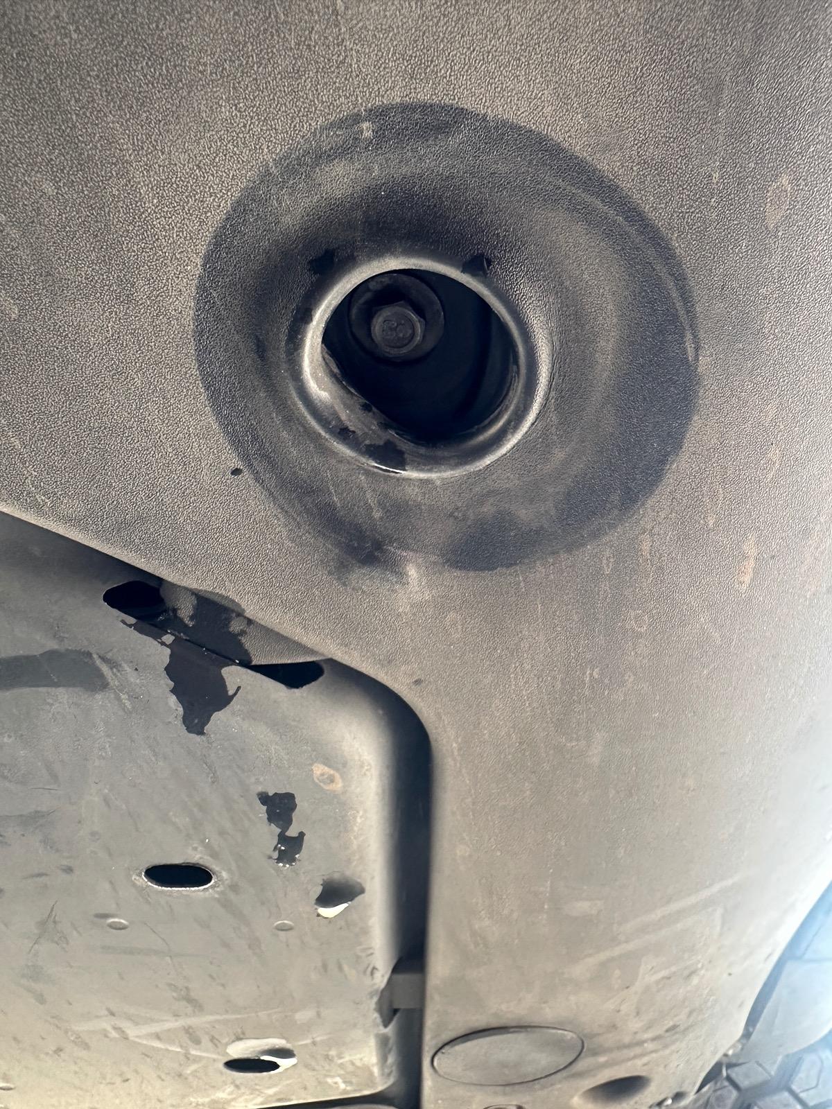

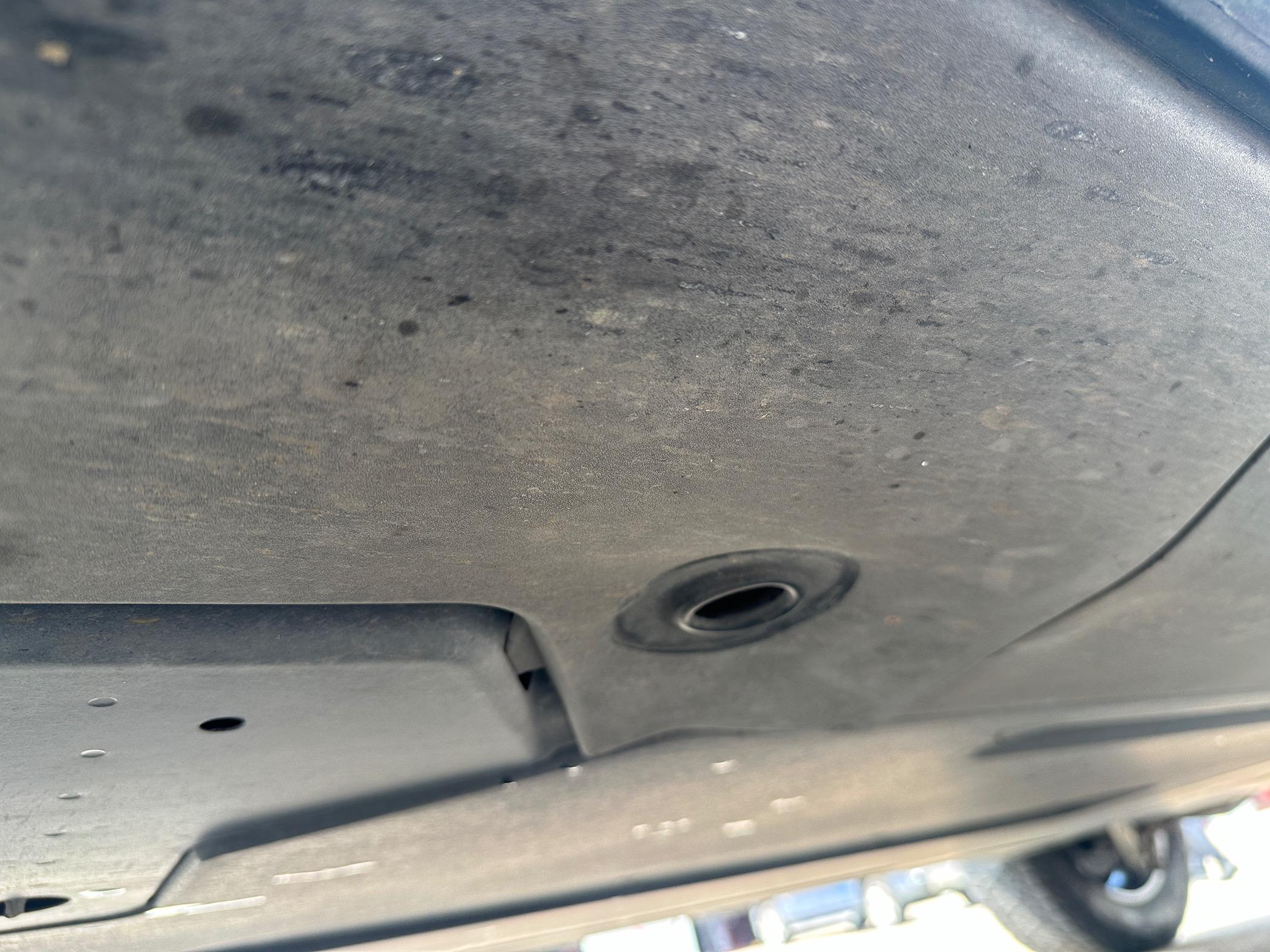

Your thread made me think to go outside and check my truck, because I just had a Discount Tire in San Antonio rotate my tires. Sure enough they did the same to mine:
Rivian R1T R1S How bad can this be? 20240522_134753
Rivian R1T R1S How bad can this be? 20240522_134709
The panels are even popped out a little bit from (I'm assuming) flexing when they put the jack in there.
I haven't been the most confident in this store, but thought I'd give them another chance. The first rotation they took over an hour longer than they quoted, and then never updated the text message thing or notified me so I sat there for an extra hour waiting on top of that. When I couldn't see the truck in the bay the guy joked it must have been stolen, but by that point I wasn't in the best mood haha.
I probably should've left when I noticed they were trying to jack the truck up while it was in kneel mode, and I really should've when they tried to change the wipers without activating that as well. @Discount Tire I thought y'all did training with Rivian or something? I get that its a truck, but I rather be the one who puts the dents and scratches on it instead of paying someone to do it.

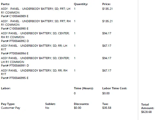

I was able to buy a full set of replacement side panels from my service center a while back. People on phone support didn't really want to work with me on it though so I think that's likely still the case.
I may be too new to the forum to PM you, but would you mind sending me this in higher quality(not sure if it compressed via the forum)? I'm curious if that is enough for them to reimburse me for the parts.
If not, I understand and thanks for the input.
PM sent.
