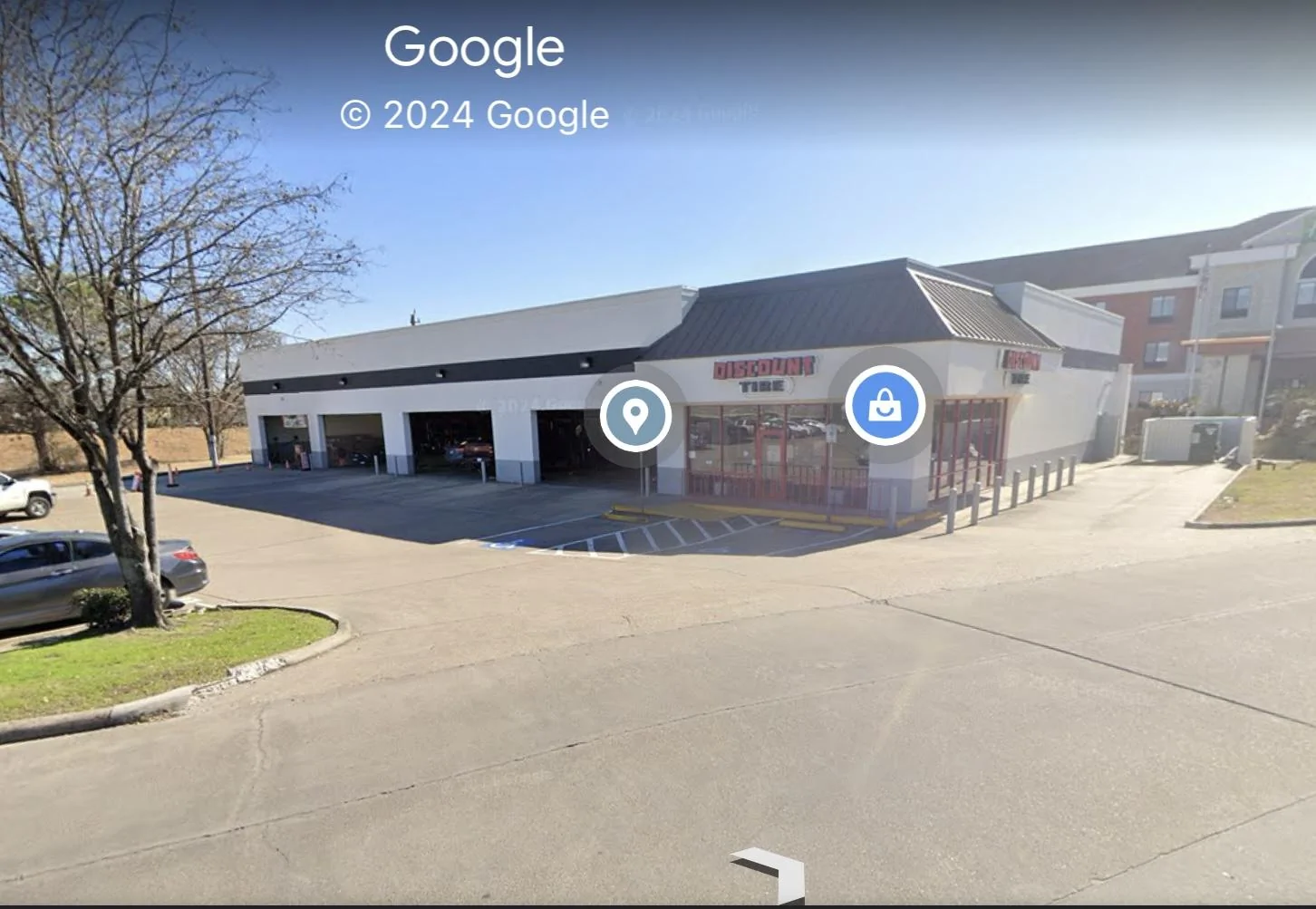

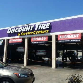

Are we sure this is the site sponsor Discount Tire and not the imposter Discount Tire that someone else went to and damaged their Rivian?
Real:

Imposter:

The building, receipt and employee attire all look legitimate to me.

I thought the same thing, but those are only in California. OP is in Texas.
That is the good one. The other lied to someone and told them they had the pucks and were “approved” by Rivian.

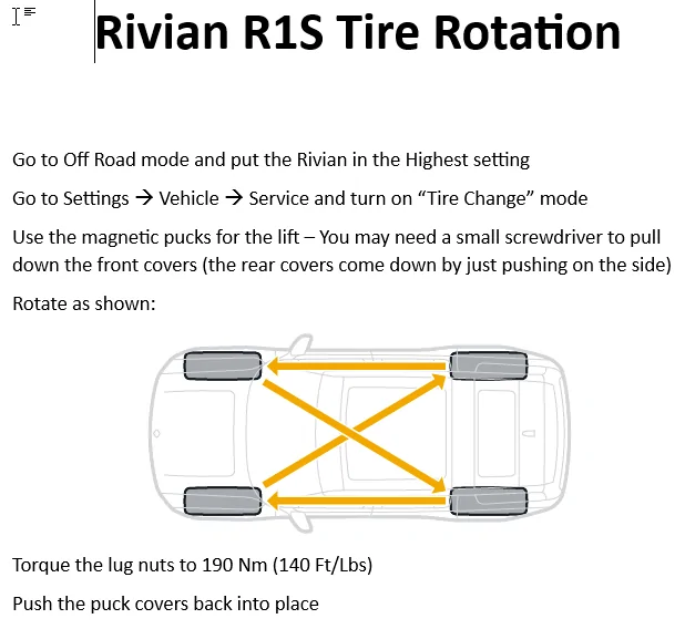

I have this document printed out and hand it to my local tire shop when I give them the fob:
Rivian R1T R1S How bad can this be? 1716386326199-h6
The magnetic pucks are mine and I leave them on the driver's seat when I park. The manager told me how much he appreciated the instructions because they don't get many Rivians. I figure with this they'd come and get me if they had any questions, but probably not if they were certain they were doing the right thing. The PDF is attached if anyone wants it.
