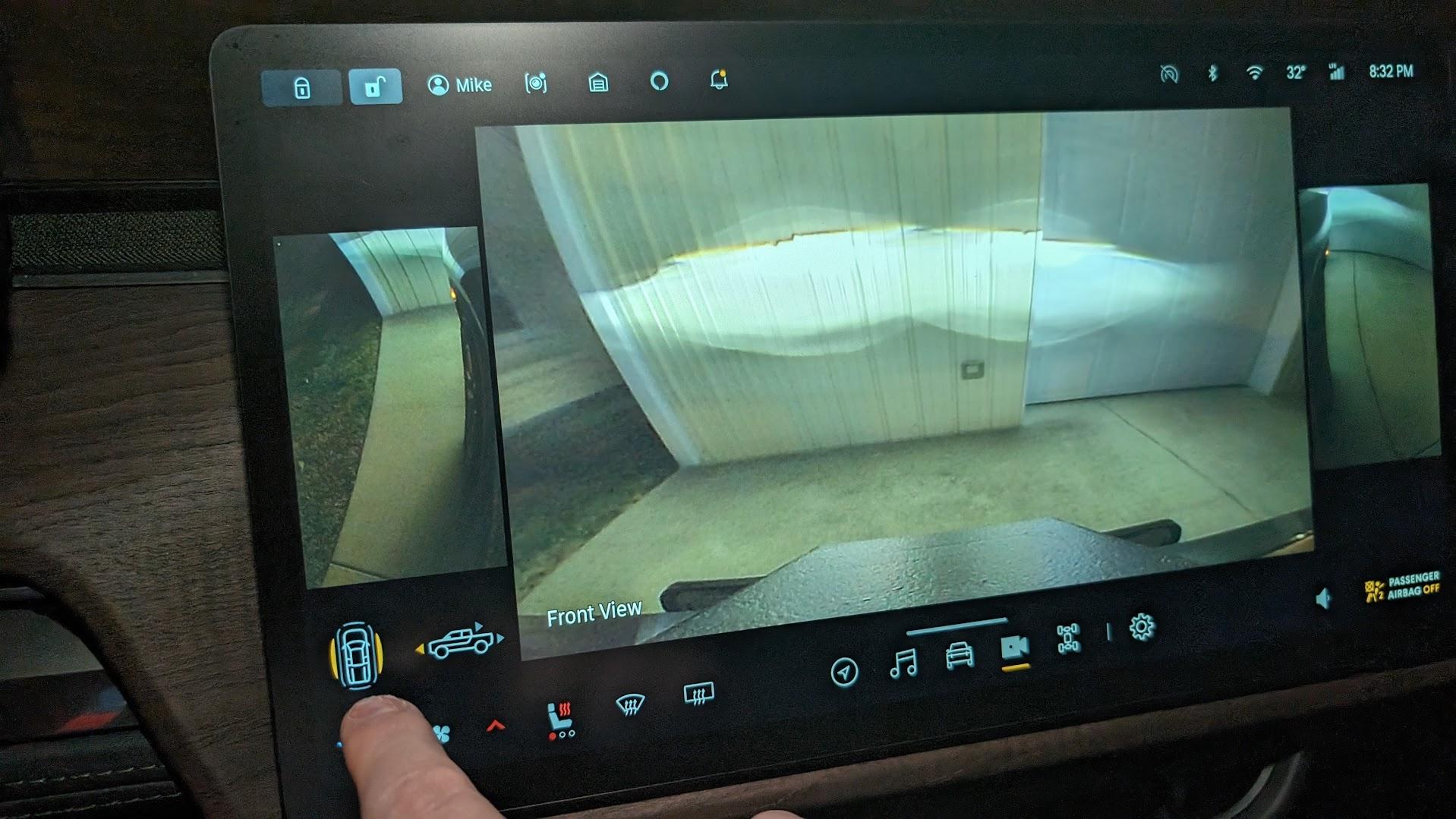

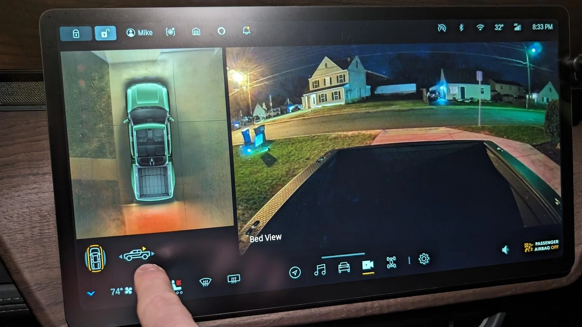

To add more info to this post:
360 + Front:
Rivian R1T R1S How to have front and rear cameras on while driving? 1703106985752
Side cameras + Front:
Rivian R1T R1S How to have front and rear cameras on while driving? 1703107006110
360 + Bed:
Rivian R1T R1S How to have front and rear cameras on while driving? 1703107023931

I would always encourage anyone to play around with the settings. They don't bite. ?
