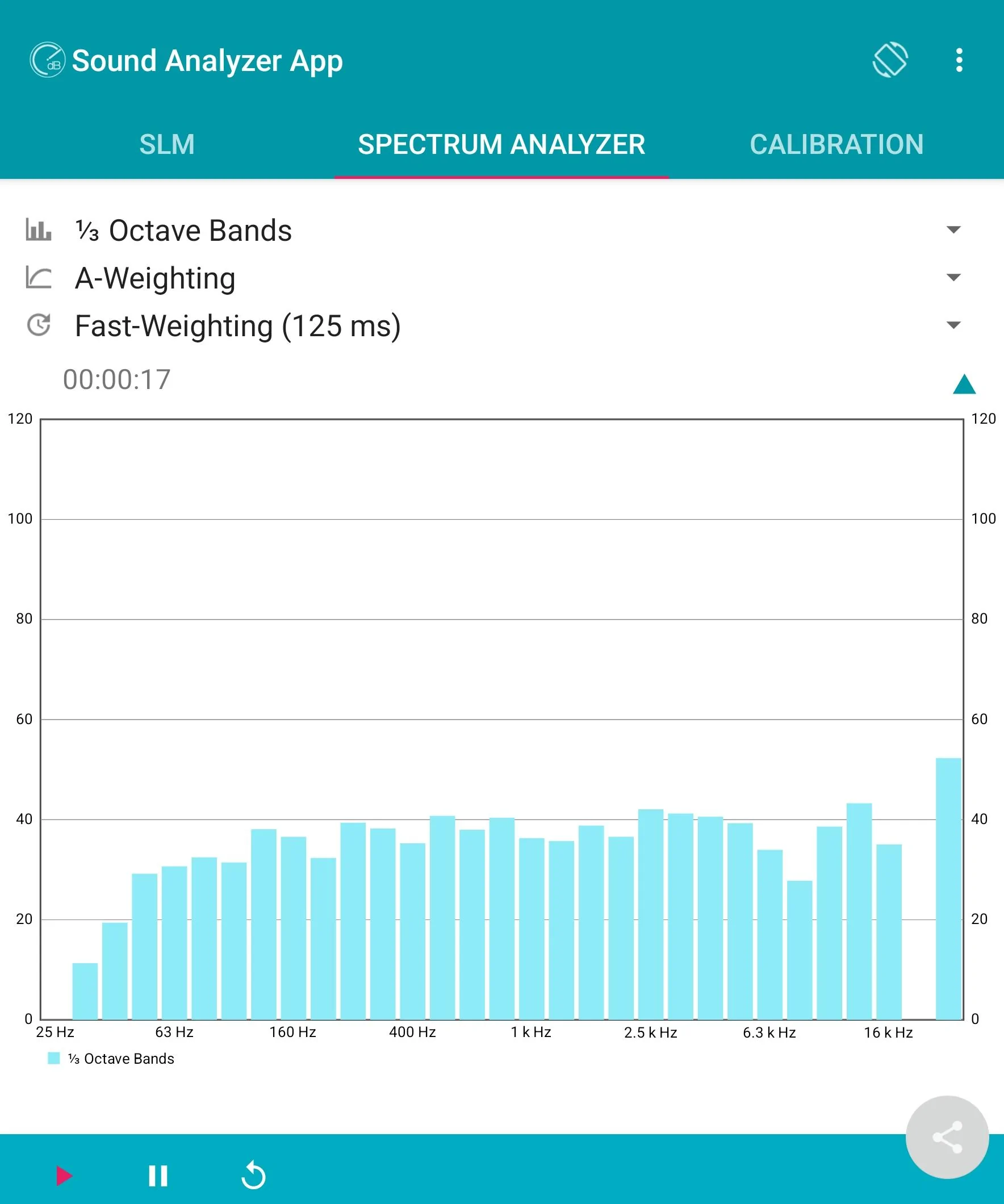

Thanks a bunch. It's sounds much better! I'm going to do this procedure on my other cars albeit more simplistic. I downloaded a pink noise generator on my phone that I stream over BT and then a sound analyzer app to see the results! Here's what your rivian settings resolve to in this app.
Rivian R1T R1S How to Improve a Rivian R1S’s Elevation Sound System With Simple EQ Changes (Equipment Measured Tests & Results) Screenshot_20240216_124718_Sound Analyzer A

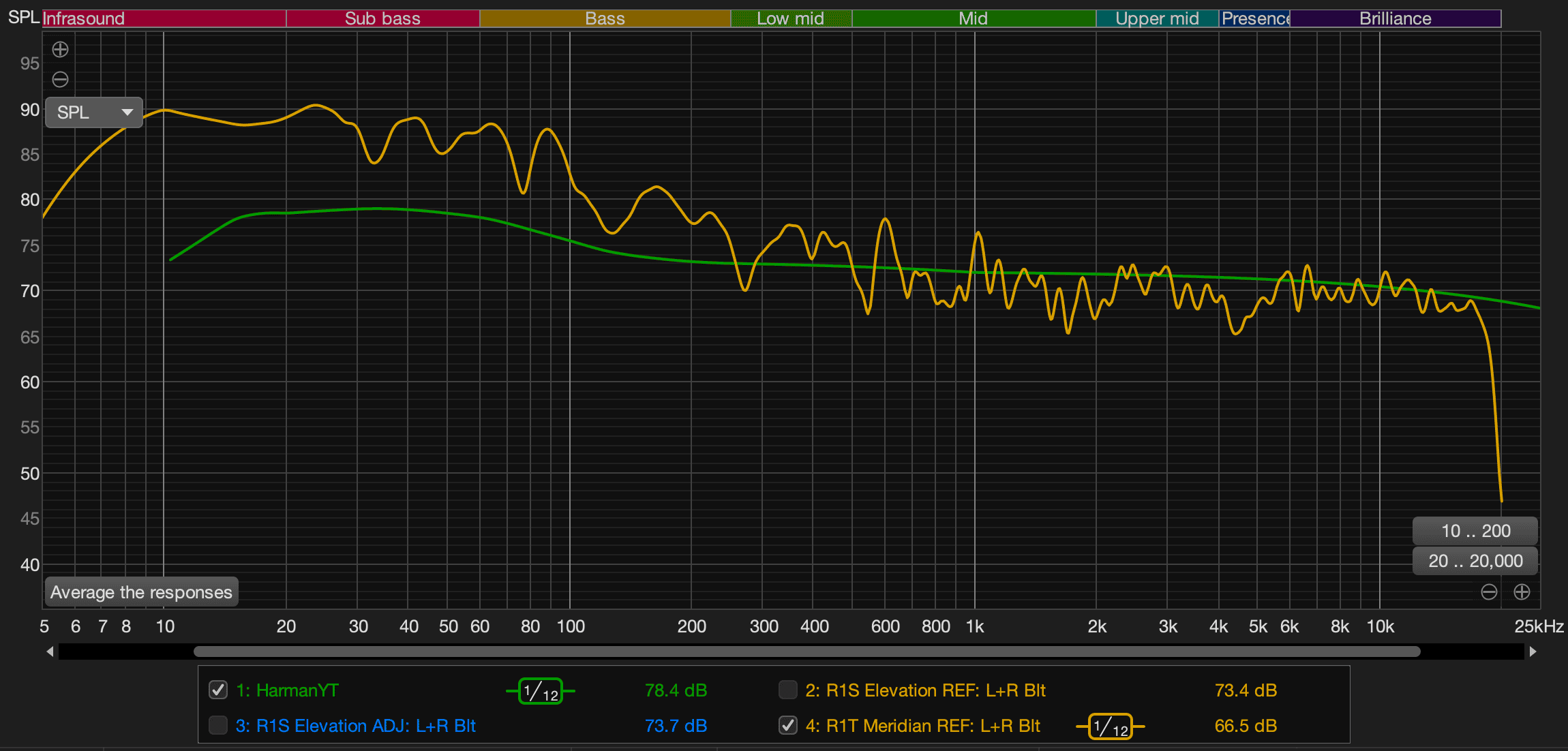

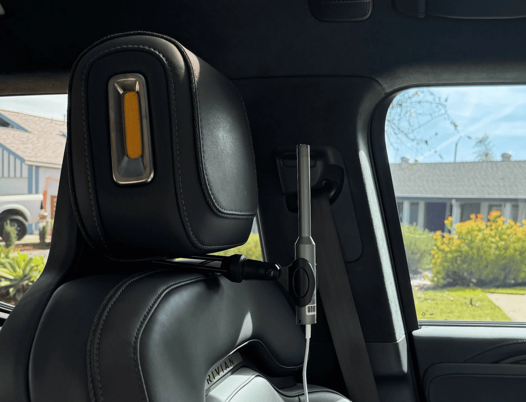

R1T Meridian Results with same Microphone, same settings, but far less experience as an operator. @superfluid has the original data files and will take a look when he get's a chance for more insight, but here's what I have...
I'll start with a picture of the Mic placement...
Rivian R1T R1S How to Improve a Rivian R1S’s Elevation Sound System With Simple EQ Changes (Equipment Measured Tests & Results) MIC Placement

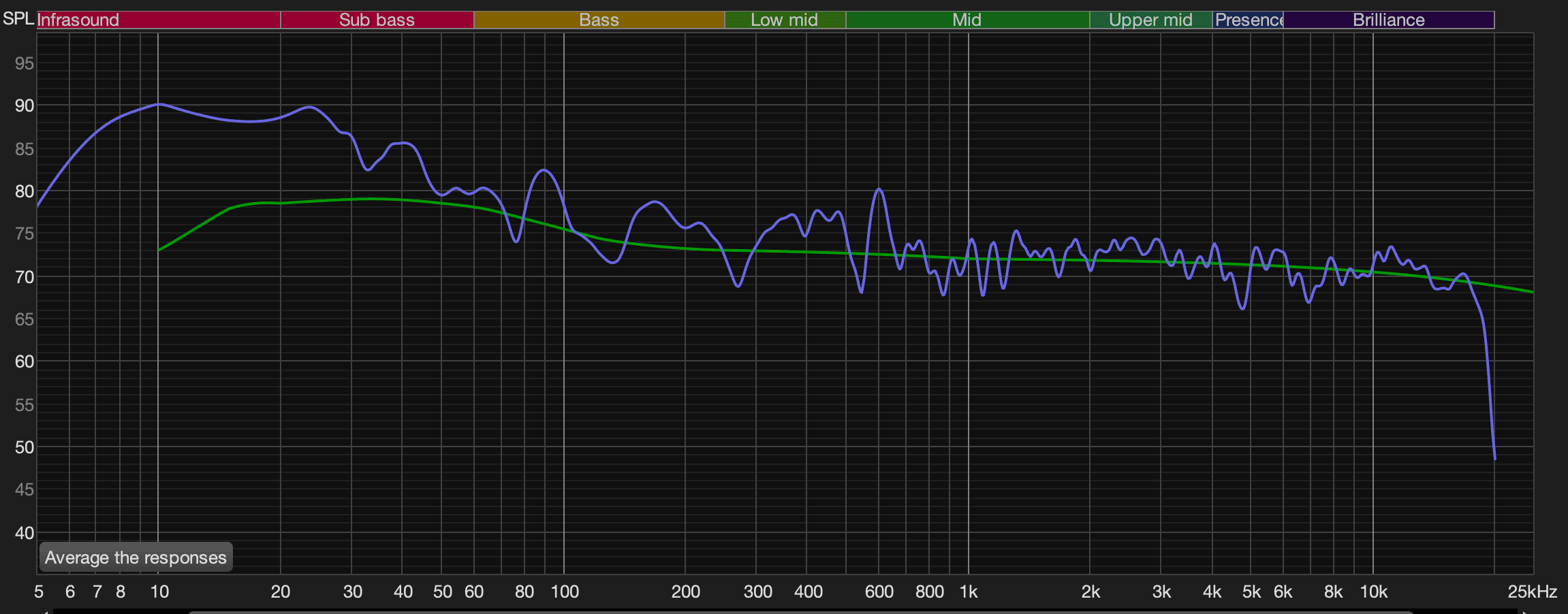

Here was my Reference Run below... What is interesting here is that the curve looks pretty good to start out with, none of that odd stuff that was found on the R1S Elevation. It is certainly low end heavy and accounts for some of the "boomy-ness" of the 100-150hz. This was taken at a volume level of 16 (75 DB reading on pink), Flat EQ,
Rivian R1T R1S How to Improve a Rivian R1S’s Elevation Sound System With Simple EQ Changes (Equipment Measured Tests & Results) REFERENCE
After many runs, I came to on this setting...
  • 63: -8 (Note: after listening for my tastes I run -3)
  • 125: -2
  • 250: -2
  • 500: +2
  • 1k: 0
  • 2k: +3
  • 4k: +1
  • 8k: -1
  • 16k: +1
And the curve looks like this.
Rivian R1T R1S How to Improve a Rivian R1S’s Elevation Sound System With Simple EQ Changes (Equipment Measured Tests & Results) TUNED
