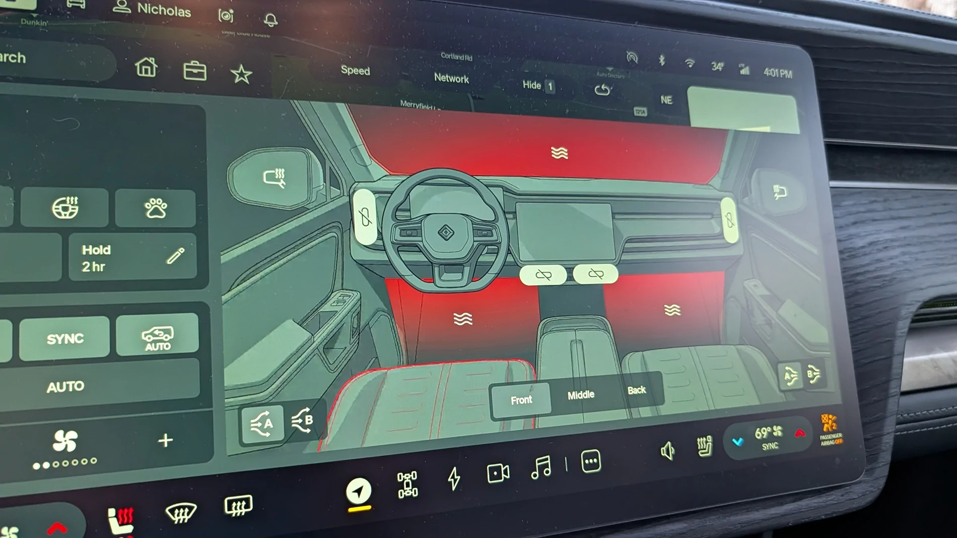

Not sure when this started, but by default the HVAC is set to floor and windshield by default whenever I start the car (remotely or not). Is there a setting that changed at some point? I don't remember it always being this way.
I prefer the vents open.

It's switched to heating configuration instead of cooling. That's the default for heating, your climate must be set to auto.

This vent configuration is the same as last year, and, like most other vehicles using an auto HVAC setting. Keeps the windshield heated/clear and, provides cabin heat through the foot wells. Nothing has changed this in my 3 years of R1T ownership.

I was about to ask the same question. Not sure about using auto climate but I'm constantly turning on at least the outside vents to clear windows. I've got a service appt in two weeks for ting washers and plan to ask them about the foot well heat. Gen2 and find my legs are quite cold (temp set to 75) compared to everything else. Recently put my phone in the bottom center console area during a trip. Picked it up and noticed it was really cold.

Interesting mix of replies here. Some, like me think that isn't how it always was and the incorrect way to manage HVAC and others are just wrong :CWL:.
We can just agree that everything about how Rivian handles HVAC is horrible . From the stupidness of motorized vents, to this oddity of floor and windshield default. It should just revert to however I last left it. I should NOT need to click the screen 9 times to get what I want.

I’m fairly new to Rivian about 2 months. And I have been driving an Ioniq 5 for 2 and half years. One interesting thing I noticed that during entire time with Ioniq I never really seemed to need to fiddle with HVAC — auto mostly, feel chilly up temp a bit. fan stays low — that’s it for over two years, never thought about it, life is good.
Rivian is different. I need to play with it every day and every drive. Feet are always cold. No ventilation. Never really sure what is fresh intake or recirculation. Checking climate screen window and foot wells are all red but I’m still cold. But a few days ago I saw first time window and foot wells are all in blue but my wife and I both feel nice and warm. So I tried to save that setting for future use but blue foot well never showed up again. So I checked what blue means in Rivian HVAC, it’s color for cooling of course! What is going on. Hope I’m not the only one.

Looks like "AUTO" is up to its shenanigans again. Or you've turned on remote heating (in the app), which also sometimes does that.
02 cents, I hate it. And one of the reasons I never use auto. Wildly unpredictable results and exactly the opposite of my preference, which would be windshield off, vents on, floor off. 🤷

My R1T always stayed the way I left it until several months ago. Now my vents are usually closed when I get in the truck and I have to turn them on manually. This is deferent behavior from the way it used to be. Soft and hard resets did not resolve this issue. Something has changed for the worse!
