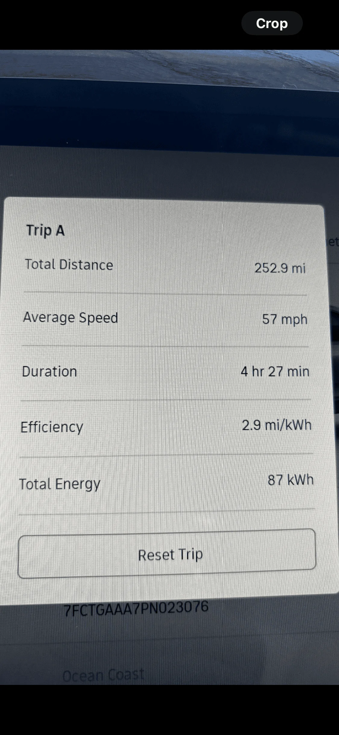

I did a trip from Pooler GA to Greenville SC. (Adventure network to adventure network, retired Army in a budget). Tried to get app to allow all purpose mode for the 255 mile trip, even after charging to 99% (316 miles). It kept saying I had to stop in Columbia SC to charge. I have never used Conserve (347 miles), but tried to have the app use conserve for the trip. Once again it stated I had to stop in Columbia, both showing 36 miles upon arrival. So I did it anyway. Approx. 200 miles in conserve. (Factors and info: Drove 60mph the whole way, zero traffic, sprinkled once for 15 min. tire pressure 48psi, I95-I26 I95 flat (3.15 avg) I26 rolling small hills (2.80), temps 61-70, zero preconditioning evening having AN in the nav. Wind calm-4mph. 2023 R1T, with spare, 180lb person, 300lb camping gear. Drive done early in the morning, but would like to state once the sun came up my efficiency to started to drop significantly.) I was getting 2.80 avg on I26 until sun came up, which dropped to 2.67. Overall 2.9 efficiency. Zero stops, but did accidentally go 5 miles out of way.

Sorry forgot one thing! When I switched off conserve to all purpose. It showed I had 106 miles remaining I could drive, with what I drove at the time that would add up to 366 miles in conserve, my full charge in reserve is 347.(19 more miles, not bad!)

Why do you think efficiency dropped when the Sun came out?
I am not really sure that is the reason it dropped, it was the only thing different I noticed. ( No traffic, temp same, driving same speed. Can’t really answer that)
