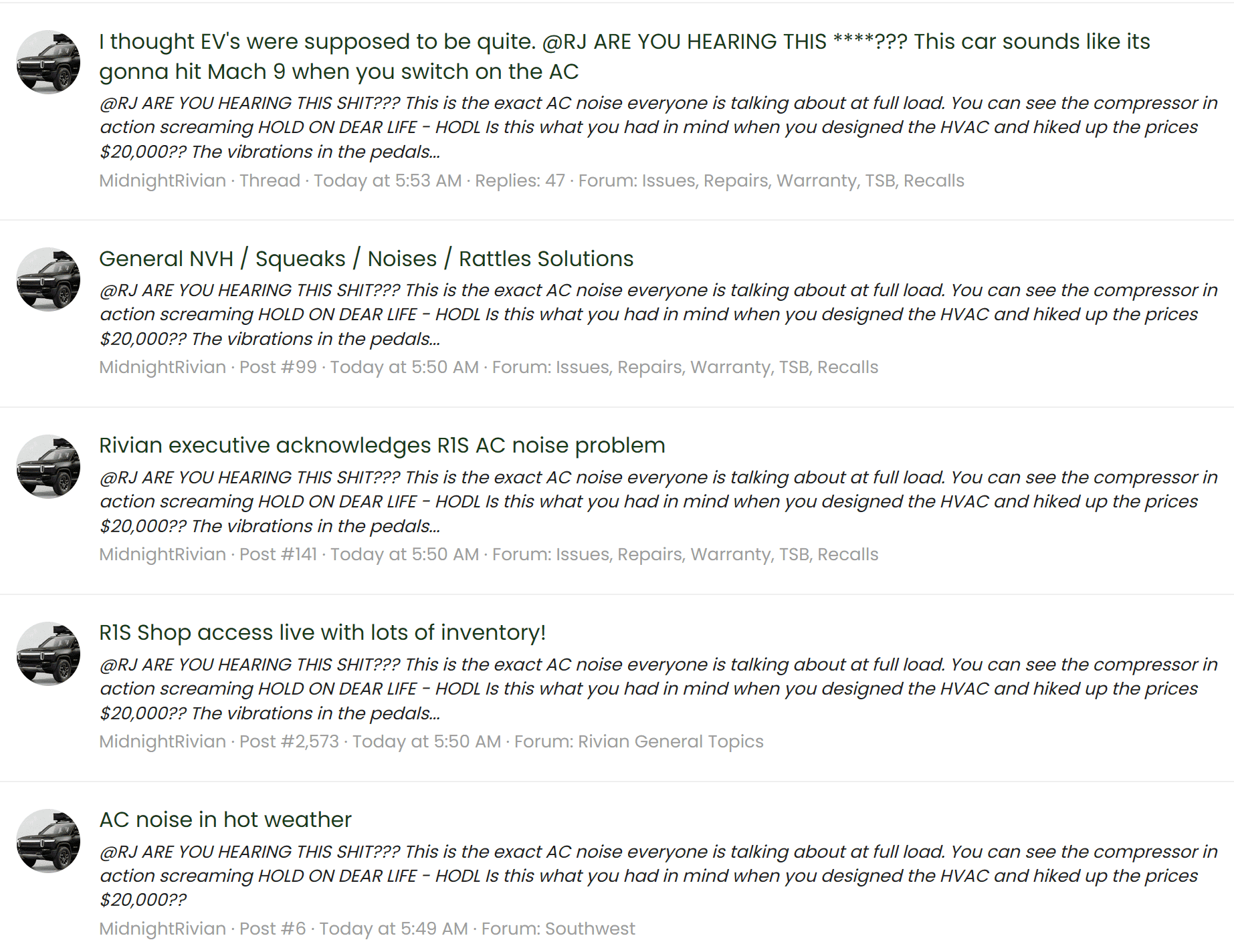

Congratulations, you manage to turn a legitimate complaint into an unhinged screed. I don't think anyone is faulting you for being upset, but blowing up people on the forum with spammy rants and hyperbole doesn't accomplish anything besides pissing off folks who would otherwise agree with you. It's some real "temper tantrum at the cash register" shit.
The word for this is "spam." No, RJ is not hearing this shit, he's not here and typing "@RJ" does not make it so. It just makes life more annoying for the rest of us who are trying to use the forum and now have to scroll past your reply spam in five different threads on three different sub-forums.

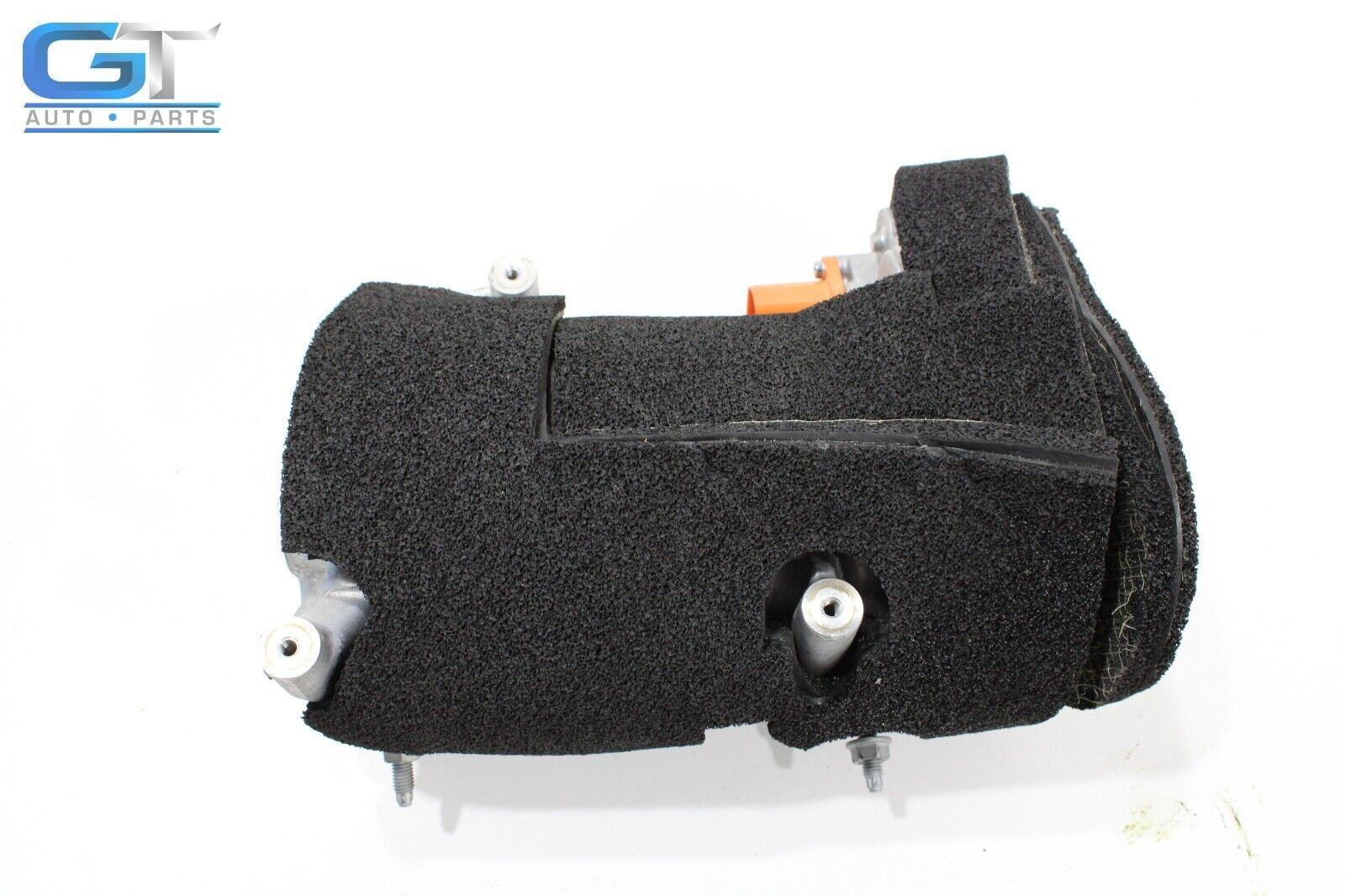

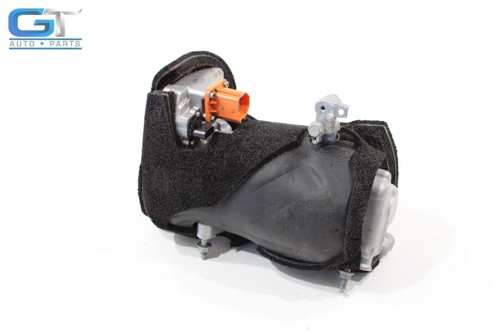

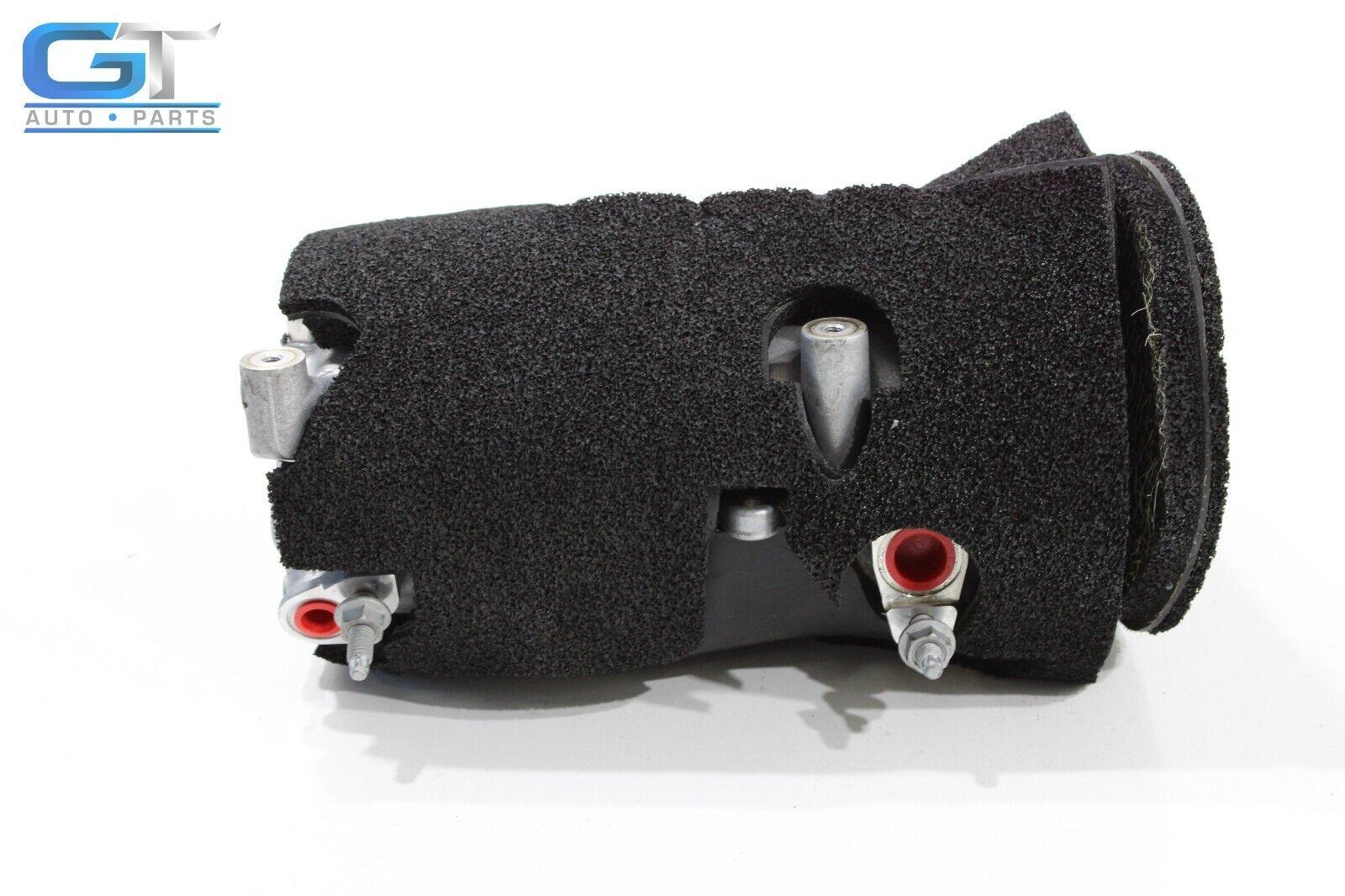

My bet is the air intake box or shroud vibrating when compressor is at 100% load. Mine only make the vibration noise when vehicle is in motion. Compressor is loud but Tesla compressors are loud too on MY ...later on Tesla added foam insulation and possibly some isolators to reduce NVH.
I don't believe this problem is a functional issues. This is an NVH issue as far as I can tell. I agree with poster above the location of the compressor is a contributing factor.
Rivian will address and likely put out a TSB.
It sounds like the need better mounting with rubber noise isolation and and acoustic cover like Tesla.
