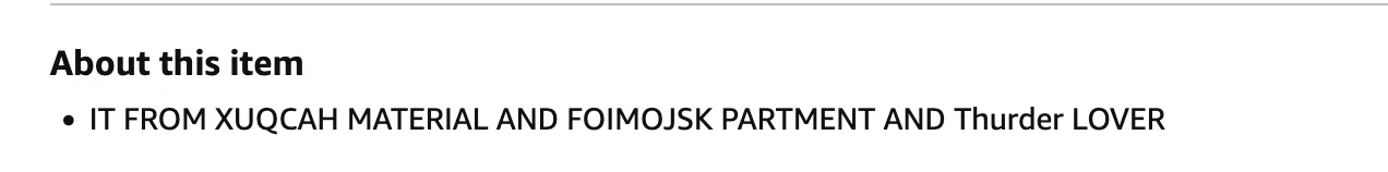

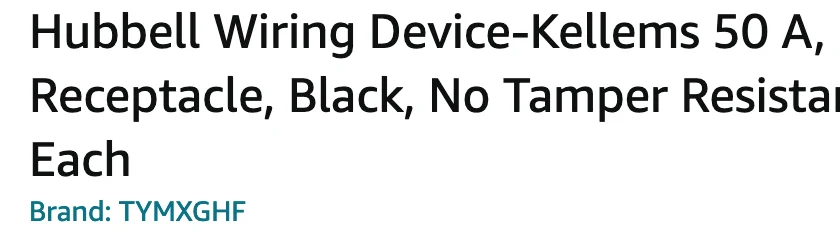

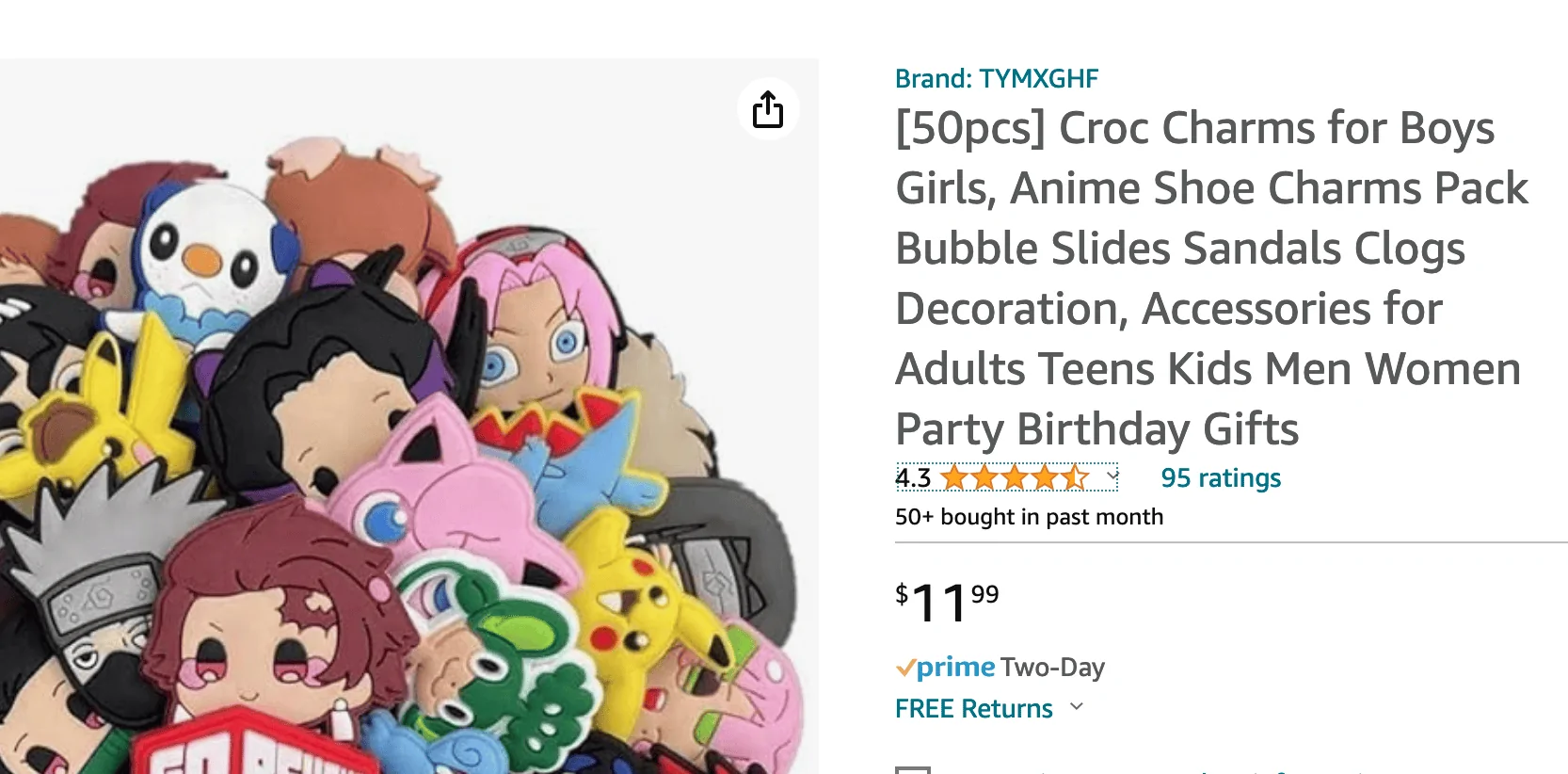

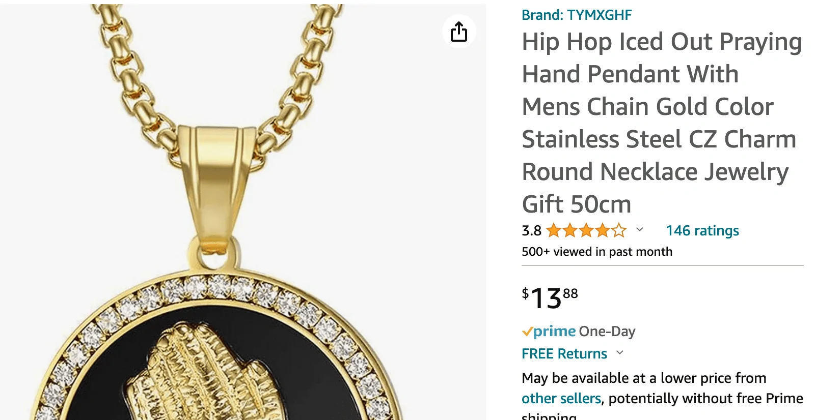

Like this?
https://www.amazon.com/Hubbell-HBL9...fos.006c50ae-5d4c-4777-9bc0-4513d670b6bc&th=1
