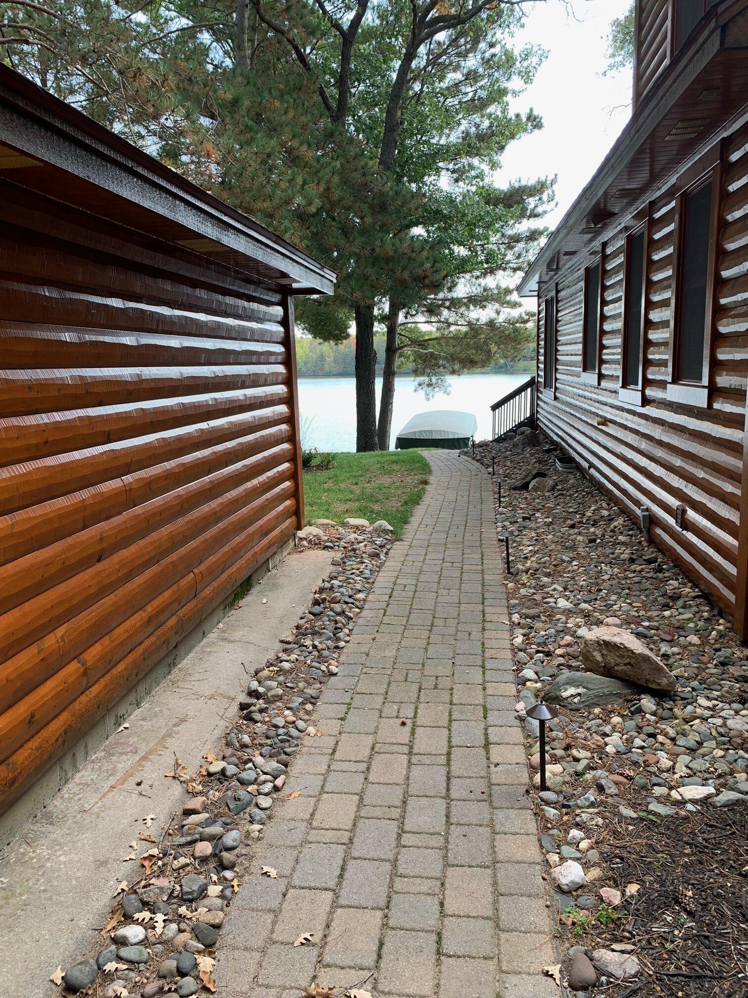

First estimate:
Feed from house to garage $800.00 - $1,000.00
Garage panel $800.00
Charger receptacle $450.00
Tie in existing garage power to panel $200.00
Permit $ 75.00
So this is a detached garage at our cabin, so it's not as easy of an install. The panel is in the basement on that wall where the cabin runs next to the garage. They would have to run a line under the sidewalk, and into the garage and add a subpanel there.
