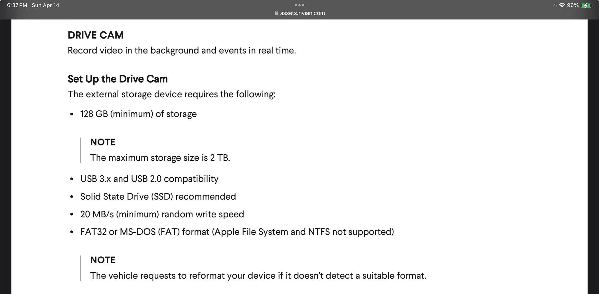

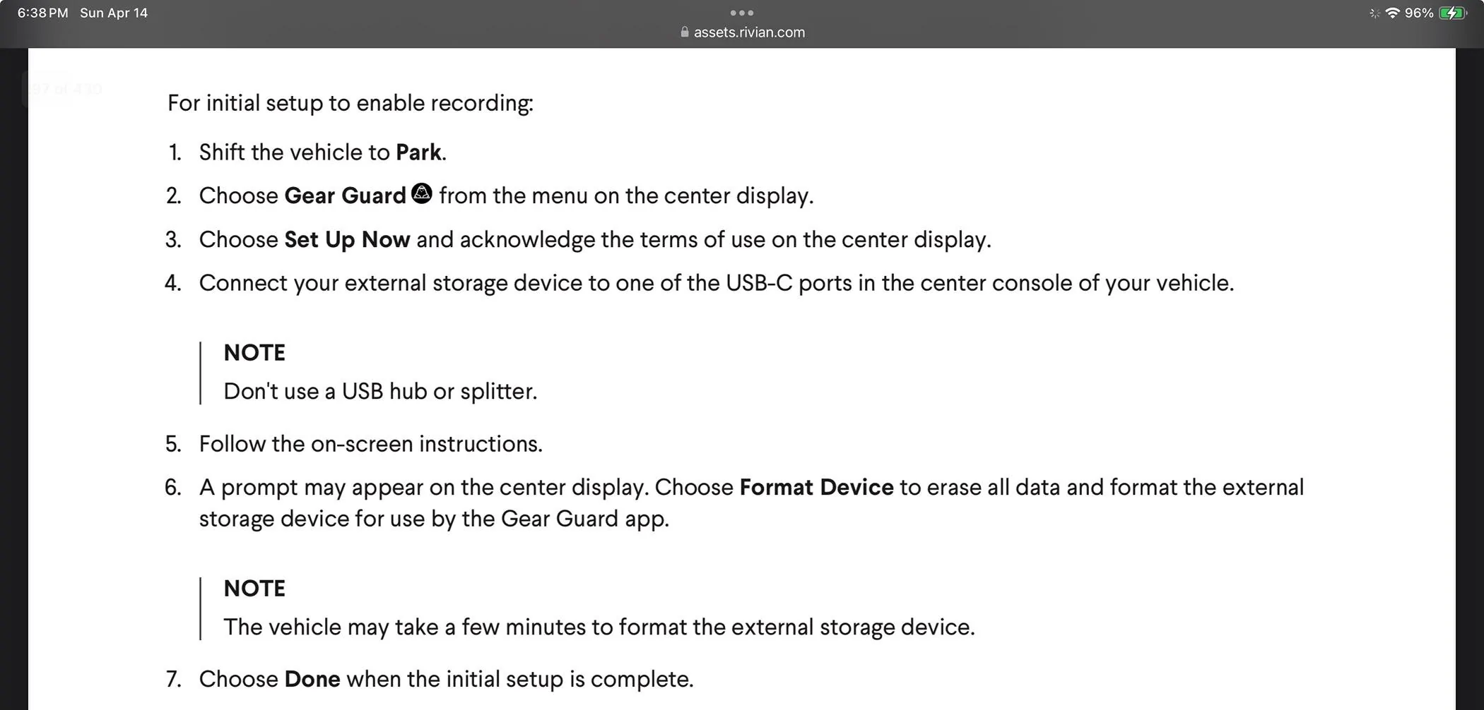

I am installing a new SanDisk Extreme Portable SSD by using one of the usb c connectors in the armrest well. How do I verify that the truck recognizes the drive? I installed the drive using the small cable that came with the drive.

Did you follow the instructions in the user's manual and then enable the Drive Cam? If it didn't recognize your SSD then you won't be able to enable it.

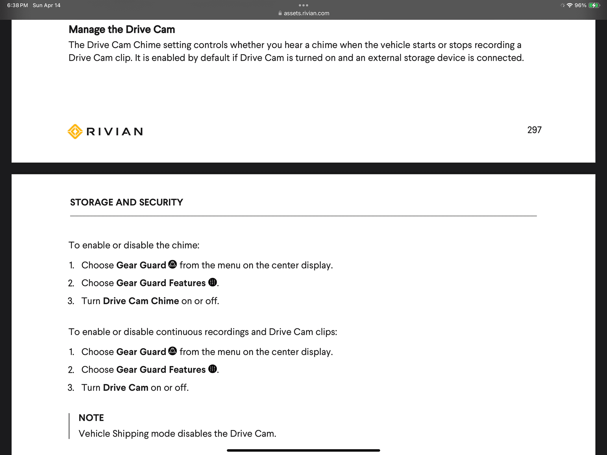

This weekend I bought a 1-TB Sandisk SSD, with USB-C cable and USB-A adapter, for $79.95 plus tax at Costco. I installed this "on the road," using Gear Guard screen to access the "Gear Guard Features" screen (once in Gear Guard, look on the left side of the screen for an icon that looks like three adjustment knobs). Installation took about two minutes.
To minimize cable stress, I also got a Silkland 90-degree USB-C to USB-C adapter, but it didn't arrive until after I'd installed the SSD. To install it, I went to the same "Gear Guard Features" screen, then hit "Eject." Removed the original cable, put adapter on the male end, plugged the new assembly back into the Rivian. Installing the 90-degree adapter took about one minute.
