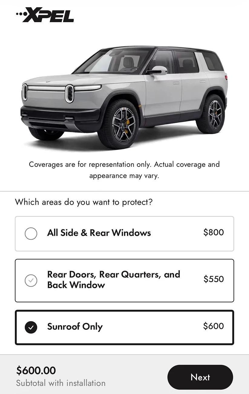

Yep. But good to be mindful of where to stop - e.g. no darker than ~50% on sunroof per Xpel guy I spoke with. My plan is for XR+ 55 when the time comes. And might be worth using a provider listed via that Rivian-Xpel hop to be sure of warranty coverage?
Rivian R1T R1S Interior roof cover for R2? IMG_1585
That said, I do wonder what already-official Xpel instal shops have to do to make the further cut for that specific Rivian-Xpel hop - fees, bribes, etc.? I’ve got two dedicated Xpel shops we’ve used for our three cars with window tint (both fine, long story) but only one makes the Rivian-Xpel list.

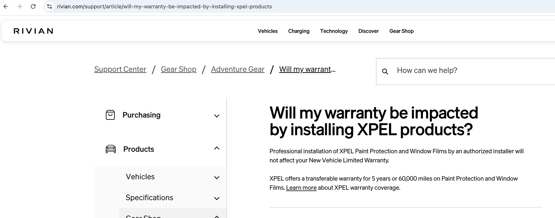

Re: the possibility of tint cracking the sunroof, I just ran this down with Rivian support. Kicking myself for not seeing the following on my own, but at least it took the Rivian guy 25 minutes to find it:
Rivian R1T R1S Interior roof cover for R2? Rivian-XPEL Warranty
Guess my strategy is tint the roof and hope that if it cracks, it does so before the warranty expires.
Is that interior or exterior glass film?

I think this is still going to a potential fight. I imagine any cases of this happening will come down to how much the service technician cares and whether Rivian's legal team really wants to get involved. I suspect that unless you have a history of dubious warranty claims, Rivian probably wont bother pushing back if you make a stink about it.
Disclaimer: I'm not a lawyer, and have also never dealt with Rivian's warranty process, so this is pure speculation.
The problem with the XPEL statement is that it says the film won't void the LVW, but does not affirm that the LVW covers this damage. The following snippets of the LVW itself could be interpreted either way, in my opinion:
Rivian R1T R1S Interior roof cover for R2? Screenshot 2026-06-30 at 3.17.59 PM
(initially suggests damage from a third-party add-on would not be covered (ie not a factory defect).)
Rivian R1T R1S Interior roof cover for R2? Screenshot 2026-06-30 at 3.18.17 PM
(... but is the XPEL product "approved by Rivian" simply by virtue of the partnership?)
Rivian R1T R1S Interior roof cover for R2? Screenshot 2026-06-30 at 3.18.27 PM
(... again implies that cracking due to excess thermal load from an add-on may not be covered because it is not a defect in material or workmanship.)
I could see Rivian arguing that either the sunroof tint was not "approved" (despite being offered by an official partner), or that the heat cracking was due to improper use rather than a defect.
However, you might be able to counter by saying the heat cracked the glass because of a defect, and a non-defective part would not have cracked. This might be reinforced if many people apply tint and don't have issues, then the ones who do could claim there was a hidden defect.
