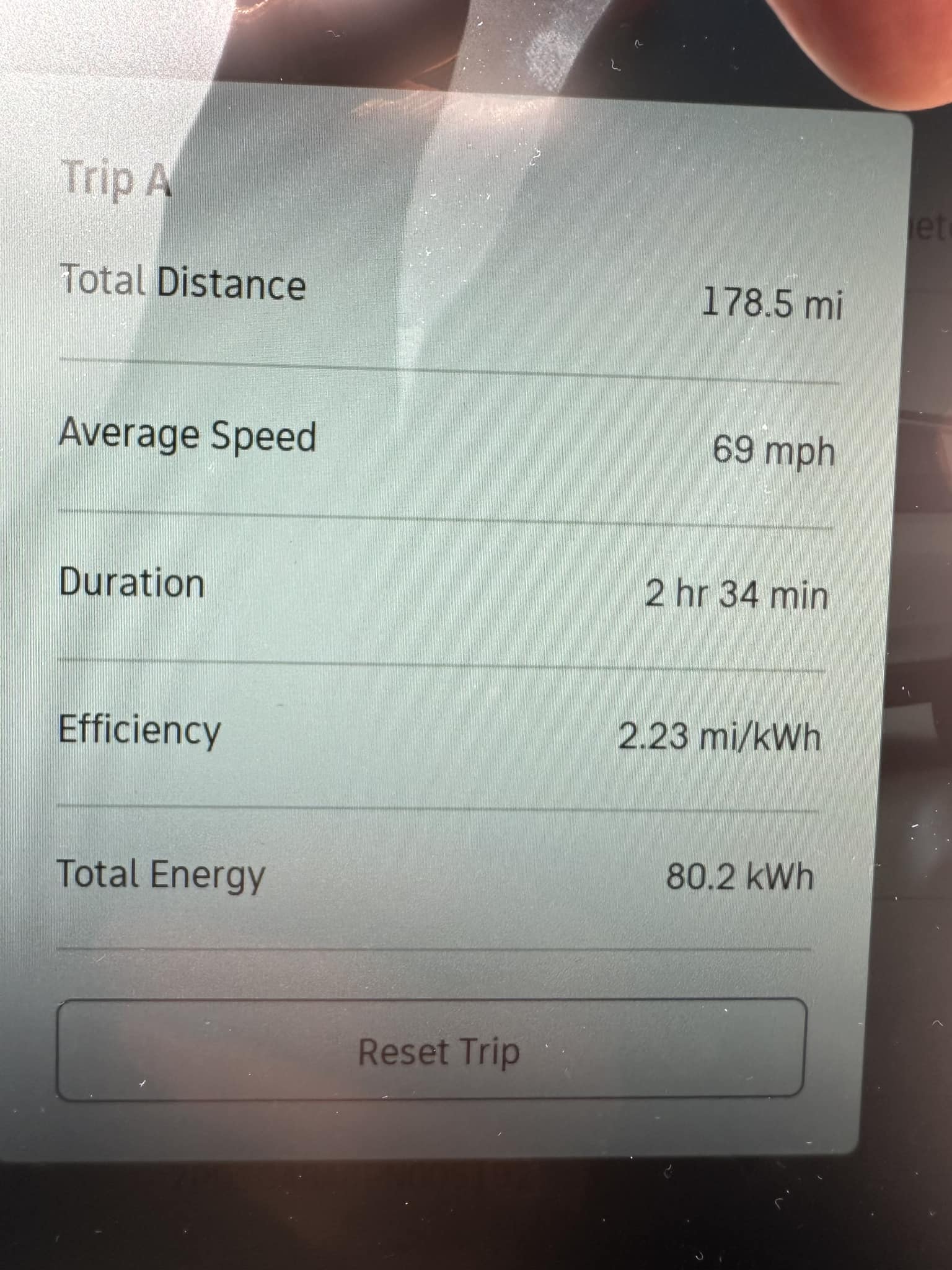

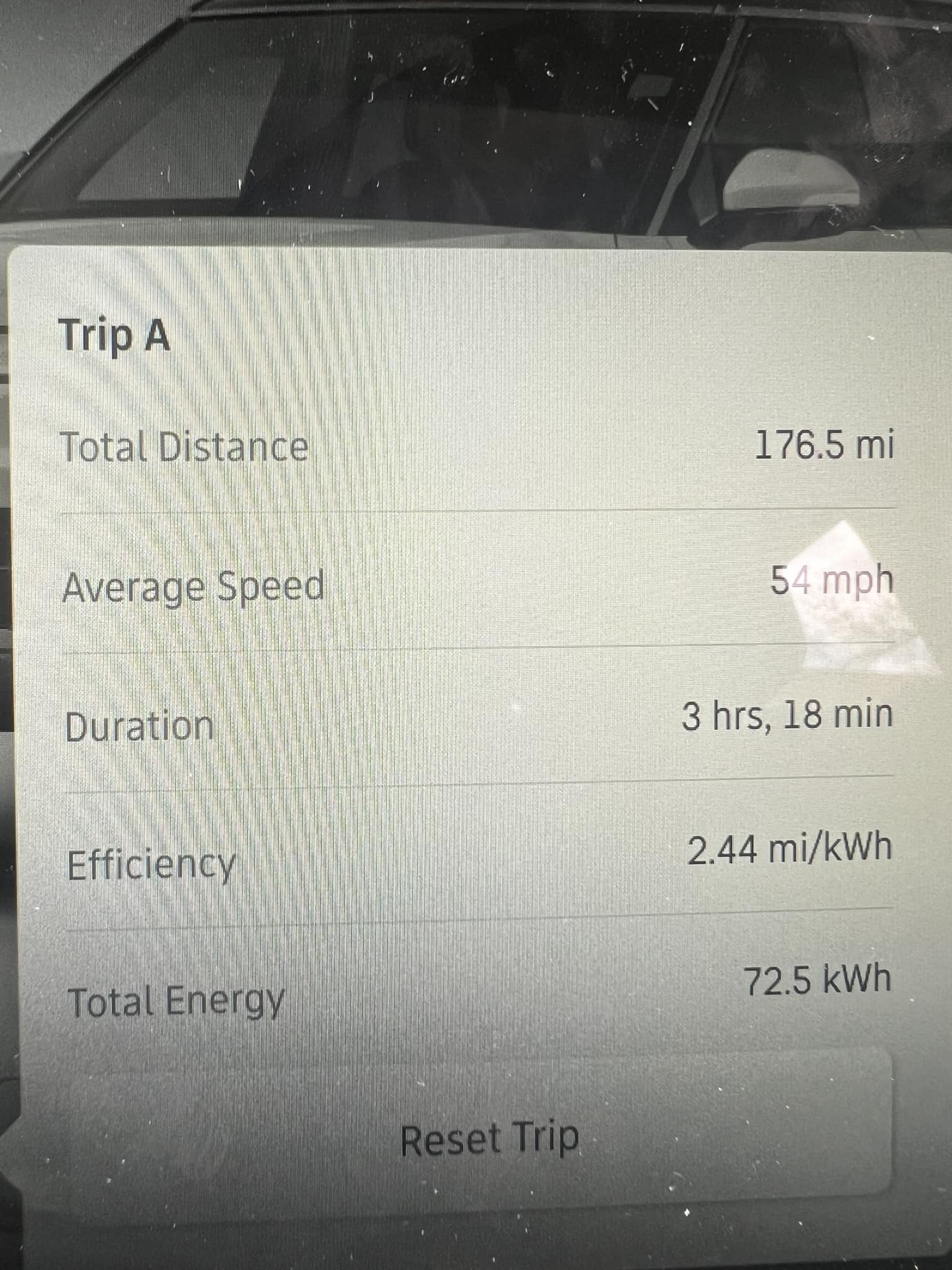

we did quite a few of Dallas to Norman these past summer. Here is our last trip. All of these are conserve with 21" without aerocover. . Yesterday was the first day weather got around 40 degree so it definitely be the factor for you. The top picture is Norman to Dallas. (no traffic). Bottom is Dallas to Norman.

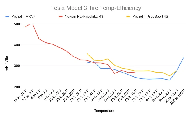

Thank you all for the replies - I was mostly surprised at how big a difference their was from the same speed, where the only changes between the two legs of the journey was a) headwind and b) temperature drop to 45-50degF. 1.8mi/kwh was definitely the higher end. Most of the trip was less than 1.5mi/kwh. I had no outboard luggage or racks to affect wind resistance, for reference.
Thank you to the reply that referenced the temperature graphs. I assumed/hoped that the temperature effects would be less pronounced above freezing temps, but even going from 80degF to 60degF there was some real range loss. It was surprising to this neophyte, anyway.
I’m planning to drive around town (mostly highway, mostly in traffic fwiw) the next few days while it’s still cold, without making any changes (leave the tires at 40psi, aero covers on) to see if the headwind was the biggest factor, or cold.
Speed / wind has a much, much bigger impact than temperature.
The impact that a headwind has is very easy to calculate. As others have noted air resistance is proportional to the square of the speed. ( 70MPH + 15MPH headwind) ^2 / ( 70MPH - 15MPH tailwind) ^2 / = 2.3
Switching from having a 15mph tailwind to a 15mph headwind will more than double the air resistance. Air resistance the biggest consumer of energy, so yes wind can have a huge impact on your range. This isn't an EV thing. A gas car would also burn 2x as much fuel when dealing with a headwind vs a tailwind.
Based on the data from my Tesla, temperature's impact is much smaller. It does add up, but to double consumption like switching from a 15MPH tailwind to 15MPH headwind can do you are looking at seriously cold temperatures.
