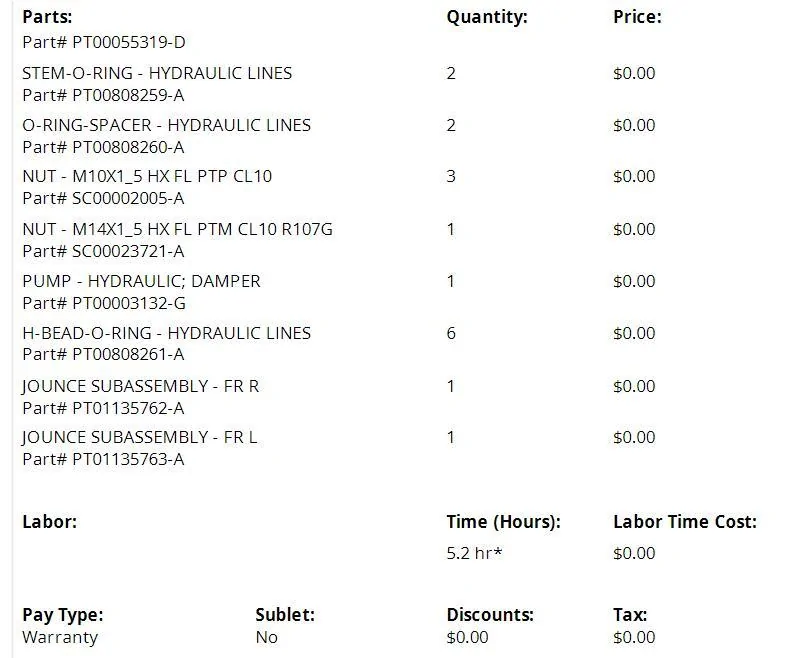

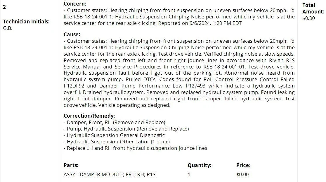

Unfortunately mine did not go according to plan.
Rivian R1T R1S Jounce Lines Replacement (Fixed Squeaky Suspension) + Other Service Notes Screenshot 2024-10-01 135058
Rivian R1T R1S Jounce Lines Replacement (Fixed Squeaky Suspension) + Other Service Notes Screenshot 2024-10-01 135214
Notes indicate an issue with the hydraulic system after the Jounce lines were replaced with the new parts.
I was assured that there is no concern with the now mismatched front dampers, which are visually different, at least with regards to the plastic accordion dust covers. Driving fine and seemingly quieter over bumps, but more driving needed to make sure.
Dropped off on 9/6 for a rotational clicking noise from the rear drive unit, which they could not diagnose and is still happening, but I added this Jounce line TSB and the AC Vibration TSB to the appointment after dropping it off, thinking it would be time well spent to get it all done at once. Nearly a month later and a lot of headaches in a Wrangler 4xE rental, I am questioning if it was all worth the trouble. I think I would be happier if both front dampers were replaced to match each other and guard against potential future leaks due to the apparent accidental overfill and pump failure. But if it's true that the updated front dampers perform the same despite the cosmetic differences, I suppose I can live with it.
Dampers should always get replaced in pairs. But with the disparity in dampers, I would 100% request them all to be replaced. They are vastly different spring rates. My SC replaced all four air springs.
Can you help me find some data/documentation to support this claim? I follow this logic and specifically asked if there is any concern with the dampers now being mismatched and they said they were the same performance specs, but I had a hard time believing that myself when I noted the visible differences in the accordion boot covers. If the revised Gen1 front dampers are indeed different in their performance or even in the spring rates/valving then I can push for the FL damper to also be changed to the updated version.
jpmc86
Juan
Sep 10, 2022
254
129
Miami, FL
2015 Mercedes GLK 250, 2009 Mercedes E63
I don’t have any data other than I could feel them vastly different. The whole car is softer now. I believe these are the ones gen2 vehicles use now as they have the same PN and this is one of the reasons gen2s feel softer. There is some data that they now use Firestone rubber instead of continental and are manufactured in the states.

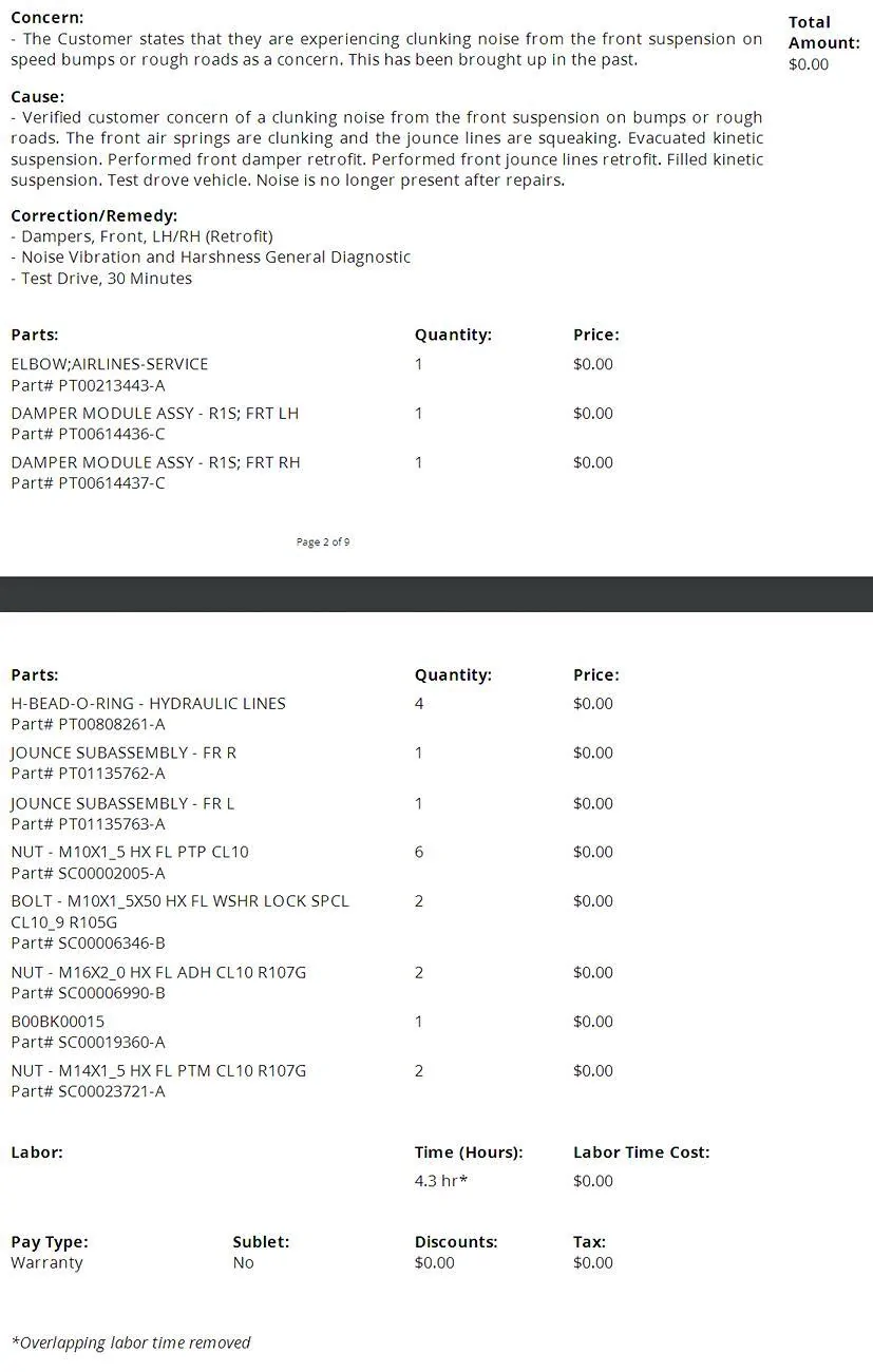

I just got new jounce lines / retrofit and also got new dampeners for both sides / retrofit.
It does sounds better along with new halfshafts and hubs.
I am currently at ~ 28,000 miles on my Quad Motor June 2023 build R1S.
I appreciate Rivian and my local service center taking care of this concern.
