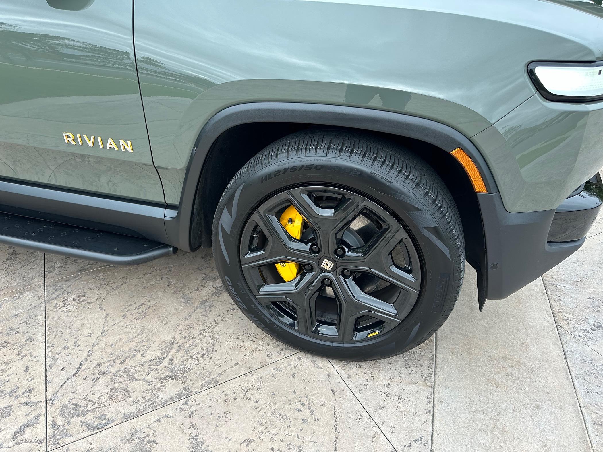

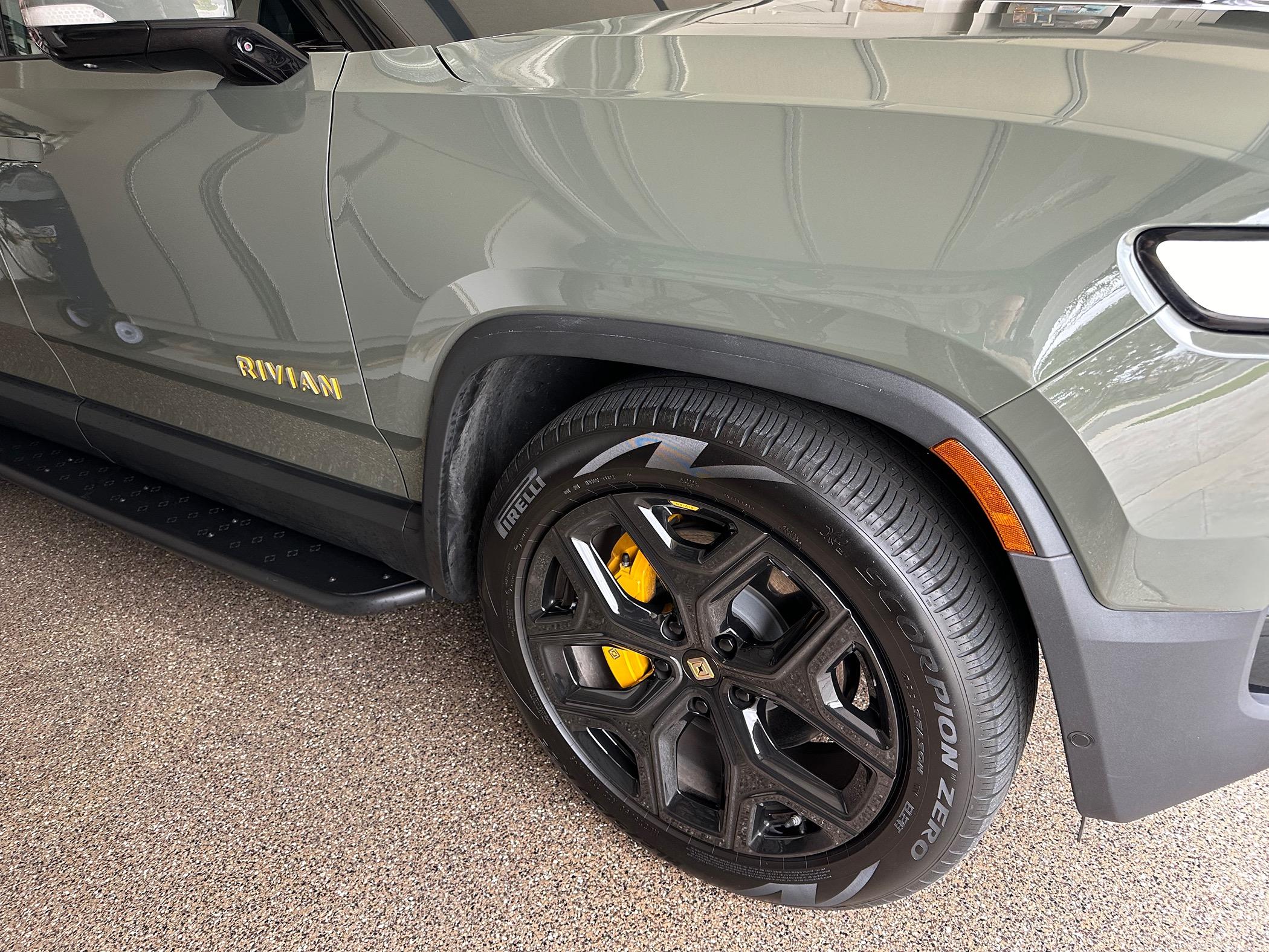

Here is an example of the Cerakote Restorer, I could not get rid of what looks like a mfg seam line on the trim over the front wheels, this seems to do a good job hiding them. Here are before/after samples, you can zoom in to see the line that is right on the bend of the piece.
Rivian R1T R1S Keeping black plastic trim BLACK!? IMG_9934
Rivian R1T R1S Keeping black plastic trim BLACK!? IMG_9935

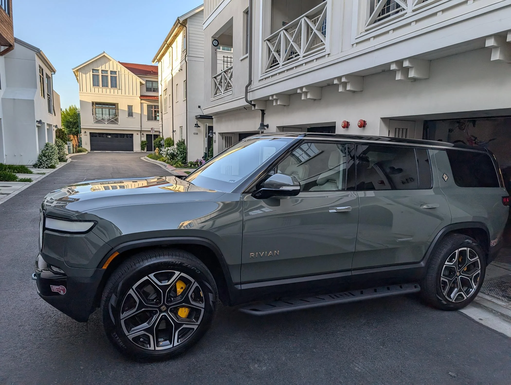

Used Cerakote last night, looks great. No major streaks/waves.
Left one area on front unsealed to monitor for a few days and compare.
Highly recommend.
