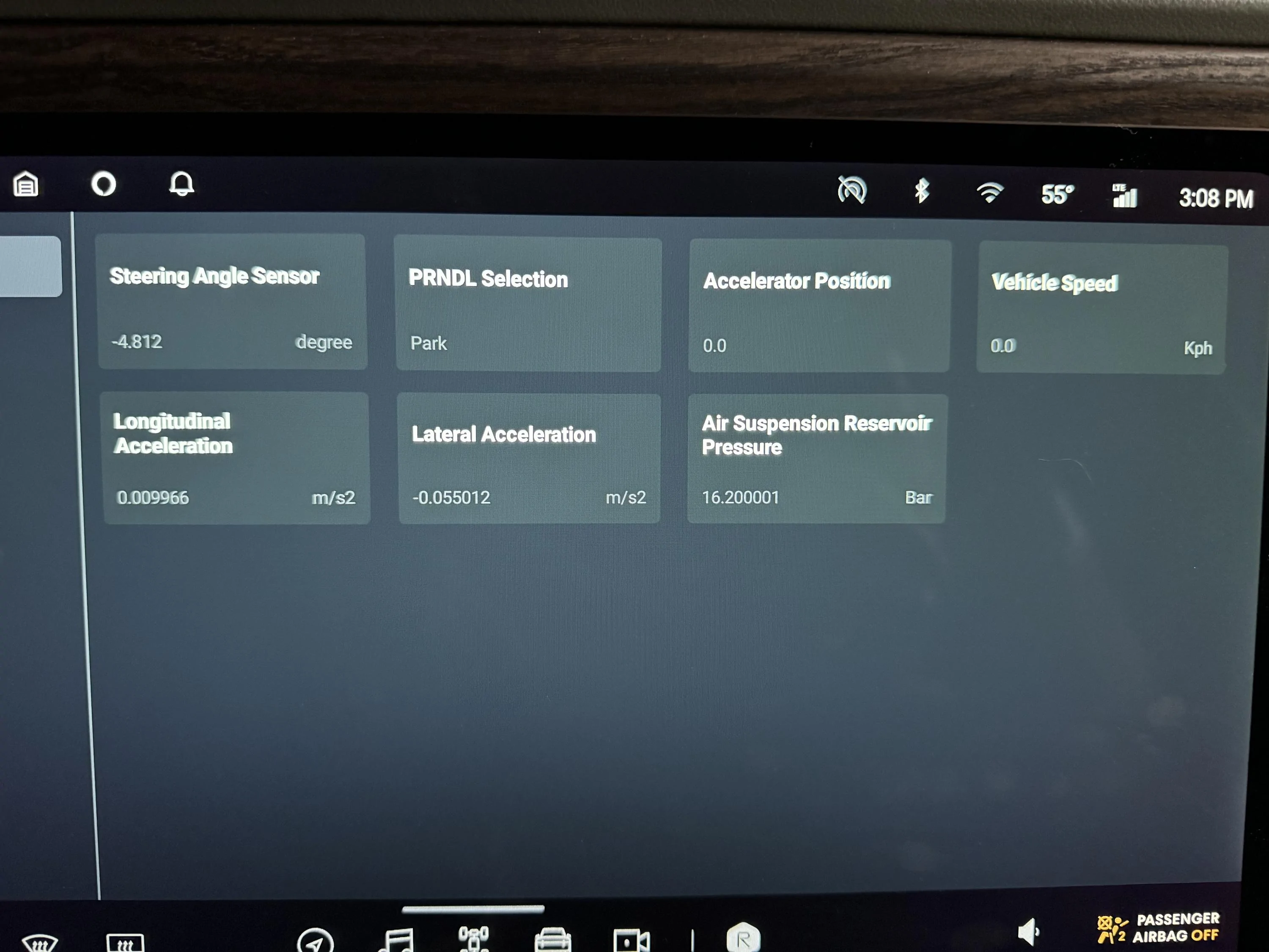

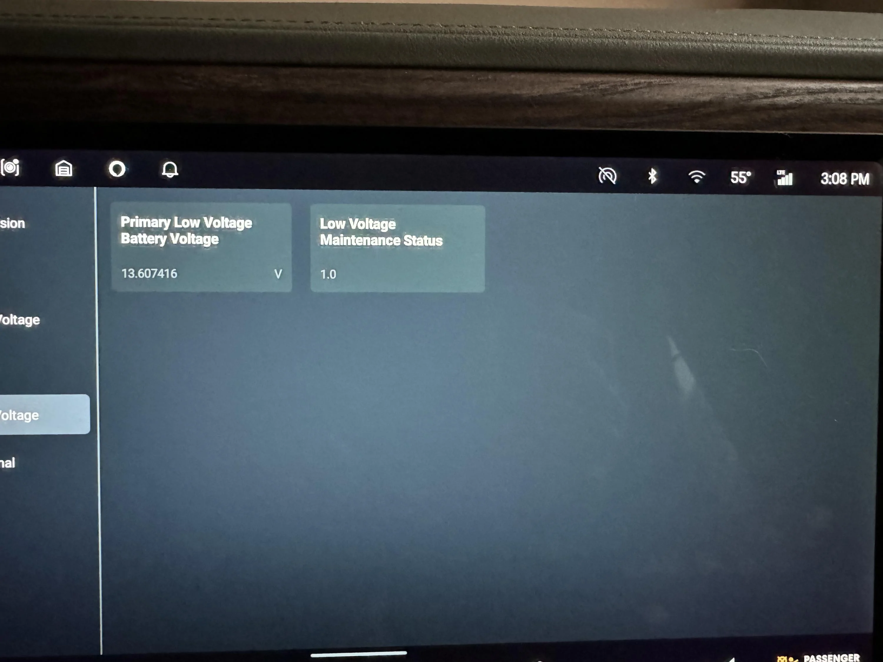

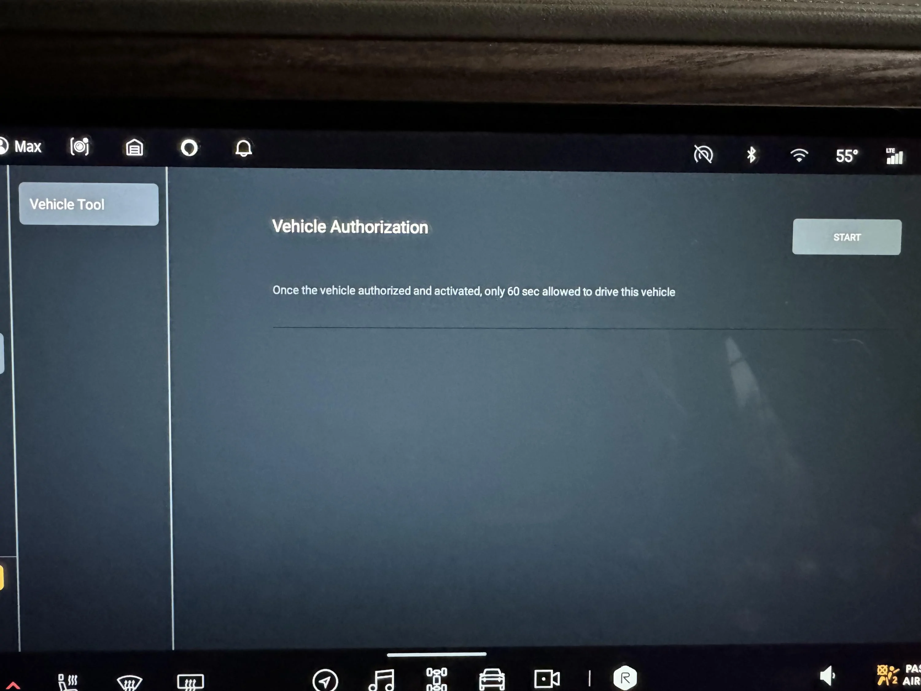

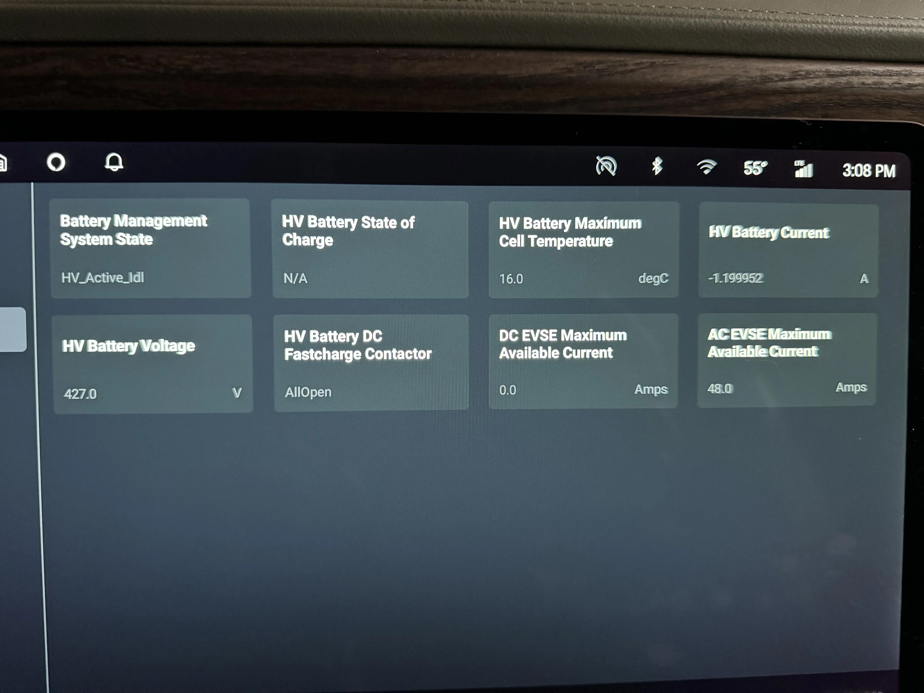

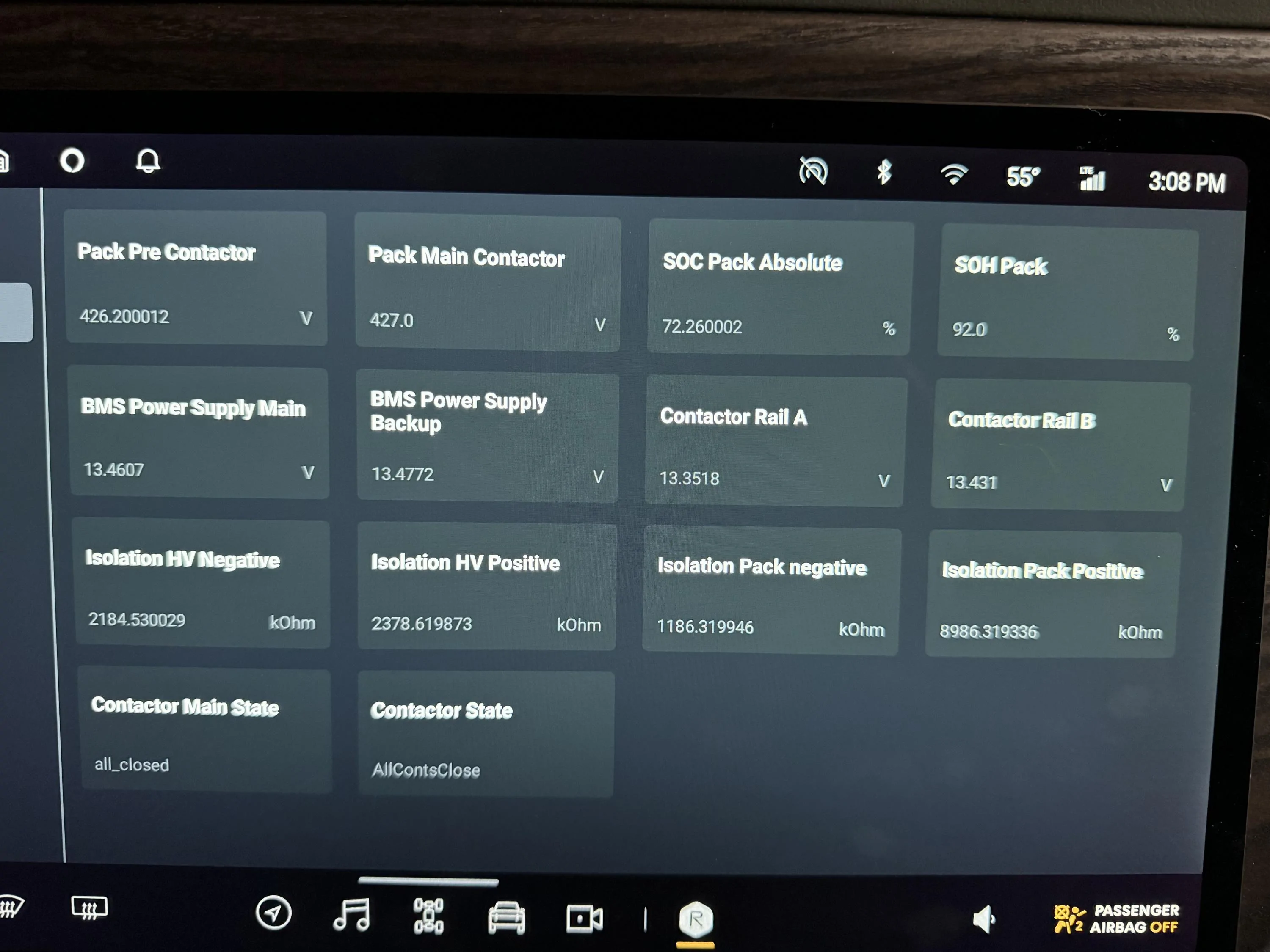

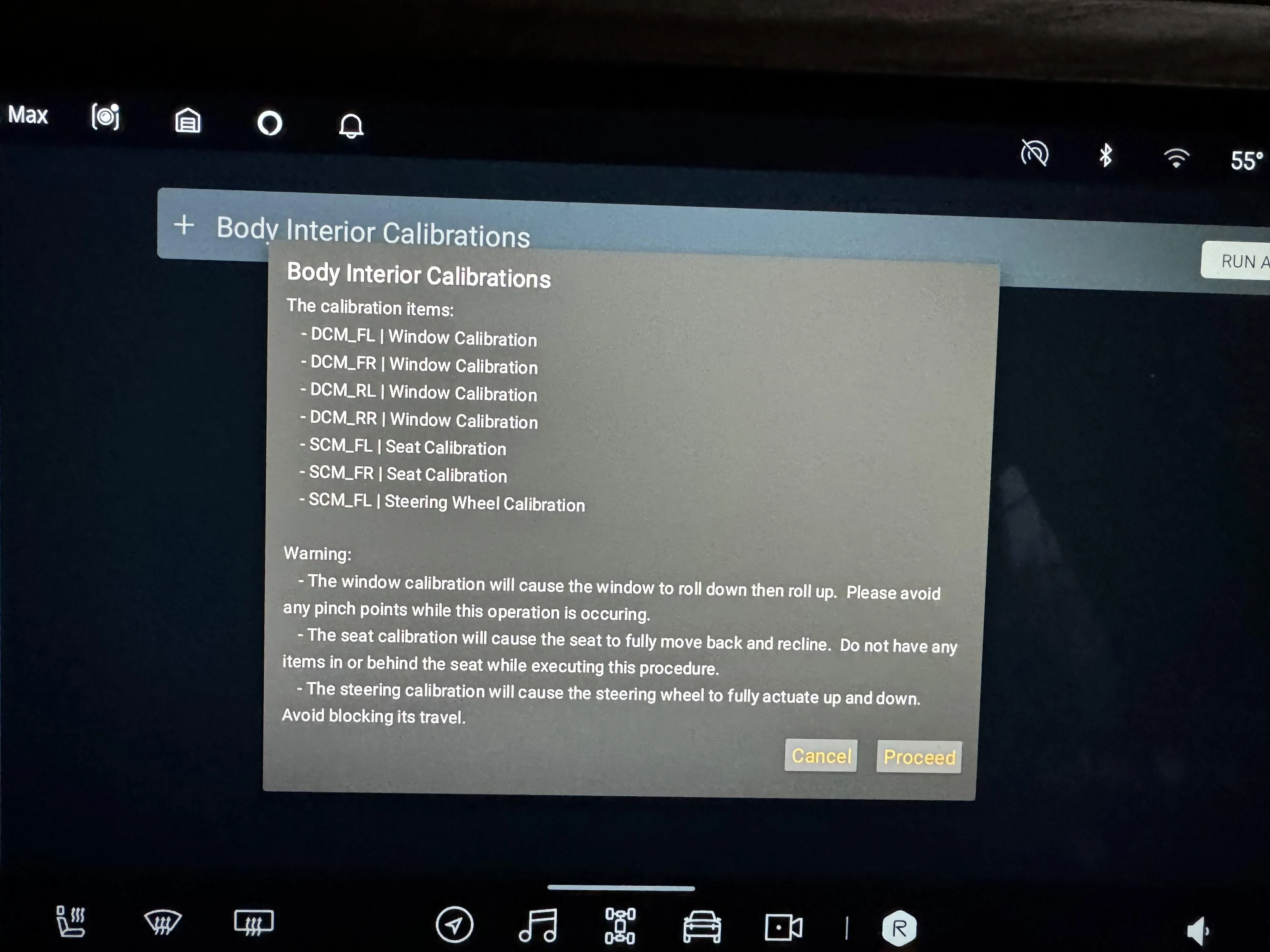

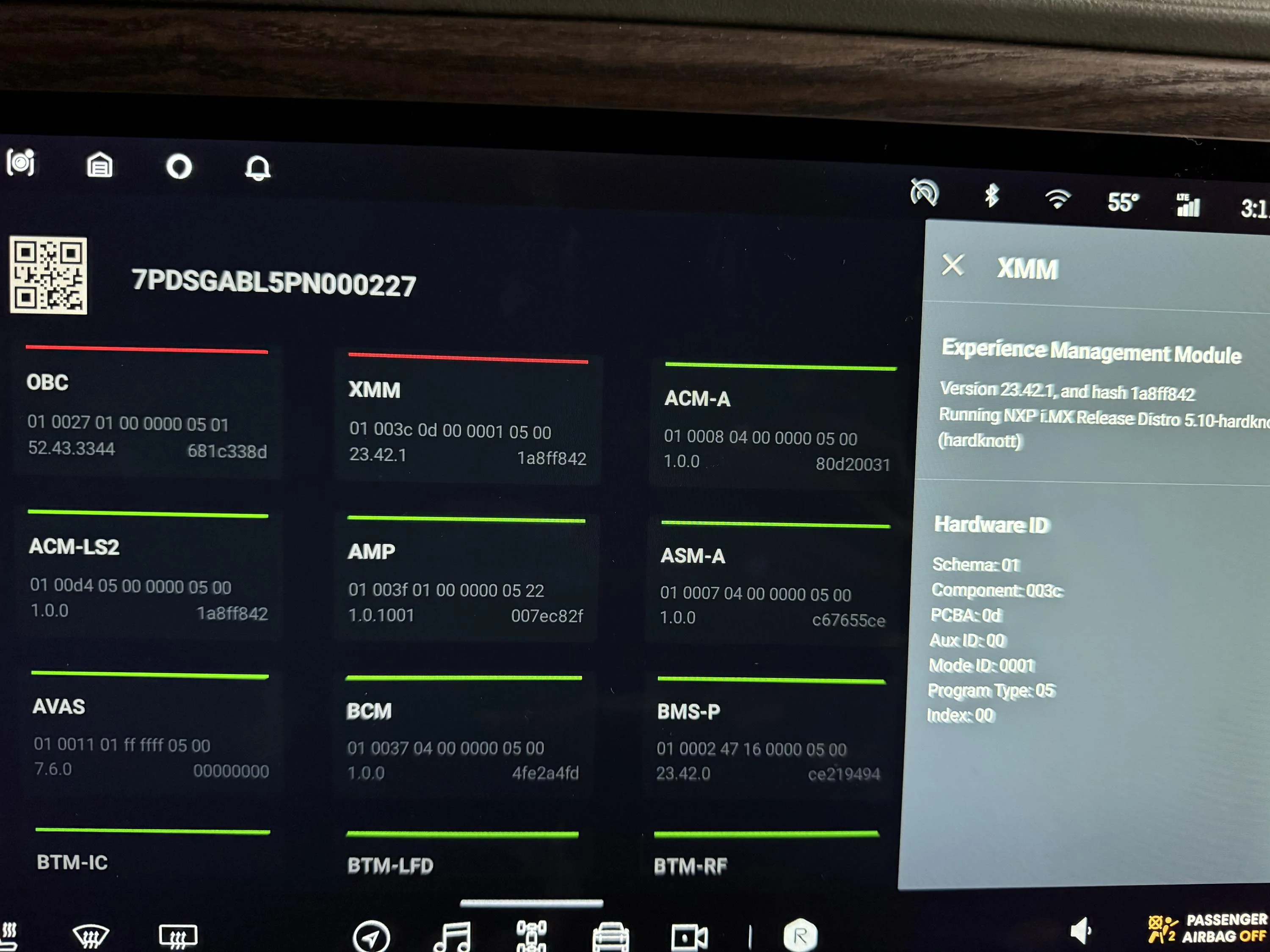

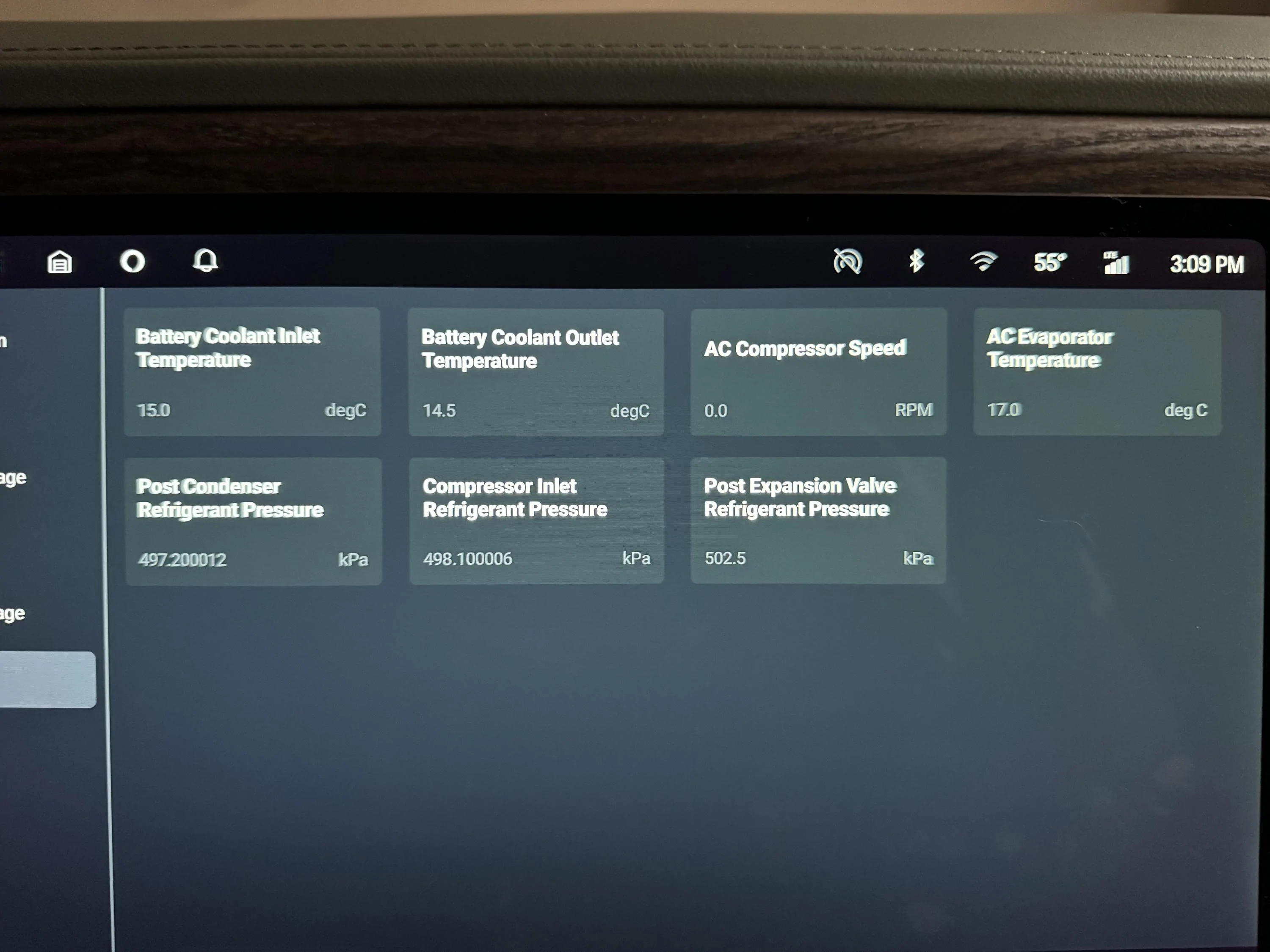

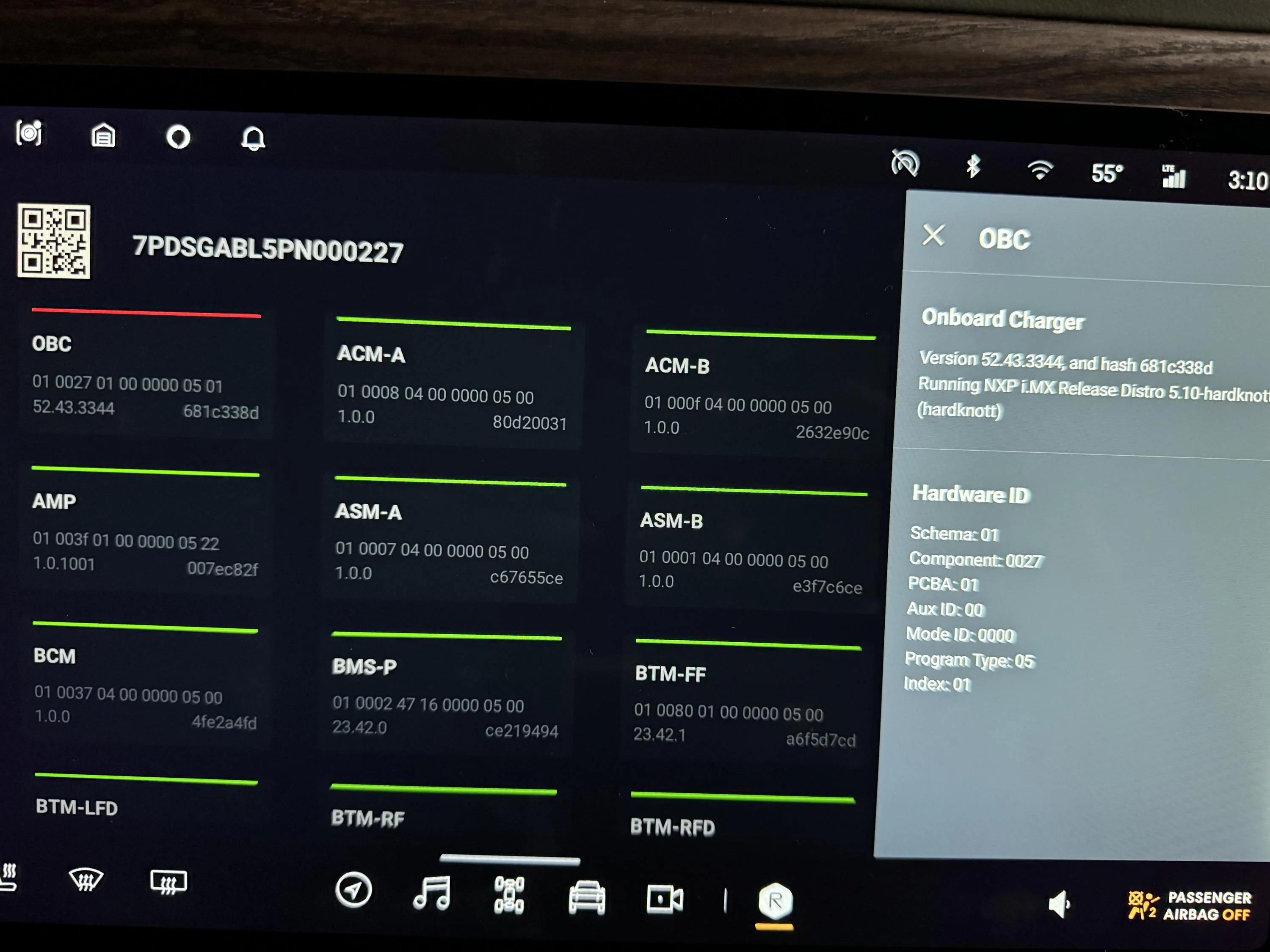

Can someone post a screen shot of the data presented in the RiDE menu?
WAY WAY too much data available to post everything.

Since the cats out of the bag for a moment anyway, anyone have less that 96% battery SOH?
I'm at 95% with 8K miles. Not sure if that's good or bad but doesn't seem good.
Update with charging details:
  • Most of the time charge from 50-70% at home
  • Maybe 20 DCFC charges
  • Have charged to 100% or close to it several times for road-trips, but NEVER let it sit at 100% for more than a few minutes.
  • Never gone below 20% SOC

I was really hoping an alignment readiness option would be present, but that wasn’t the case.
I just had mine done at a regular shop with a tire change, much better than when it went in.

Nope, but you can have Rivian change that OTA. Submit a service ticket and request it to be done OTA.
They told me no. They even told me no on mobile service. It has to go to a service center.
95% of gross capacity or 95% of total usable capacity?
