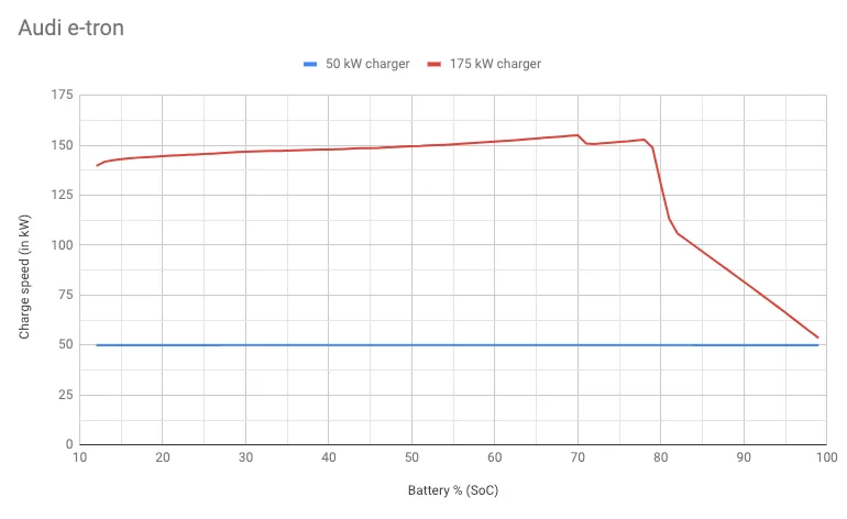

Here is audi:
Rivian R1T R1S Let's talk about charging on long distance travel? audi charging curv

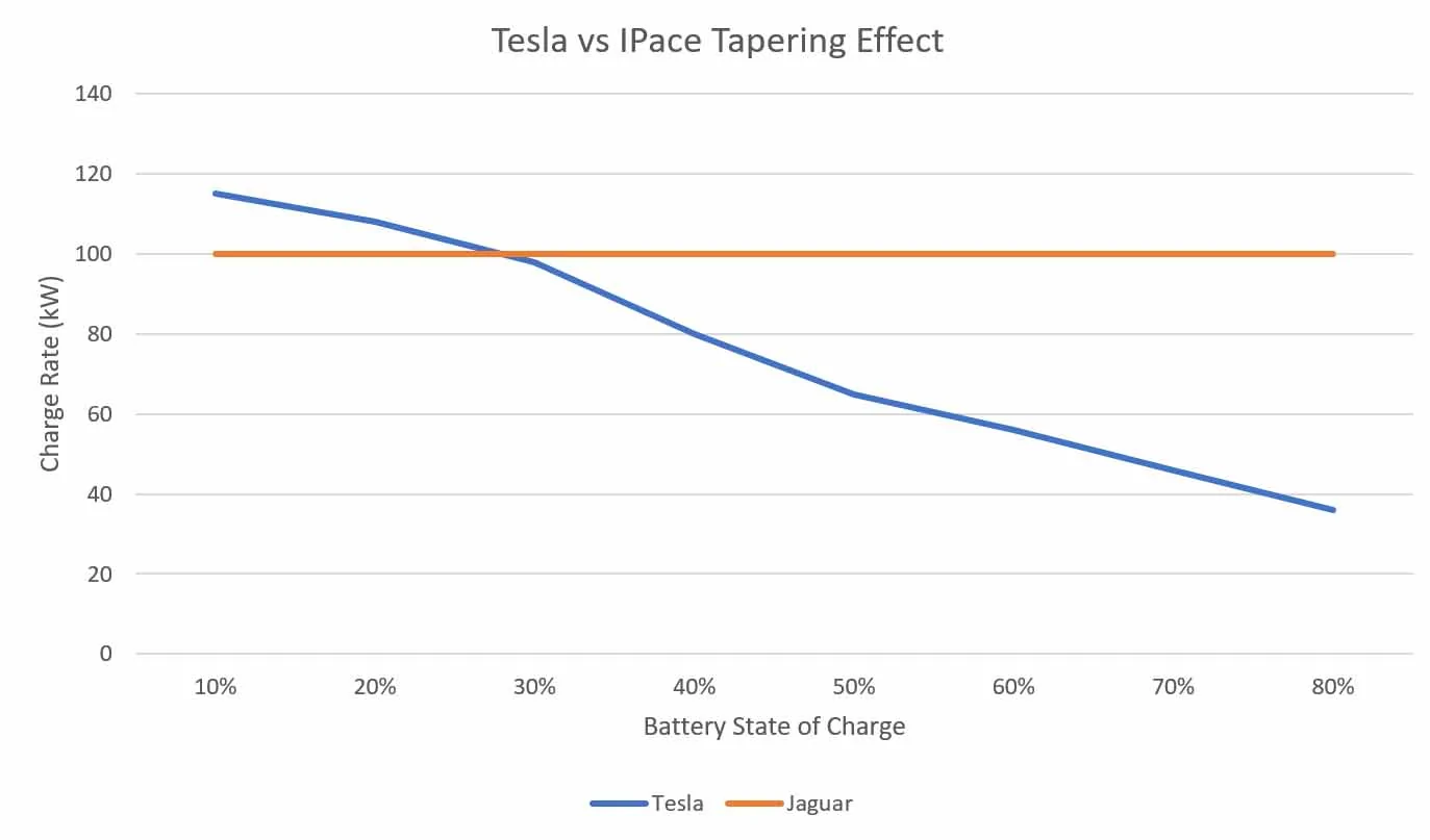

Here is Jag verse Tesla:
Rivian R1T R1S Let's talk about charging on long distance travel? Jag charging curv
Makes one realize Tesla is not years ago of "others"

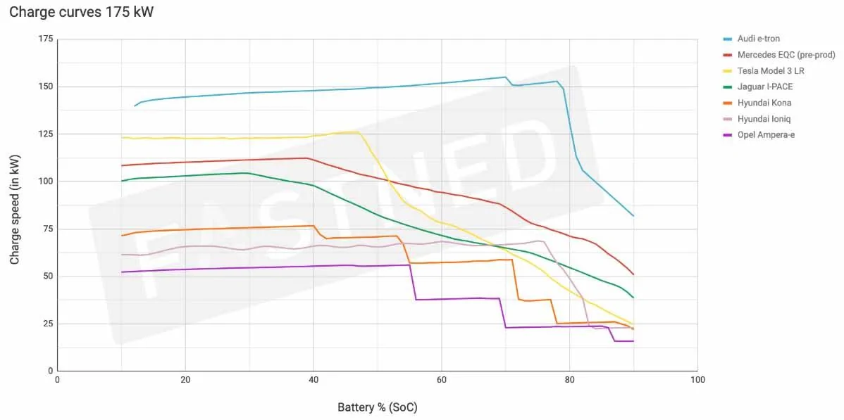

Here is another charging graph:
Rivian R1T R1S Let's talk about charging on long distance travel? charging curves multiple vehicles
Looking for the link for Rivian's charging curve.

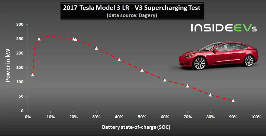

The Model 3 LR will charge at 250 kW, the curves and data you are looking at are out of date.
An 85 kWh battery charging at 250 kW is ~3C.
C is not the battery capacity, but is a measure of the discharge/charge rate relative to it's maximum capacity. A 100 kWh battery charging at 100 kW would be a 1C rate.
The Model 3 LR has ~85% of the X's battery capacity, but utilizes different cells, chemistry, and can accept higher charge rates, The LR can charge at 250 kW, the SR+ at 170, and a new S or X at 200.
I am very familiar with the difference between kW and kWh, and am far from new to BEVs, have organized NDEW (and other) events for many years.

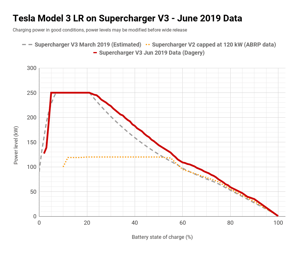

The graph you show above for the M3 is limited by the Supercharger and/or is an older vehicle. V3 Superchargers will deliver 250 kW to a LR M3
Rivian R1T R1S Let's talk about charging on long distance travel? Tesla-Model-3-LR-on-Supercharger-V3-June-2019-Data

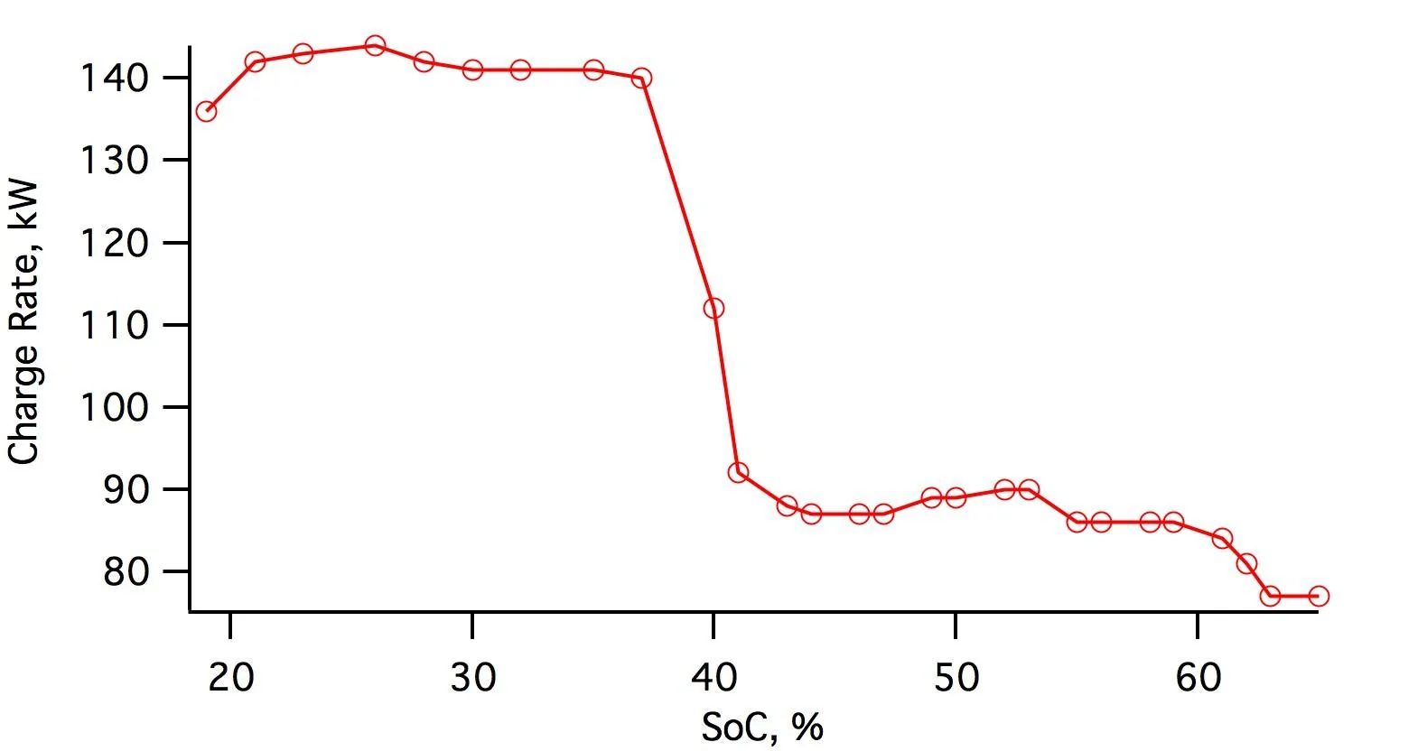

What I really want to do is revisit the question in light of what some of the postings which followed it have revealed
The newest CCS charging stations featuring 150-350kW capacities is neat but at what rate does your BEV charge at? There is a charging curve with the highest levels usually between 10-35% SOC and then it drops. Tesla Model 3 owners frequently report on an average 87kW charge for their rate. What is the Rivian charging curve going to look like?
The answer is still "who knows" but it might be instructive to review how Tesla fast charging works under the fairly sure assumption that Rivian has learned something from Tesla (and on its own). When the car connects to the terminal it handshakes with it, identifying itself to the network. When the network authorizes charging it informs the car of this and tells it how much is available. The car then takes what it wants. This is not necessarily all the charger has to offer. For example, a new X can only take 200 which is less than some of the new chargers Tesla is rolling out. The car has a charging profile. What happens during a charge depends entirely on the profile. New profiles can be downloaded by the manufacturer any time he wants and the car make make move during charging to protect the battery as when, for example, the battery is too hot or too cold upon arrival at the charging station. As an example, here's what I got at the Strassburg, VA SC the other day.
Rivian R1T R1S Let's talk about charging on long distance travel? StrssChg
Time for this charge was 27 min. Average power taken from the charger was 100 kW.
So the answer to the question is that the Rivian curve can be almost anything with what it is for any particular charge session depending on the chrarger, the truck and the weather. In general you can assume some sort of taper. How steep will depend on the particular battery and how aggressively Rivian wants to treat it. Just to give an idea about the implications of taper here is a set of charge time numbers from a 100 kWh battery capable of charging at 125 kW until 47% SoC after which it tapers linearly to 25 kW at 90 SoC.
