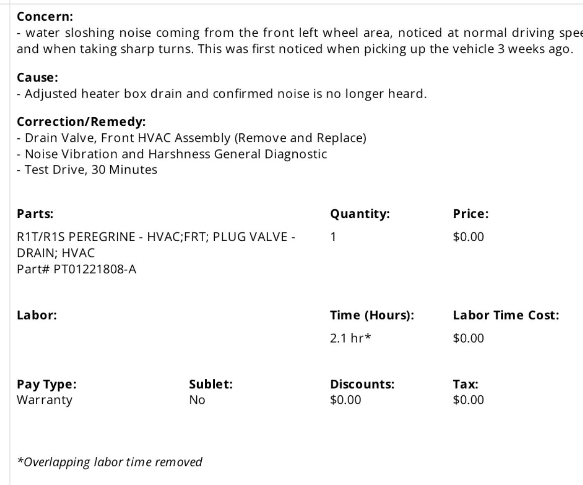

After waiting two months for my service appointment, then 12 days having my car there. I finally got my car back!
Bad news is, this water sound wasn’t resolved. I contacted Rivian to see if they can do a mobile service instead next time around. They resolved 2 of 3 of the issues I’ve reported. But this is what they did to attempt to fix the water sloshing issue.
Rivian R1T R1S Liquid sound when making a fast turn IMG_2680
Looks like they confirmed the noise stopped. Case closed!
This sounds exactly like the drain plug in door issue. I also had the leaky HVAC problem which did not cause any noise (just a smell). It never bothered me enough to proactively have it fixed but when I had it in for my replacement tonneau they fixed the door drains and it has never happened again.
