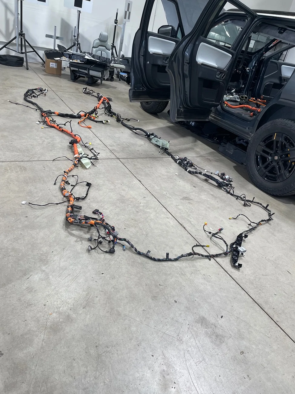

Liquid spill inside trunk disables R1S (wire harness damaged)
