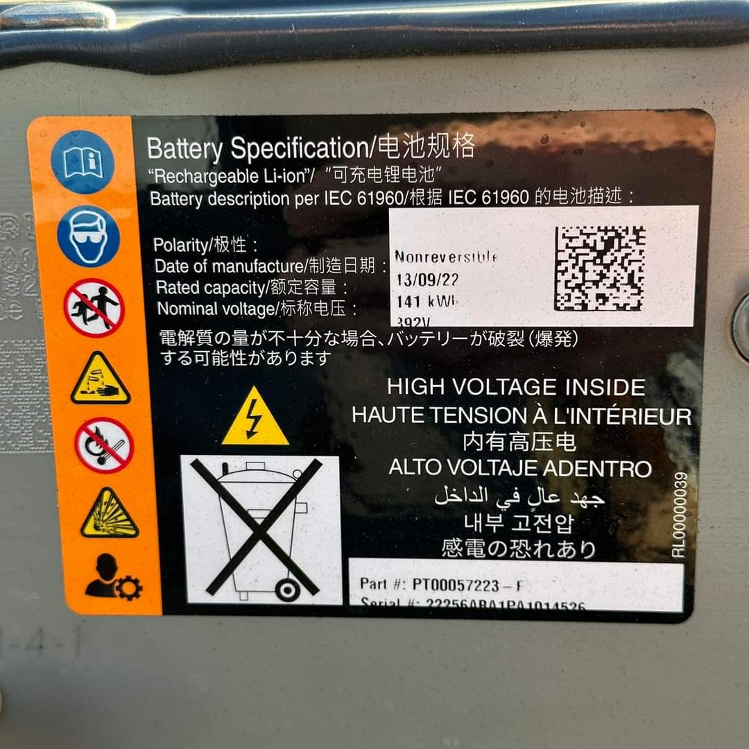

Hi all, just a heads up that the large pack capacity is actually 141kwh, not 135. They use INR21700-50G cells. 18.15wh new multiplied by 7776 cells. It was also confirmed by a blogger as stated on the actual pack. Fairly confident max pack is greater than 149 gross

I posted this on another thread. From a salvage yard selling batteries off crash tested units. Several available.
LG was able to get 10% more capacity for the Bolt EV with a Chemistry change. Those packs went from 60 kwh to 66kwh in later production years. Now with that said, we have this 14 kwh number which just happens to be 10% of the gross capacity of the large pack.
After Rivian runs through the large packs with older chemistry why would they be producing two different packs with two different chemistry? Have one pack and do what Tesla did and nerf one though software?
Wild speculation on my part. If it's 149 gross that means it's an extra 8 kwh. Max pack could be a 155 kwh pack with 149 usable.
Rivian R1T R1S Max Pack Battery Capacity Confirmed - 149kWh 1000002188
Rivian R1T R1S Max Pack Battery Capacity Confirmed - 149kWh 1000002189
