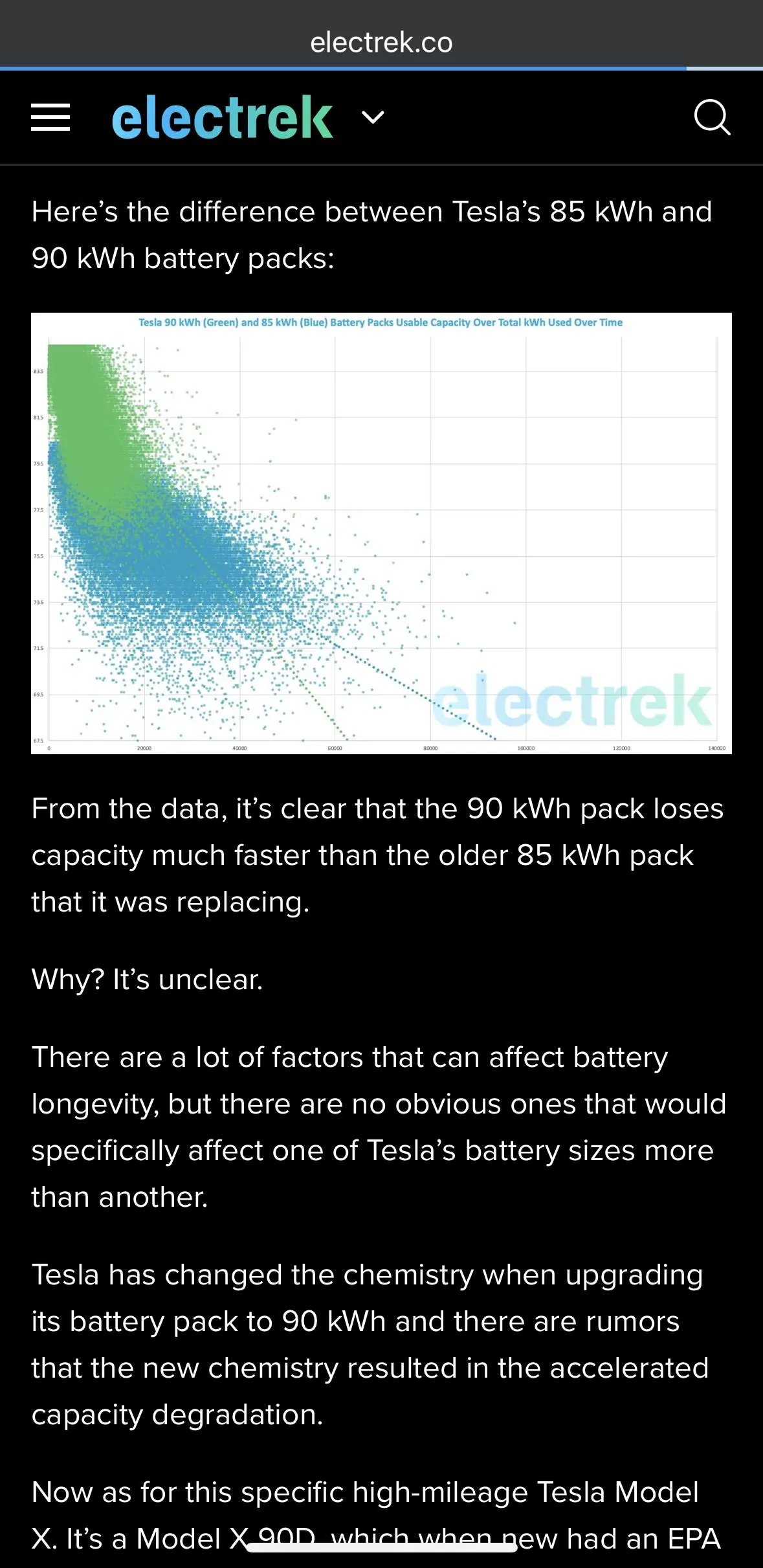

That's also part of the reason I brought it up, is because it actually IS an example of the larger capacity per cell causing worse degradation. I don't know what they did when they went to 100D, but I haven't heard any problems with those.
That’s because the step change increase from 85 to a 100 kWh battery pack was a complete redesign of the battery pack, not just inserting higher density cells into the existing design (Rivian is doing the latter with the Max Pack).
They added more cells.
Supratachophobia
Apr 8, 2023
1,785
2,131
Ohio
S
So, does the 100D have similar degradation to the 90D over it's life?
Nope. It's arguably the best pack they've ever made. Both from performance and reliability, but also longevity. It should also be noted, it's using those old reliable 18650 cells.
