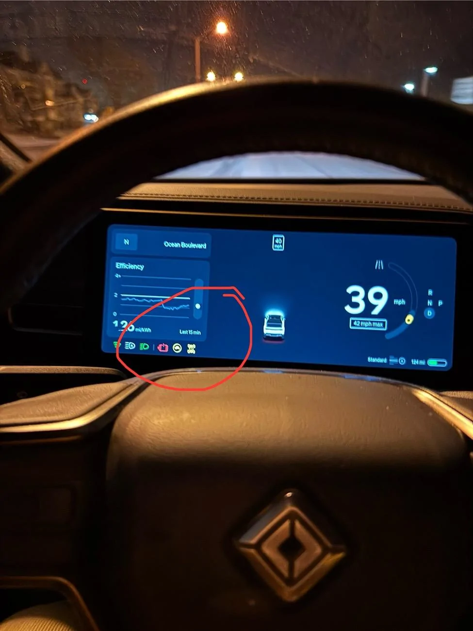

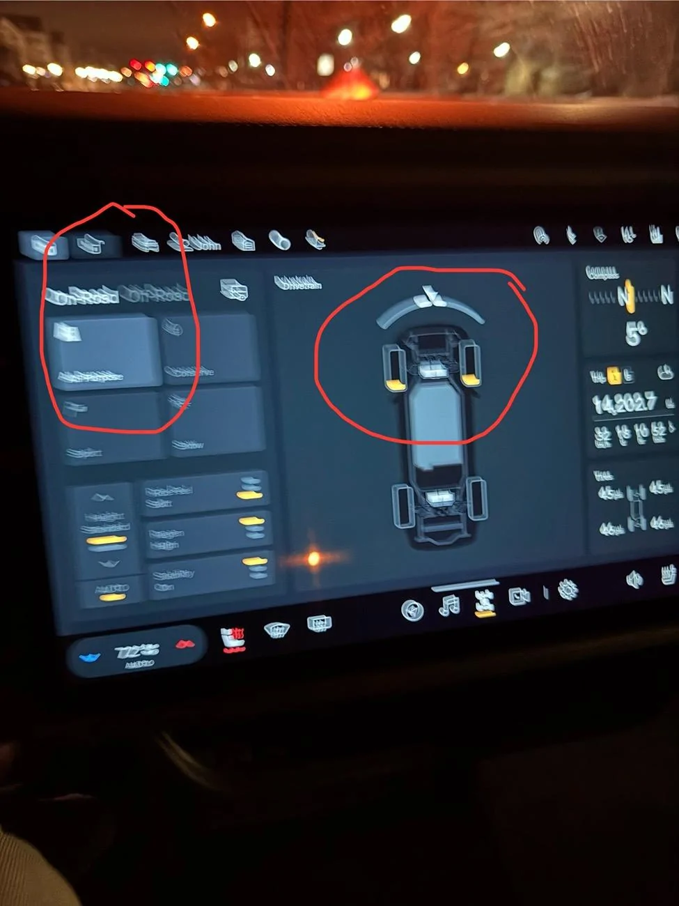

I just had the same exact problem with my 2023 Gen 1 R1T Quad. Got in to drive home from work and as soon as I started driving I got the “Motor Failure Detected” message and it said “Max Speed 42”. A bunch of warning lights were illuminated at the bottom of the dash. A red motor one, and two other yellow ones. Also, when looking at the vehicle dynamics page it showed the rear wheels were not driving or regenerating, just the front, but it was in All Purpose mode which would drive all wheels. I tried switching to Conserve mode (FWD only) but it said get service before changing modes. I drove it 10 miles home this way, and would accelerate very slowly, then cap itself at 42 mph. Once home, I tried a soft reset and it came back fully normal and remained so for a 5 mile test drive. Fingers crossed it’s OK tomorrow as I need it to get to work. It was also fairly cold here and it was outside all day in 16 F temps.
Rivian R1T R1S Motor failure message IMG_1484
Rivian R1T R1S Motor failure message IMG_1485
Thanks for thinking to take pictures. I may use them when I talk to the service center. I was so focused on calling roadside assistance and restarting so I could get off the shoulder of the highway that I didn't stop to take pictures either time it happened.
Edit: Not sure if it matters for figuring what the defect is, but I'm also a 2023 Gen1 R1T Quad

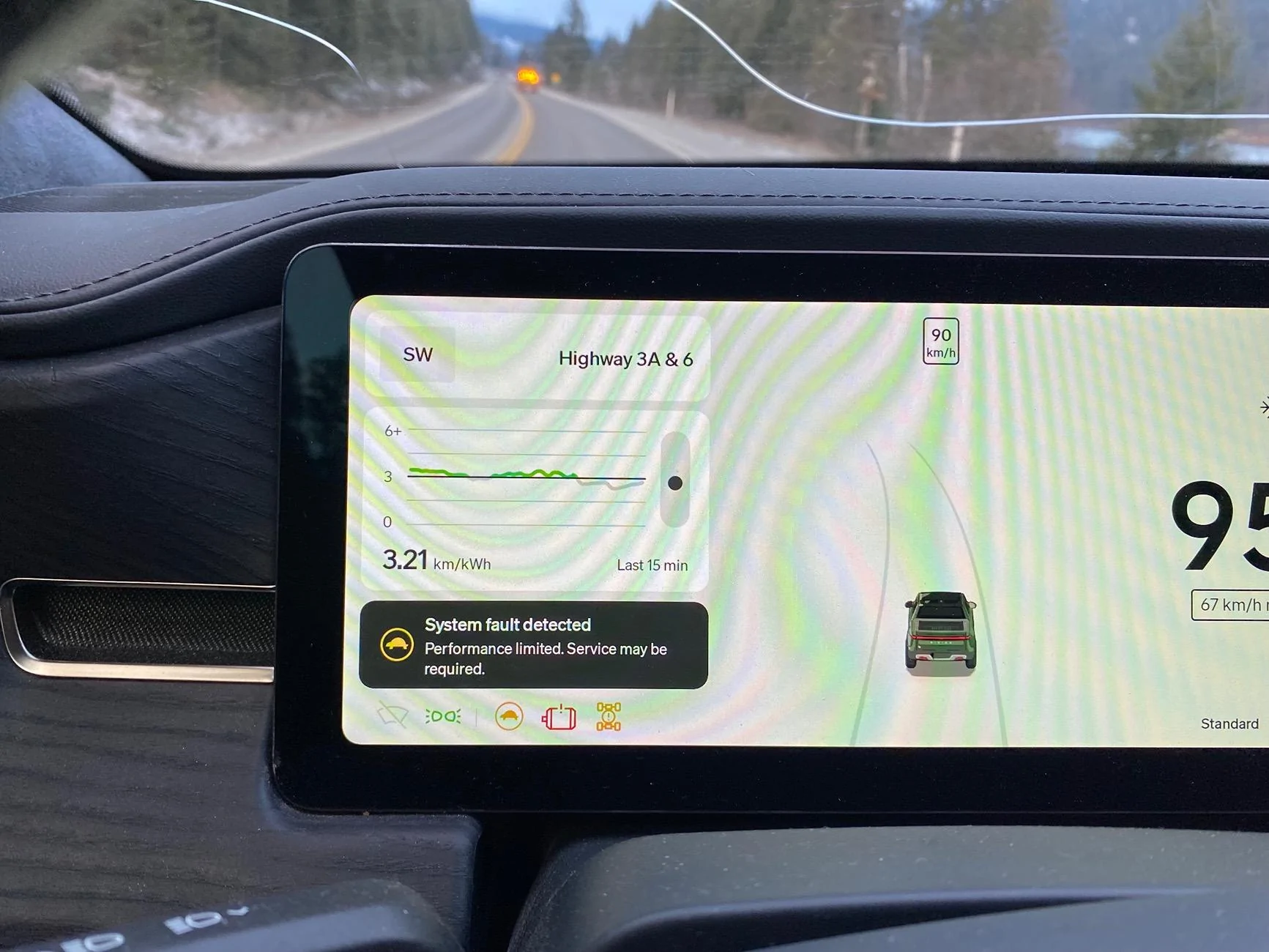

Ugh, I just experienced this today in my May 2023 build quad large. I was at highway speed, 20 mins into my commute to work, when I received the red message indicating motor fault, which changed pretty quickly to 'system fault detected' and it limited my speed to 67 km/h (42mph). I was able to pull off safely and put it in Park, then called Rivian. I noticed the codes had cleared as soon as I put it in Park, and put it in gear with no messages showing. They had me reset anyway and stayed on the phone with me for a few minutes while I drove it. Said that when this happens, if it doesn't show up again, they don't pursue it, but have a record and the logs.
Rather than drive to work (another 45 mins away) and possibly get stranded, especially with the pack fairly low (I was planning to use an L2 near work), I turned around and headed for home. No issues trying various speeds, going slow, going fast, using Conserve mode. Plugged in for the day and drove it another 30 mins this evening. I work from home tomorrow and Friday, so I will at least get a few days to see how it is working before I have to commute back to work.
I'm hoping this doesn't turn into anything, as we are supposed to leave on a trip to Utah/Arizona for 4 weeks in mid-March! My nearest SC is several hours away, so it would be hugely inconvenient... but I think Calgary is still new enough (i.e. not that many vehicles to service) that it might be a relatively quick turnaround compared to some in the US.
Wish me luck!
Wish me luck!
Calgary when I wa there was fairly busy but I would reach out to them for piec e of mind
