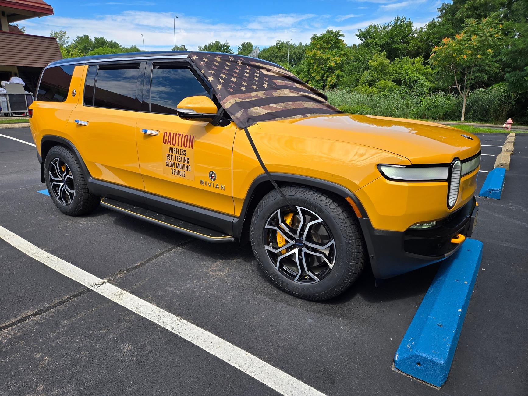

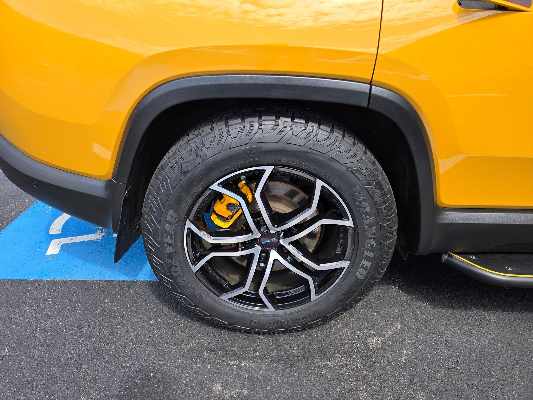

FWIW, After 40k miles & two sets of OEM 21" Pirelli's Tires & Rims & the discontinuation of the 21" Road Wheels (and most tire selling locations have noticed the discontinuation of the 21" Pirellis & jacked the cost past $525 per tire...), I just order from Tire Rack & had a local shop in Massachusetts install these, Radius WI35 20" Rims & the new R1S Gen2 OEM Tires (Goodyear Wrangler AT for $255 each vs $525+ for Pirelli) and with 900+ miles this past week, so far, so good. I expected more road noise due to the tire pattern difference & that's what I got. We'll have to see about the tread life as there is none listed :cool:
Rivian R1T R1S Need tires, decision paralysis. 20240811_112440
Rivian R1T R1S Need tires, decision paralysis. 20240811_112455
