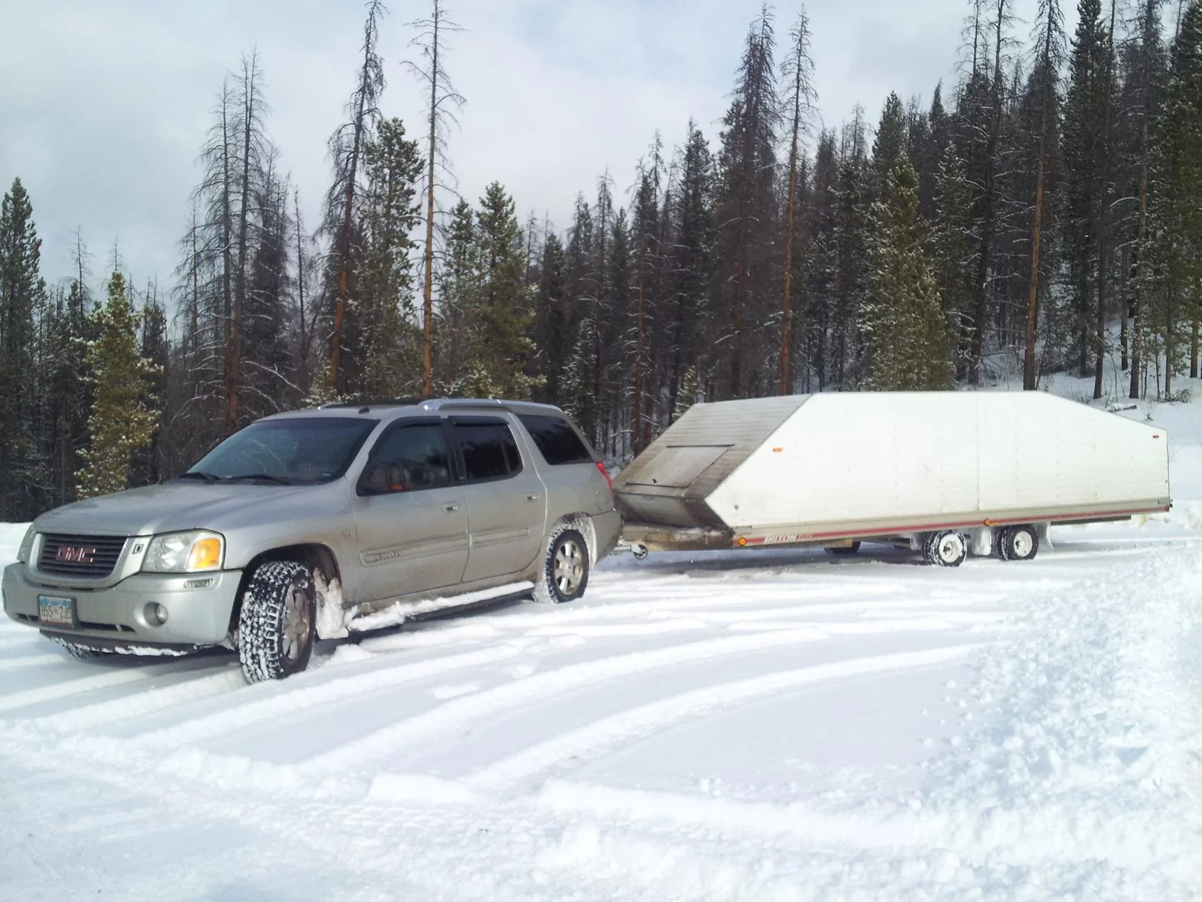

I have been running the Michelin Defender LTX M/S on my vehicles since 2005(ish). On my 3rd set of them on my 218k mile GMC, which I do light off road with, and trailering while light off roading. Never had a case of want for traction. They are EV-Rated.

When it comes to the Michelin Defenders, I dont put a lot of faith into the 3peaks. I have towed, off-road, in deep snow (like I couldnt open my doors), and not had an issue. Backing up a trailer, uphill, on snow pack, no issue. I know its important to some, but in regards to this specific tire, I have no issues.
I will grant you only one caveat. My GMC Envoy has a locking rear axle. Still has a open front axle thou.
Edit: Picture of truck with Michelin Defender LTX M/S, loaded trailer at the bottom of the mountain going up to the Grand Lake Dam..

Love that setup in you picture! Great to hear your experience in snow. I'm in SoCal and only have to deal with snow if I go snowboarding for the weekend. I am leaning towards these Michelins as my next set of tires.

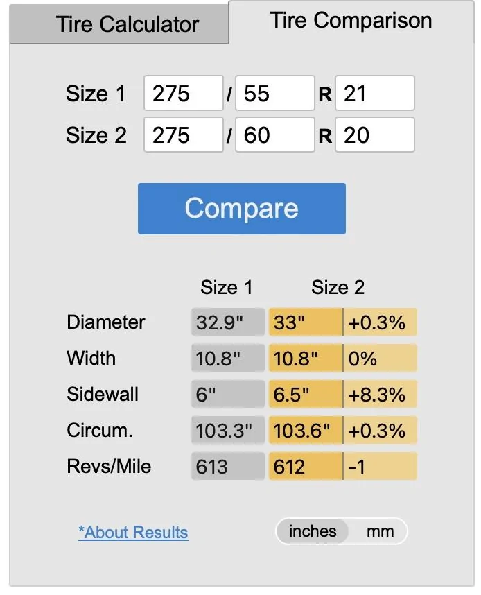

I'm not as I have 21's as well(UGH)...Waiting for the one we're all waiting for or going to 20's myself for the 275/60-20 option Michelin Defender LTX M/S2
There isn't a 275/55-20 option.
Would the 275/60-20 option put our speedos even further off in the wrong direction?

275/60-20 is essentially identical to 275/55-21. Also don't need to have Rivian mess with anything.
