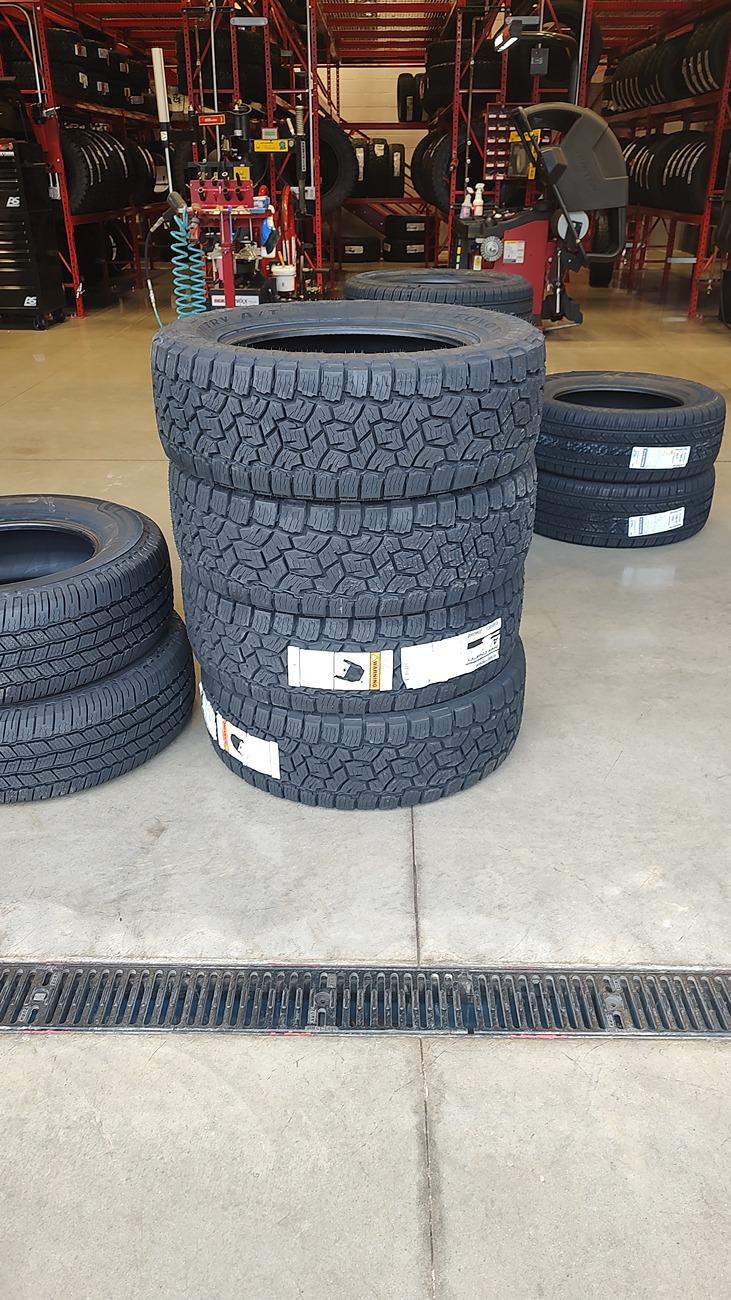

Give a couple discounts a call tomorrow. Talk to the manager and I’m sure you can get the Toyo. FWIW I paid $409/tire. I’ve always used discount as well. Also, you can bring the tires you order there to be mounted no issue, that includes the rotate and balance for life. If you’re on the fence buy tires from them so you can deal with the dealer replacement easy provided the manufacturer offers it. I know Falken and Toyo both do.

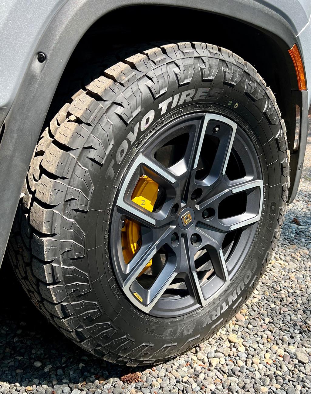

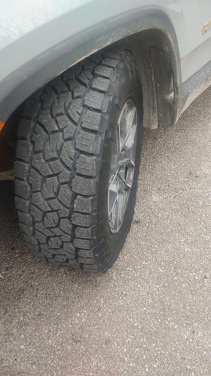

I have 15k on the Toyo OC AT3s (EV version wasn’t available yet). About 5% range hit vs the Pirellis for me (2.22 m/kWh avg). I’ve been happy with them, they have gotten a bit louder as they’ve worn but nothing like the Pirellis were. Highway handling is maybe a slight downgrade vs the originals. Off-road performance is great and they are wearing better than the original tires as well.

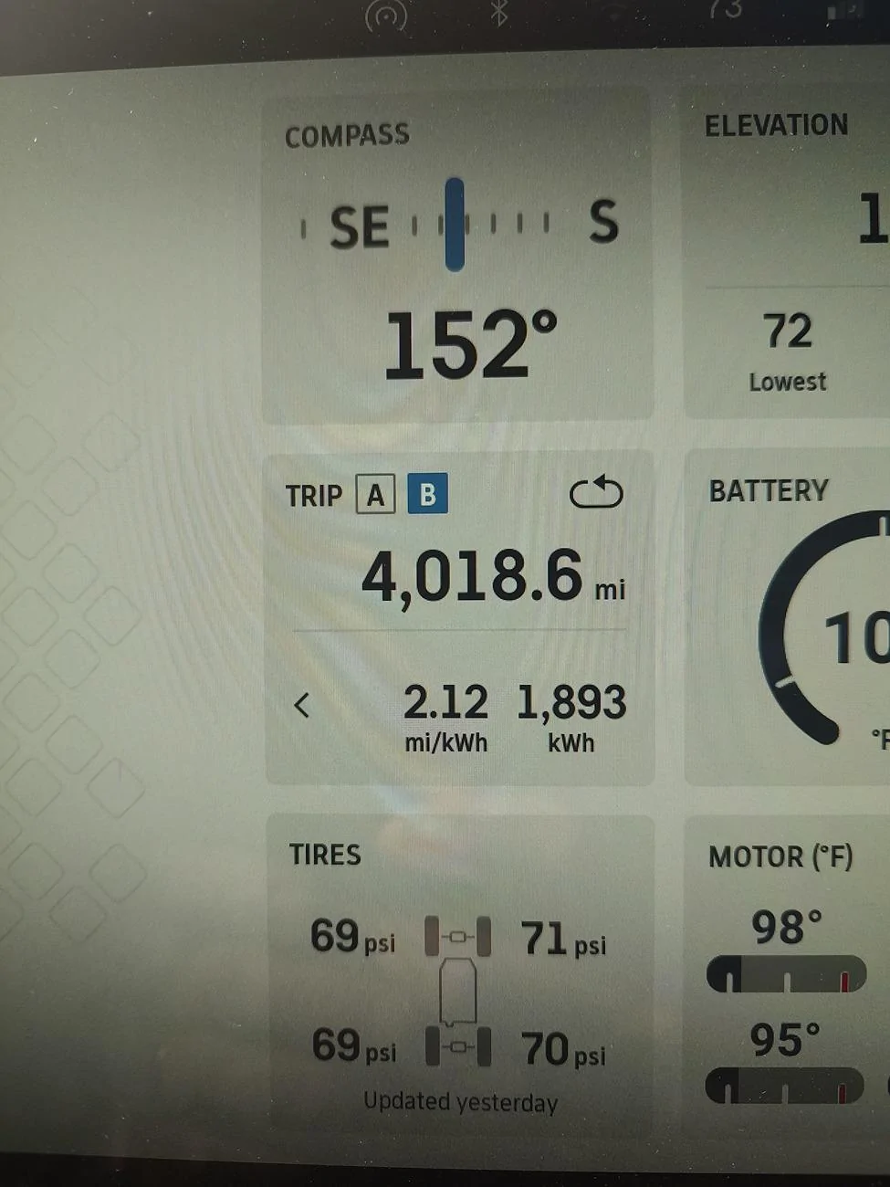

I installed the Toyo Open Country AT3s, LT 126 tires, 14,000 miles ago, and can't say enough about them. Yes, they are ~11 lbs heavier than the Pirelli tires, but highway efficiency is actually better than the stock Pirellis, and the around town efficiency is pretty much identical. We recently did a 4,000 mile trip from VA to CO, and averaged 2.12 m/kWh, including ~500 miles above 80 mph, and 250 miles off roading in CO. On highway trips, 66 psi seems to be the sweet spot for efficiency. The wet, dry, and snow traction are much better as well. I am hoping that being heavier load index they last longer than the Pirellis, and based on 14,000 miles so far, it seems like they will (I got 24,000 out of 6 stock Pirellis).
