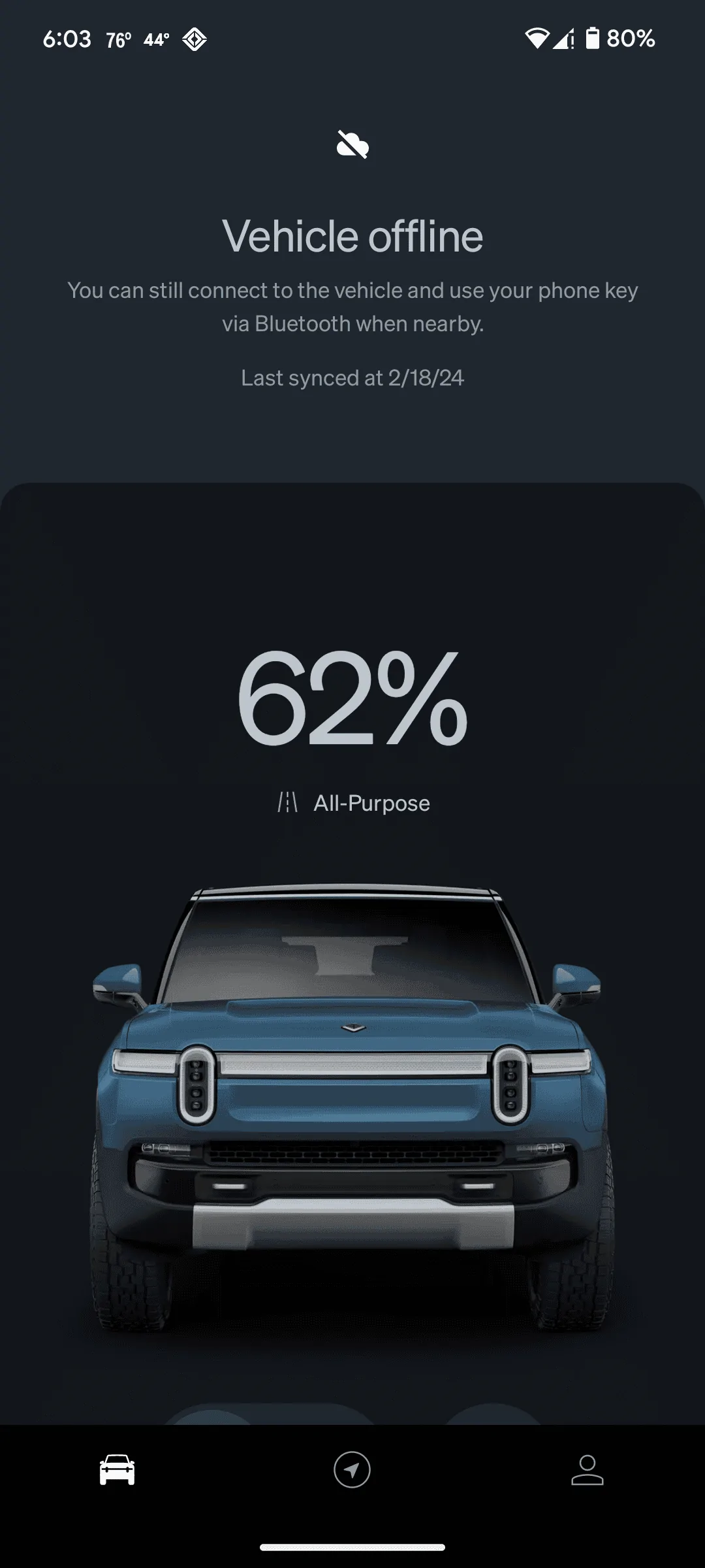

We have an R1S, received 9/15/23, VIN ~20k. It has a single 12V battery, no capacitor. (I checked when the mobile service tech came to replace the center console to remove the camp speaker).
Last week, while I was out of country for work, my wife got the dreaded "service 12V battery" light. She called Rivian and they remotely checked and said everything was fine. Light stayed off a few days after they had her do a hard reset. The morning after I got home, immediately on unplugging the wall charger, we got the "service 12V battery light". Since it had been plugged in all night and was at 70%, and church was only 2 miles away, we drove to church. Afterwards, the light was off. We drove home, ran an errand, no issues. Since it was at 65%, the kids were out of school Mon for Presidents Day, we left it unplugged, in the garage, and it is bricked.
I noticed the next morning when I checked the app from work. (Current screenshot below) Rivian asked all kinds of questions about the temperature, etc. they are supposedly sending a mobile service tech today (Friday). We are fortunate that we have other vehicles that we can wait a week! I tried using a trickle charger through the jump start wires in the rear to see if we could unlock the doors and maybe get some things out - no luck. (Charger says "bad battery ")
So the software update that gives the early warning might have worked, possibly, but Rivian remote service said everything was ok... Not sure what to make of that.

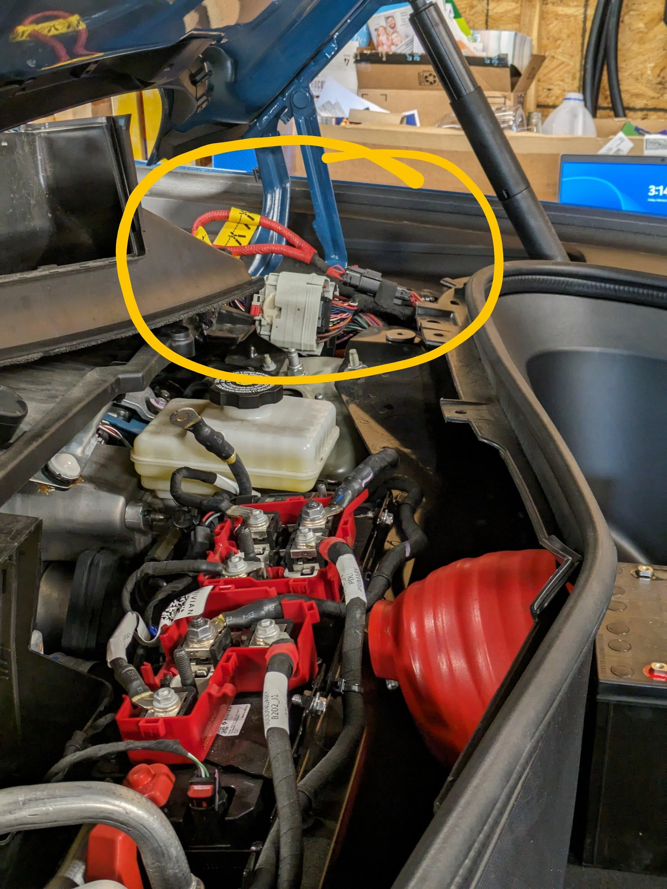

Mobile tech replaced the 12V battery in under an hour. He said he prefers accessing by removing the 6 fasteners in the driver wheel well and unlatching the frunk manually rather than trying to jump it via the rear cables. (Which is what we did).
I asked about jumping from my Tacoma. He said he wasn't sure if it would work or if it was recommended or not. I haven't heard back on that yet. He was newer.
Our R1S only has 1 battery. They are not yet commercially available, so it seems a service call is currently the only option for replacement.

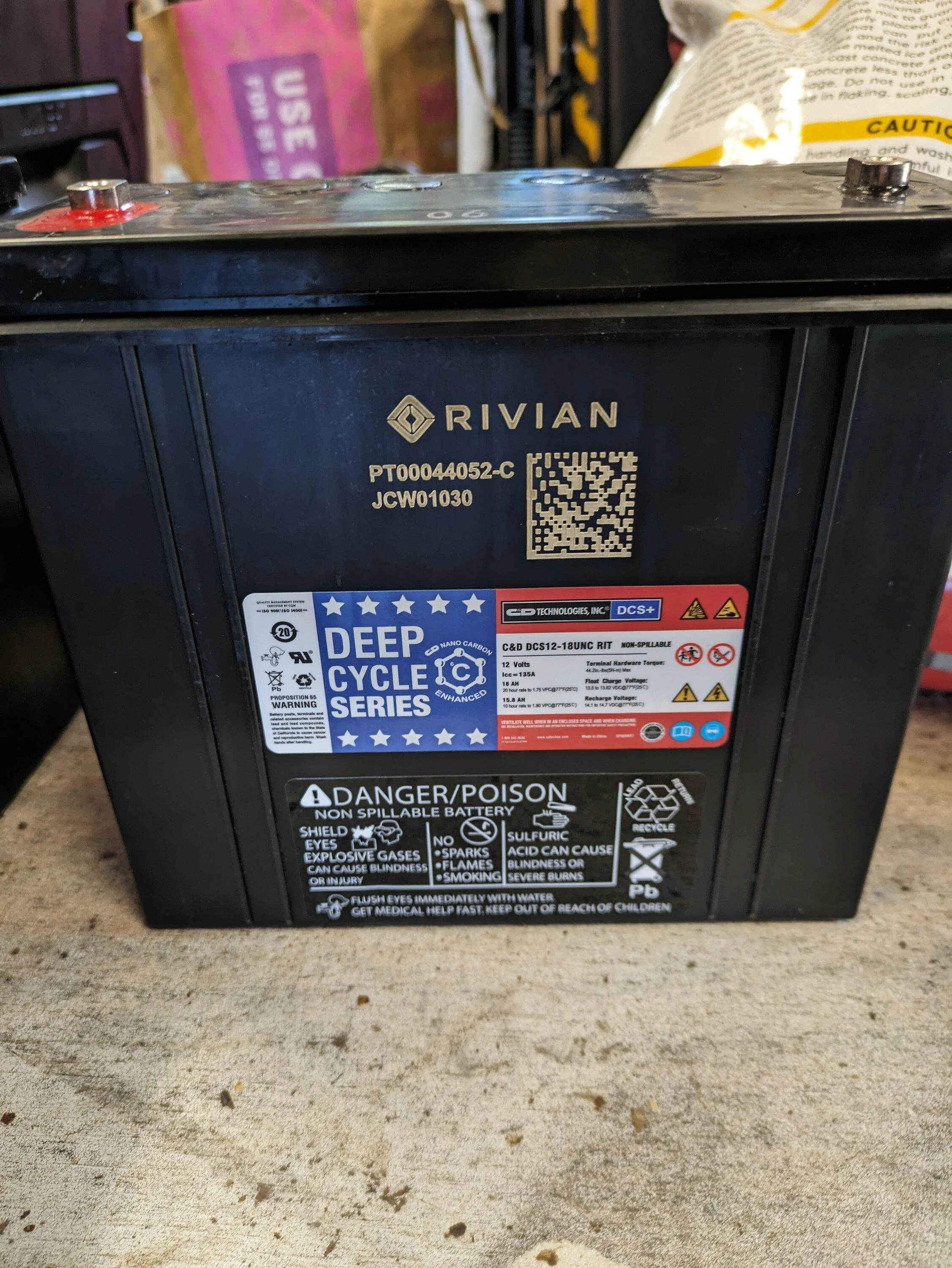

It's an 18ah AGM battery. Pretty common.

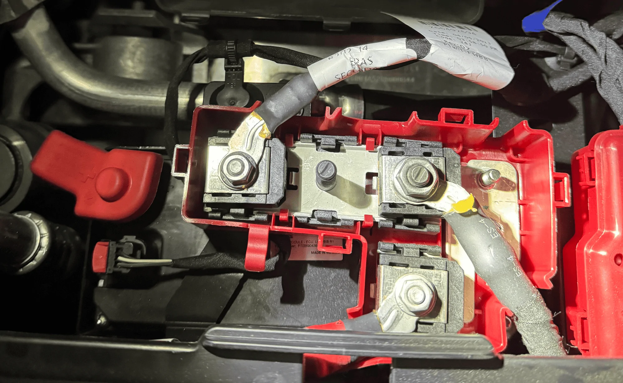

Looks like Rivian finally updated the jump-starting guide to indicate how to jump the vehicle including the secondary battery.
Will be curious if people are able to recover their dead vehicle following the guide now. Present in the tow-operators guide and owner's guide.
https://rivian.com/support/article/r1-tow-operator-guide
The terminals on my R1S secondary battery do not look like the terminals in the diagram (see photo). Should I assume that the battery was just installed 180 degrees rotated from what I'm seeing here? I'm assuming if I'm jumping this battery, The red cables are + and black cables are - and I should go by that system vs. the diagram in the manual. Any help is much appreciated.
Rivian R1T R1S "New" 12V Battery Jump Start process update from Rivian Rivian R1S Secondary
