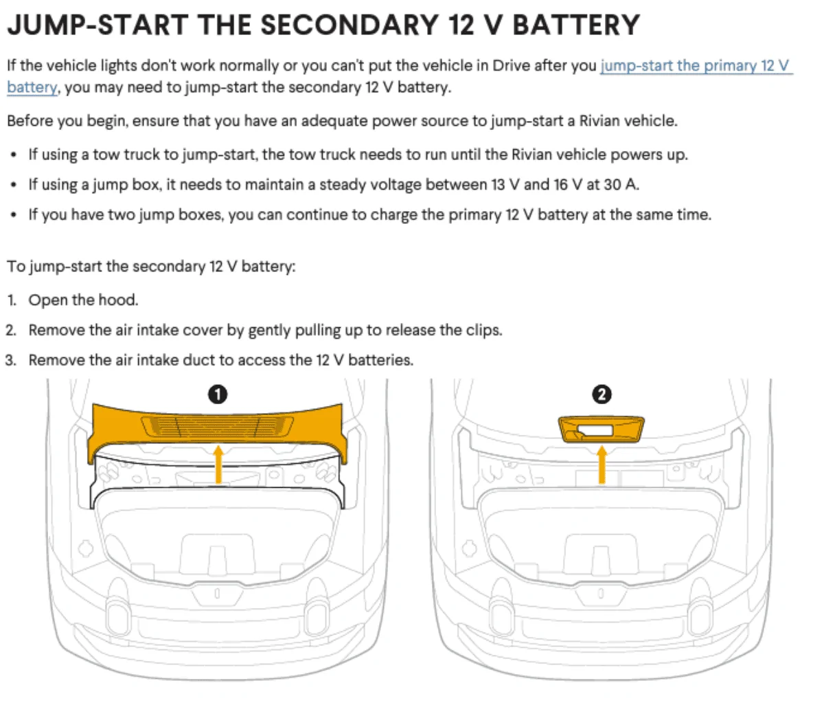

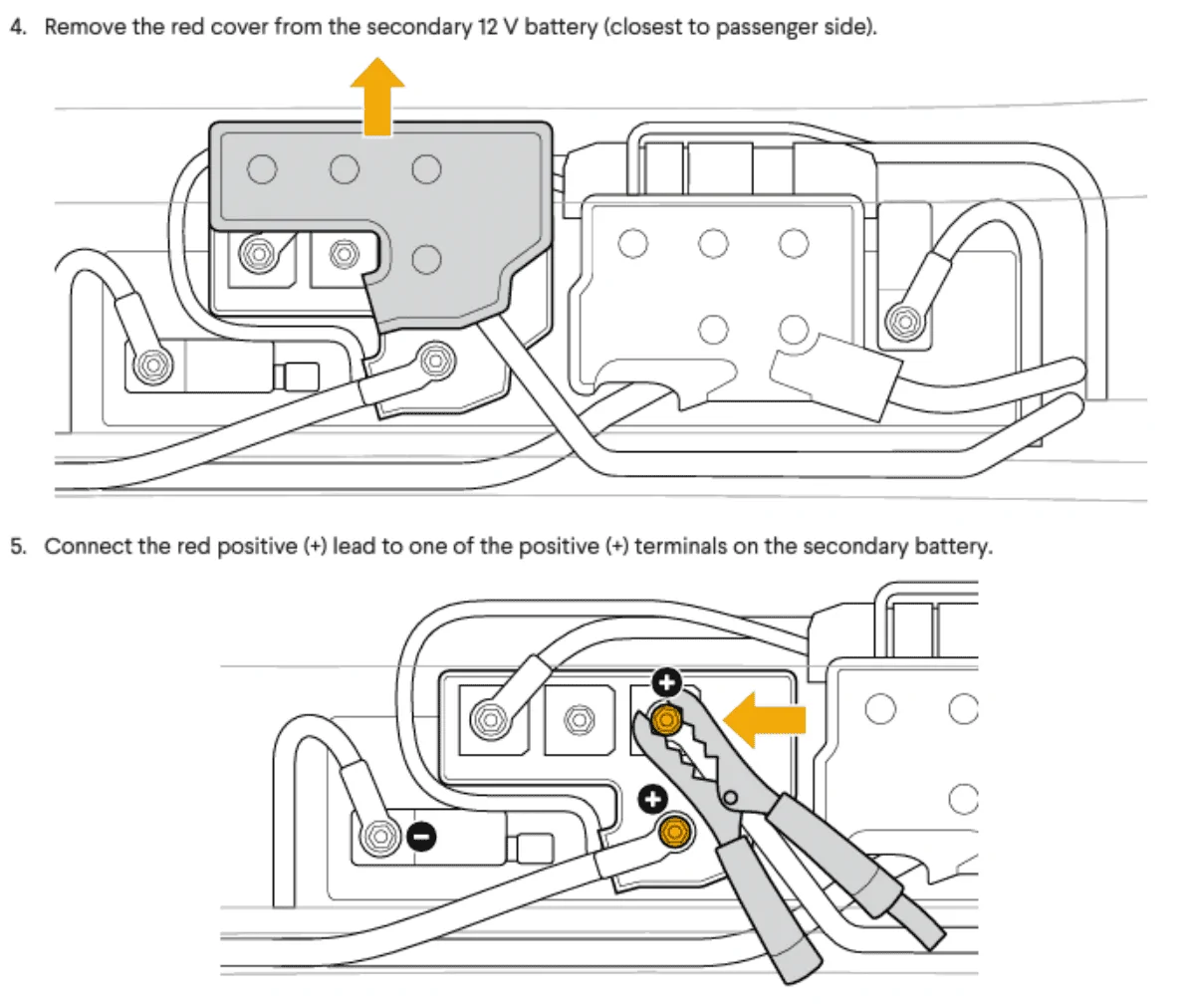

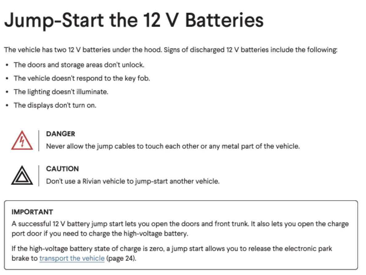

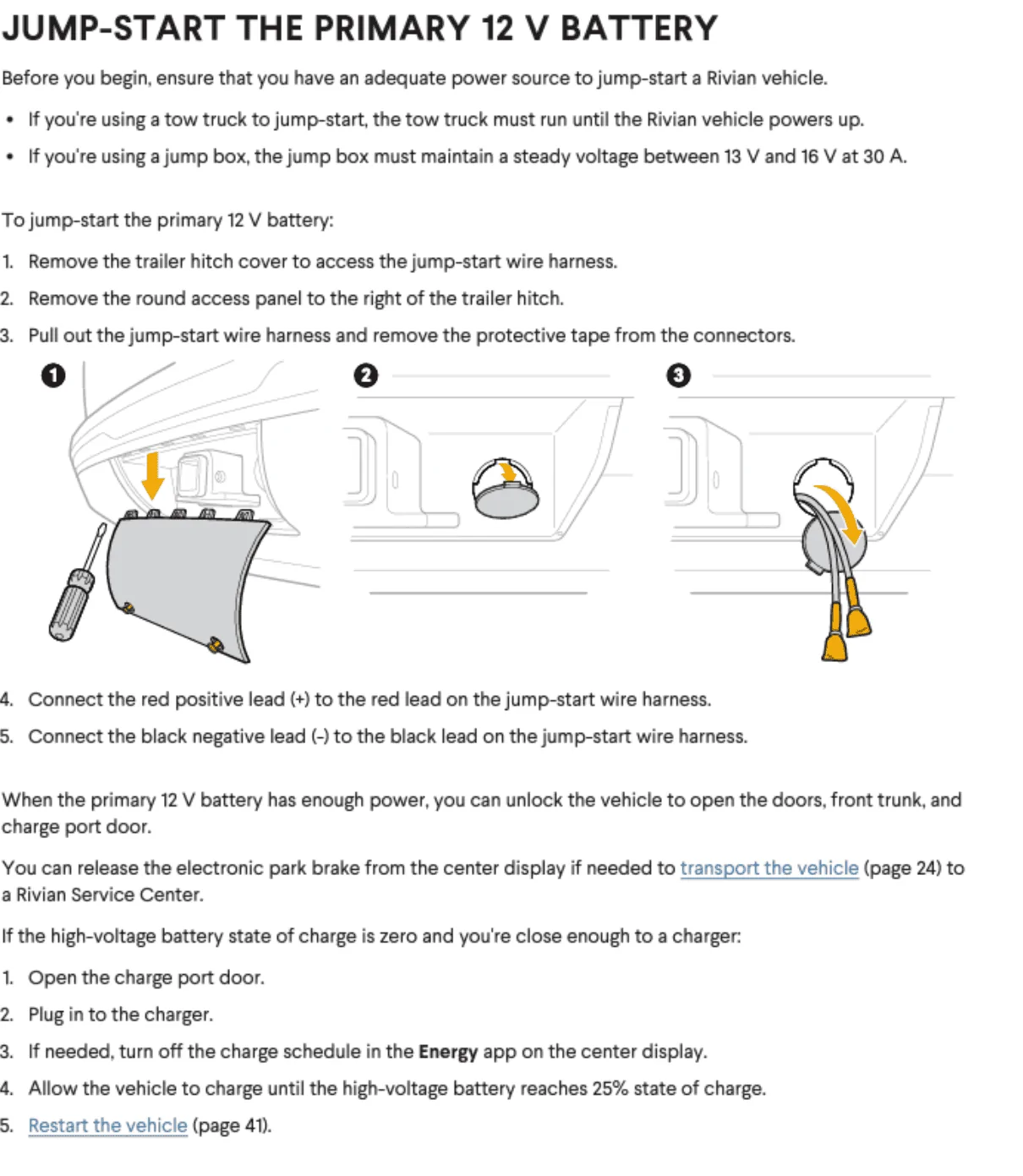

Looks like Rivian finally updated the jump-starting guide to indicate how to jump the vehicle including the secondary battery.
Will be curious if people are able to recover their dead vehicle following the guide now. Present in the tow-operators guide and owner's guide.
https://rivian.com/support/article/r1-tow-operator-guide
Wait a sec, There were reports of one battery and one capacitor in place of 2nd battery..... what gives?!

I'm a newbie with a question. How to tell if my 3-week-old R1T has an older 2 12v battery system or does it have just the one and a capacitor? The nice guy that hauled it out to me didn't really answer that question. He just showed me where to get to the leads beside the hitch in the rear. So if it now only has one 12 v battery, where is it?
