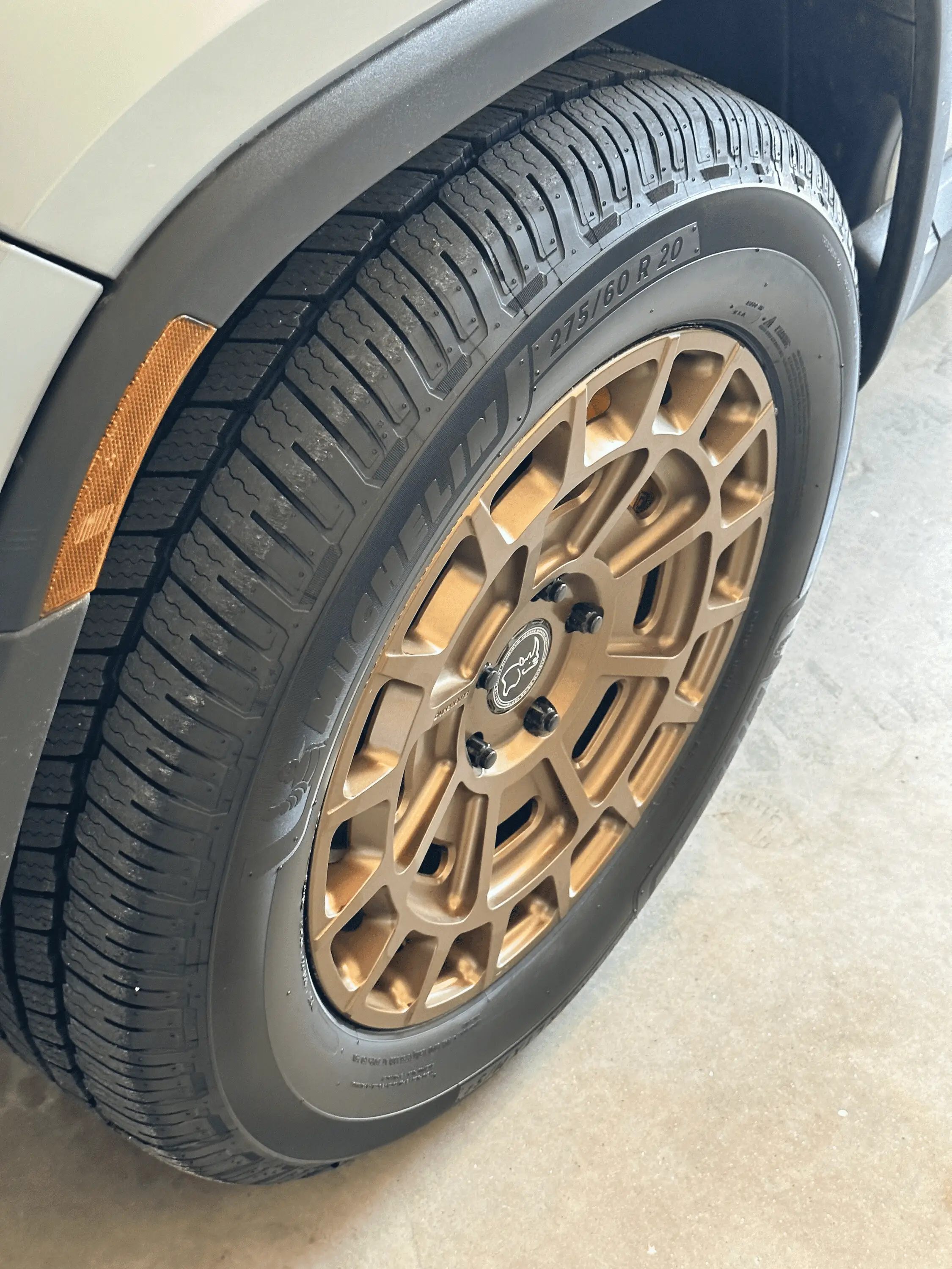

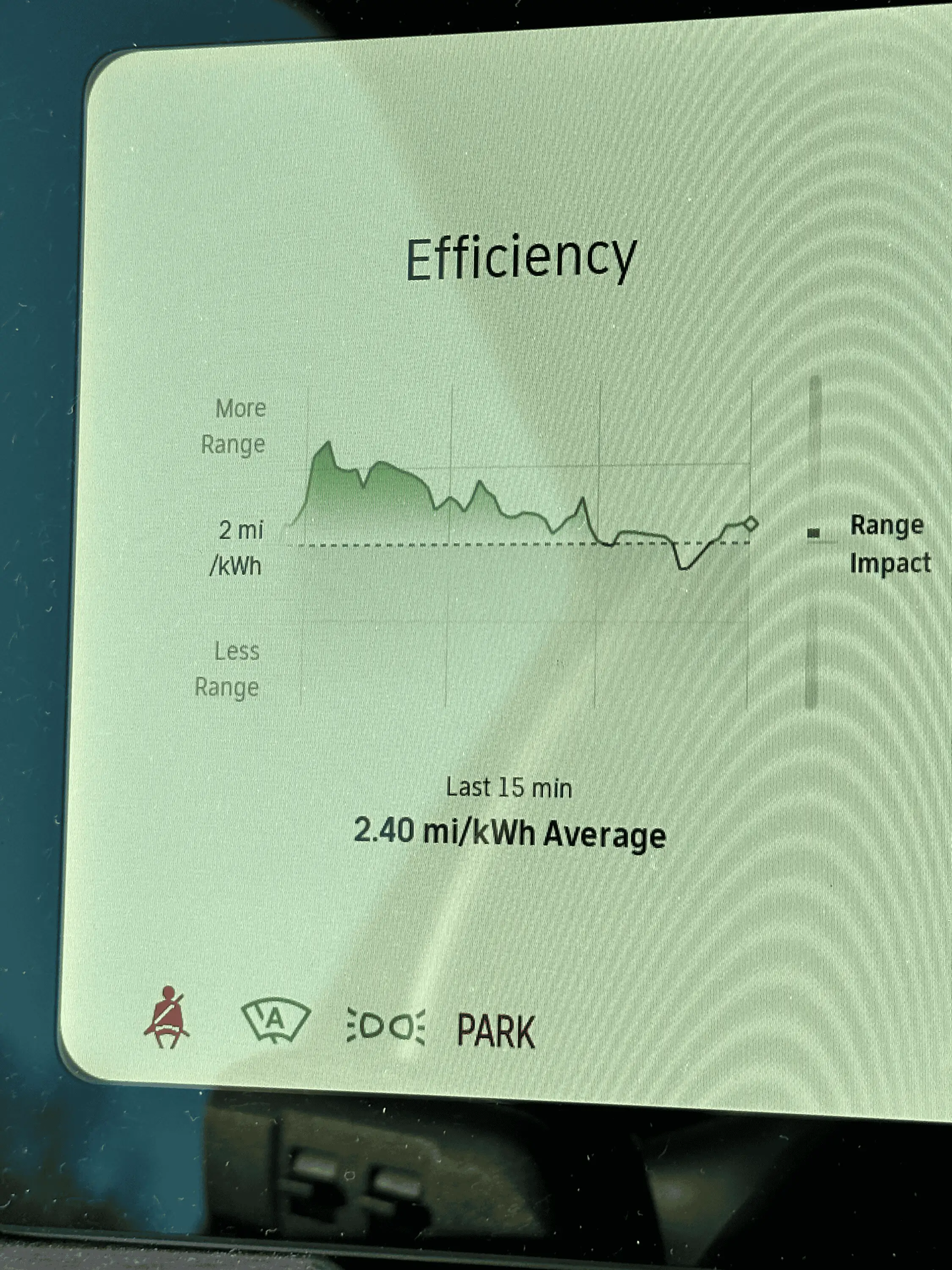

Put me down as another happy owner of the Defenders. Running the 275/60r20 48psi on Black Rhino Votaic rims. My car originally came with the 22s. These tires have a lot of the same road performance of the OEM 22s, but with a more comfy and sometimes bouncy ride. I'll take a little bounce any day over a low profile tire slamming on bumps.
Efficiency has been great as well. Prior to these tires I had 20" Cooper All Terrain which were getting around 1.6 on my afternoon commute. The Michelin's got 2.4. I have no doubt these will continue to perform well and net 330+ miles on a full charge in conserve mode on trips. Will be taking an 8 hour journey in a few months which will put them to the test.
