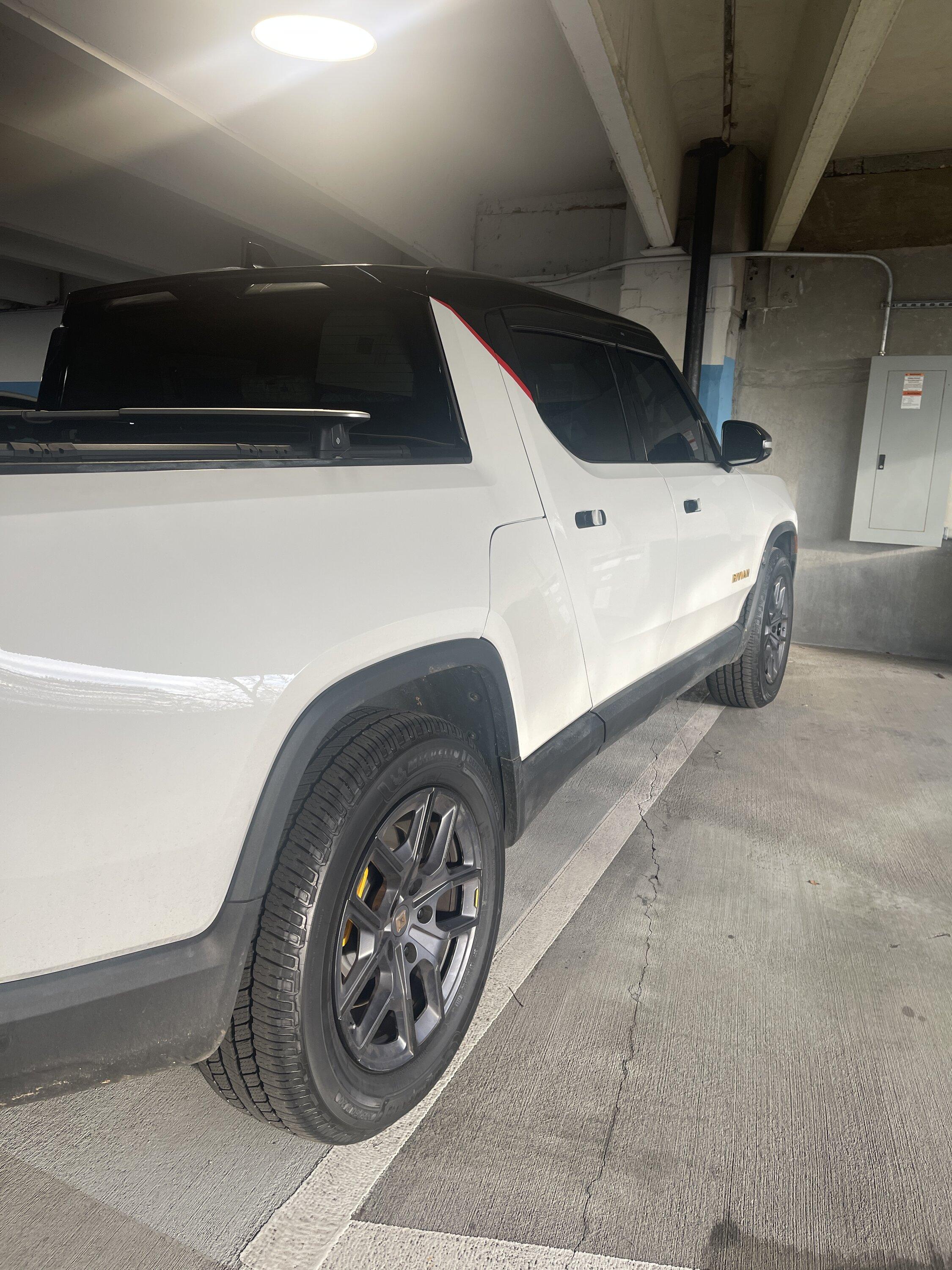

Well, today I did 2.6 miles per kw on all purpose!. I’m attaching pics at your request! Incredibly split and quiet!
Looks great! How does 2.6 compare to another similar 15 minute interval on your truck?
Sorry if it’s already been asked…so did you drop down to the 60 series tire? So a, 275/60/20 vs original Perilli was a 275/65/20? If so, that explains a lot…the 60 is slightly smaller (more efficient) and the Michelin in that size is 42 lbs vs 57 lbs for the OEM tire, both factors are significant and combine them, lighter tire and small diameter equals the great results your seeing.
That’s correct. That’s what I was expecting and now maybe I can tow for more than 130 miles. If I get half, that’s 1.3 vs the 1 that I used to get. The efficiency should be greater towing.

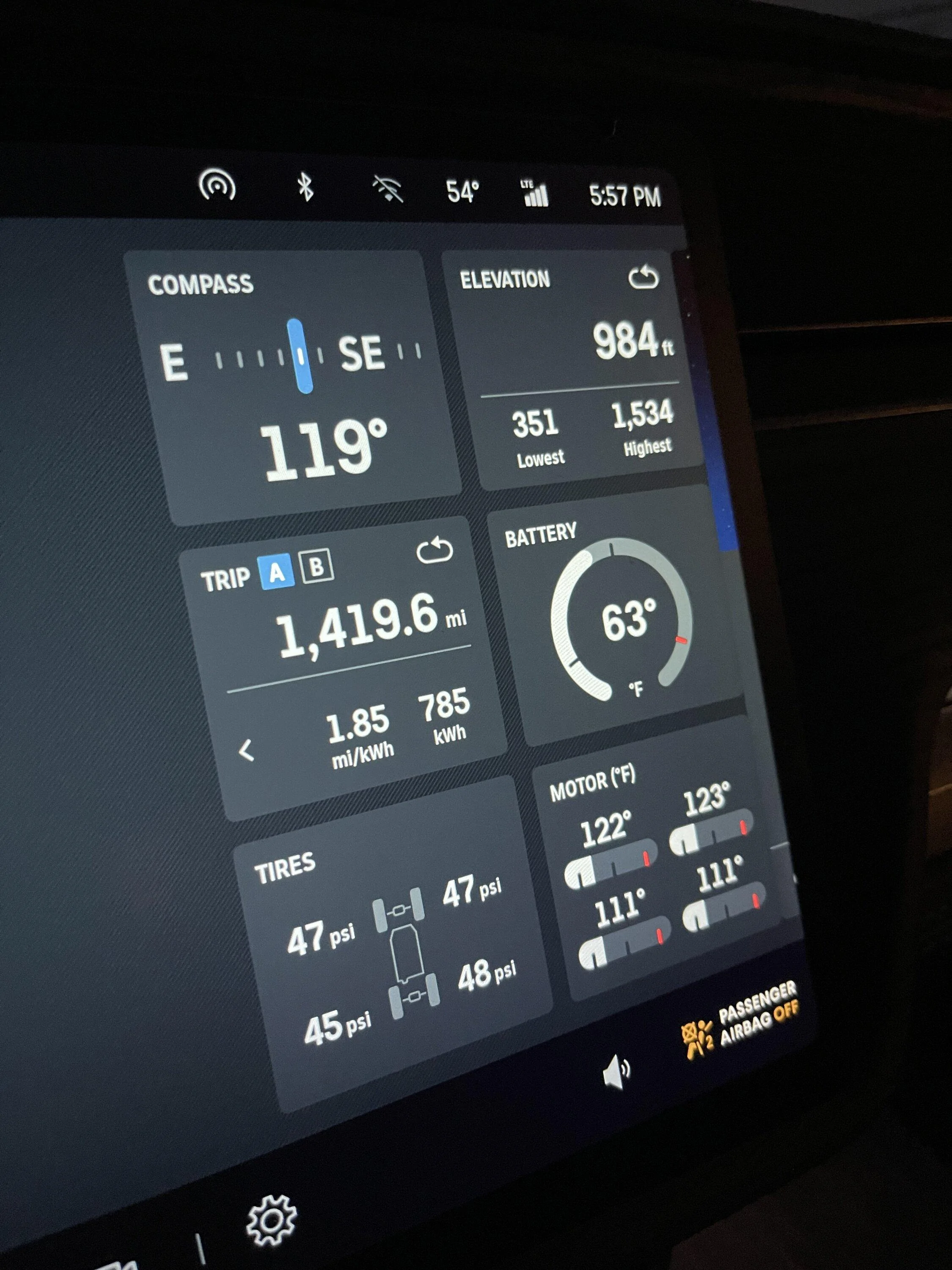

Have you used your trip meter to check these numbers? I'm sure it's still a strong improvement, but trip meter is more accurate than the efficiency-on-the-fly meter.
Yes. It matches. What's more, I used to use 12-14% of my battery for the commute. Yesterday was 10% and today was 9%. I'll keep logging. Attaching a pic of this months usage before the tire change, I was averaging 1.85, but that's because I towed about 100 miles, which lowered my average. I'm going to reset this Dec 1.
