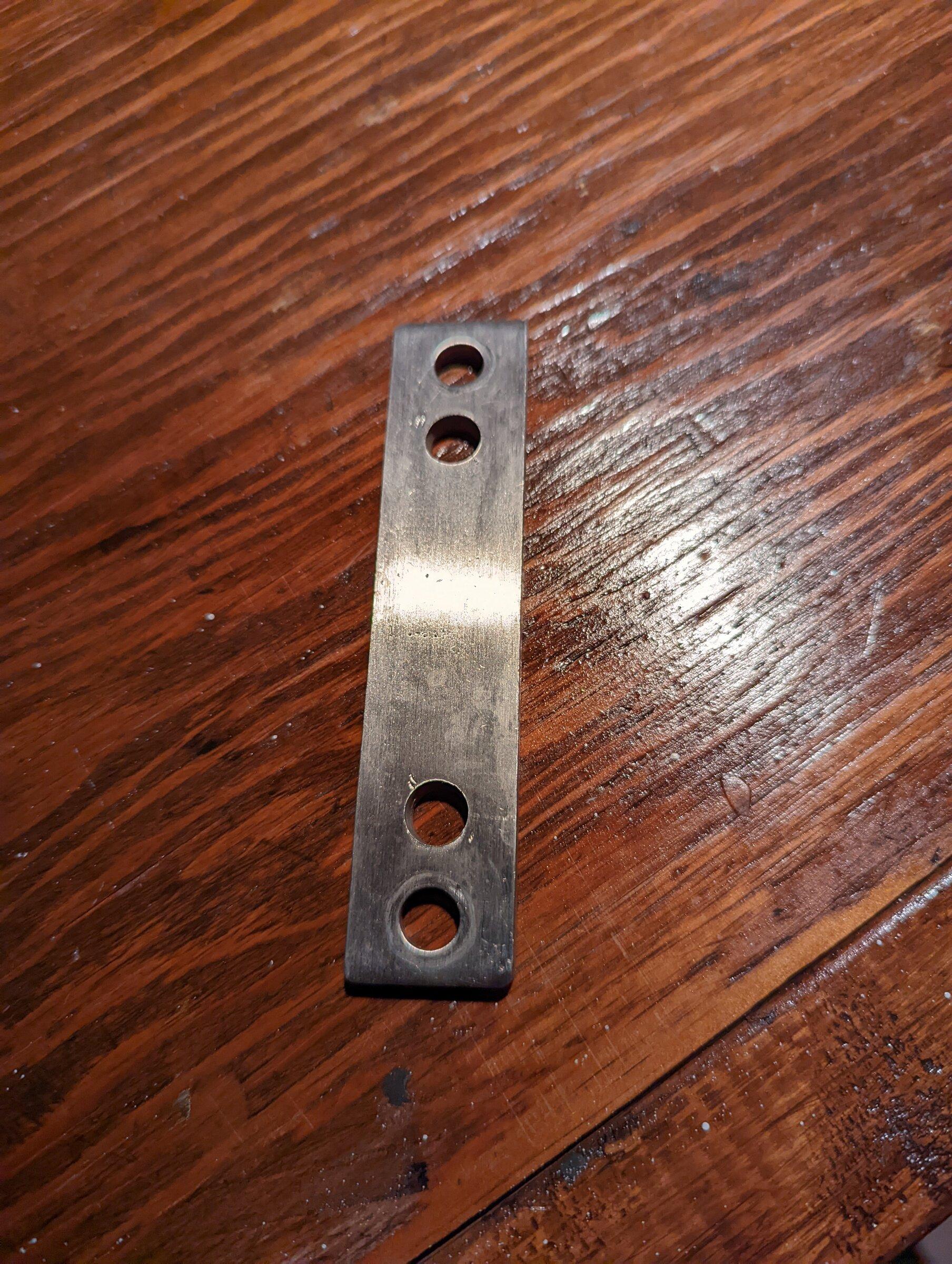

Please let me know. It seems the Rivian/Yakima crossbars were made specifically to latch to the Rivian (which is fine), but they're also an abnormal width compared to other crossbars on the market. I'm guessing people have made some modifications to their current RTT setup and just aren't willing to share or don't really know.
I have a Thule Tepui Explorer 3 and this is mounting plate. It's exactly 3.5" between the 2 outside holes. Hoping it will fit or I'll have to make new plates.

Rivian's crossbars are 3.625 in wide. Most RTT mounts fit 3.5 in crossbars. It appears to be an issue to me.

The RTT’s I have had experience with mostly use a pretty simple mounting method. The will have some sort of tracks mounted to the bottom of the tent. Bolts will slide into the track where the hex head bolt will not be able to turn. The bolts then extend past whatever rack they will be mounted to and through a metal bar/bracket (see SurlyBurris photo above) where a nut will cinch the bracket down to the rack. It’s all pretty basic and pretty universal. Some, companies may try to over think the whole process by coming up with proprietary mounting systems that can present issues and incompatibilities. There’s a lot to be said for the KISS system.
