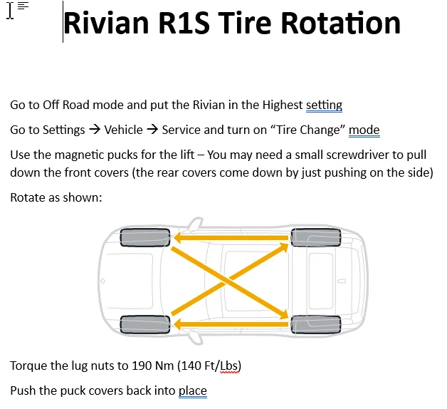

Get a set of pucks (get the magnetic ones) and train your favorite local tire place. The first time I took my R1S in for a tire rotation they let me into the bay with them to show them how the puck covers and pucks worked. Their only question, for which I was prepared, was how much torque for the lugs. It's why I put together the document above.

I just had my tires rotated at my local tire shop last week - they charged me $30. I put together this document and gave it to them with the pucks:
The document really helped them and I just folded it and put it in with my pucks. As soon as I buy a set of tires from them my rotations will be free. Find someone locally to do it (as long as you have the pucks).

Why are three tires front to back and one flipped to other side? Shouldn't the all be front to back?
