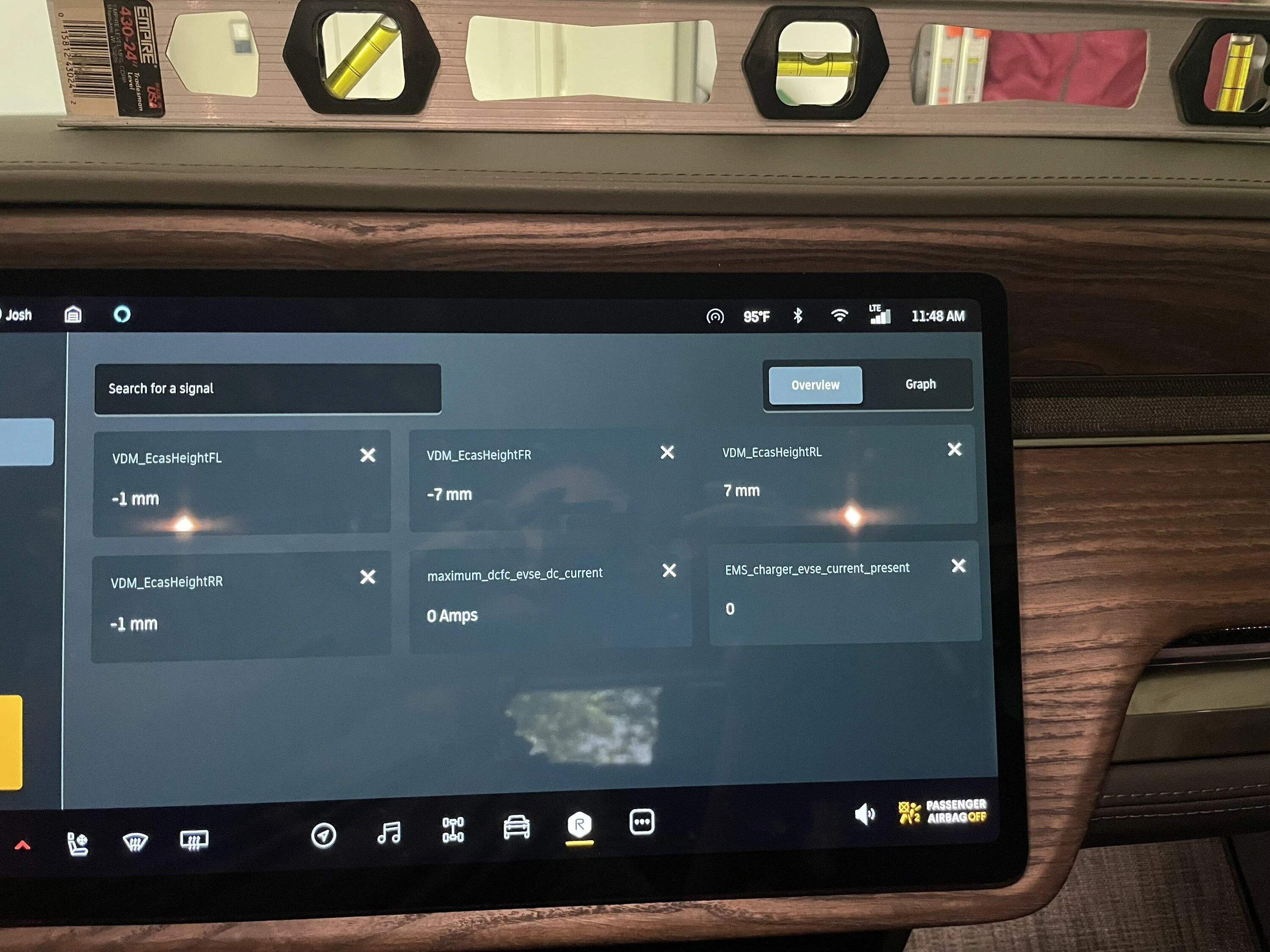

So if anyone is so inclined, you can observe the measured height of the suspension at each wheel in the service menu. The code you want is VDM_EcasHeight and there is one for FL, FR, RL, and RR. These are values measured in relation to the prescribed values for the chosen ride height - negative means compression and positive the opposite, relative to baseline.
It's kind of interesting to monitor them while driving and see how it changes. Steady state appears to be set for up to about 3mm of tolerance from one side to the other, but it can vary widely while driving, particularly while under acceleration (compression in the rear) and deceleration (compression in the front).
On a potentially related note, it seems anecdotally that my FR measures at a consistently lower value than my FL, by up to 10mm. This may or may not have anything to do with my rightward drifting alignment issue. The rear seems to stay more in balance. There is a graph function, but I can't ever get it to show any data, as it seems to only show the previous two hours on the X axis.

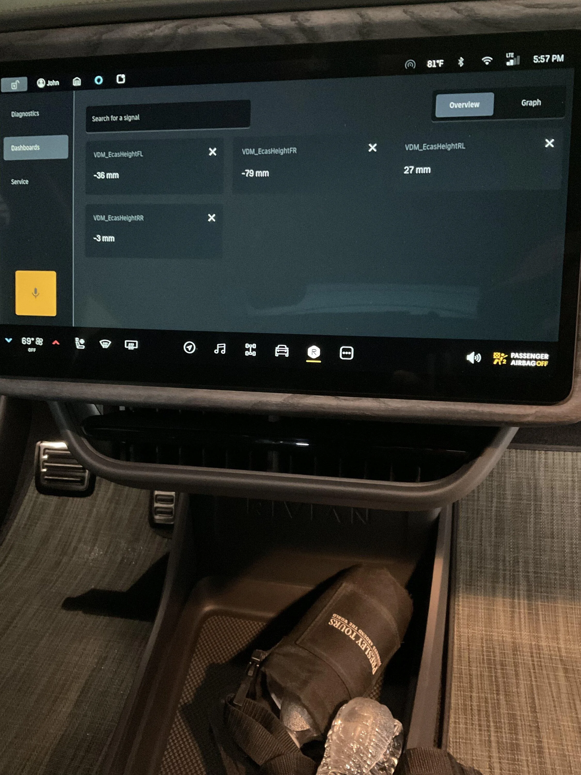

Mine parked (big diff), and woke (still diff)
I’m at a loss on what to do.
I don't see any reason to worry about what the heights are when parked. The second ones don't appear that worrisome to me, those are fractions of an inch difference side to side. Leave the screen up and see what they are when going a steady speed on flat terrain. That's all that really matters

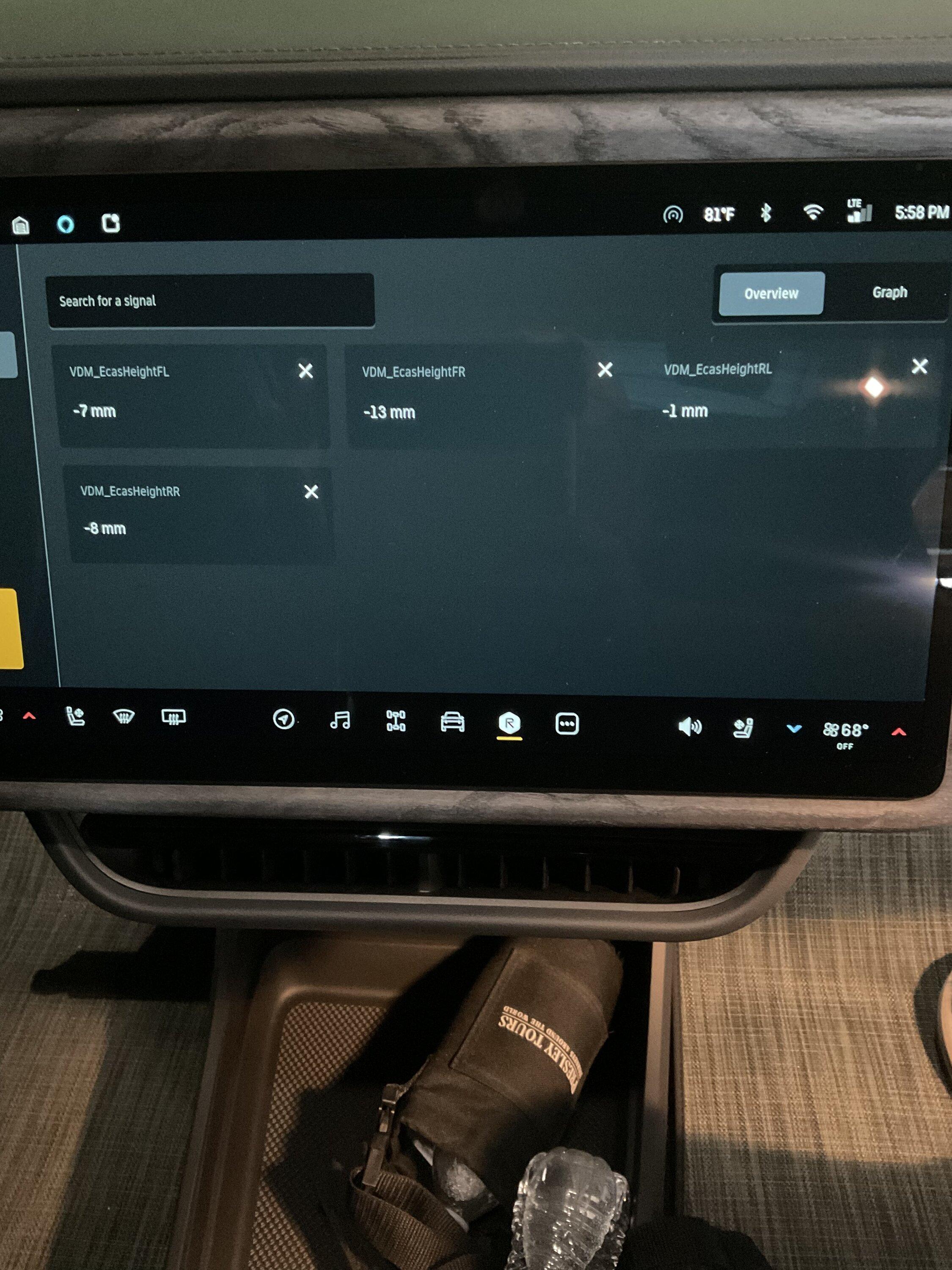

I think there's also a little misunderstanding of what these values are measuring. They are NOT measuring height from a fixed point, i.e. the ground, so as to reflect or illustrate whether the vehicle has a lean to one side or front to back. They are measuring suspension compression.
As an illustration, below is in my garage, which I also measured to confirm it was essentially level on the floor. You could also imagine a scenario in which the ground had more of a slope to it side to side. In that case, these readings would be even more skewed in showing more compression on one side than the other, but it wouldn't mean your truck is leaning, but rather the opposite - the surface it's sitting on is leaning.

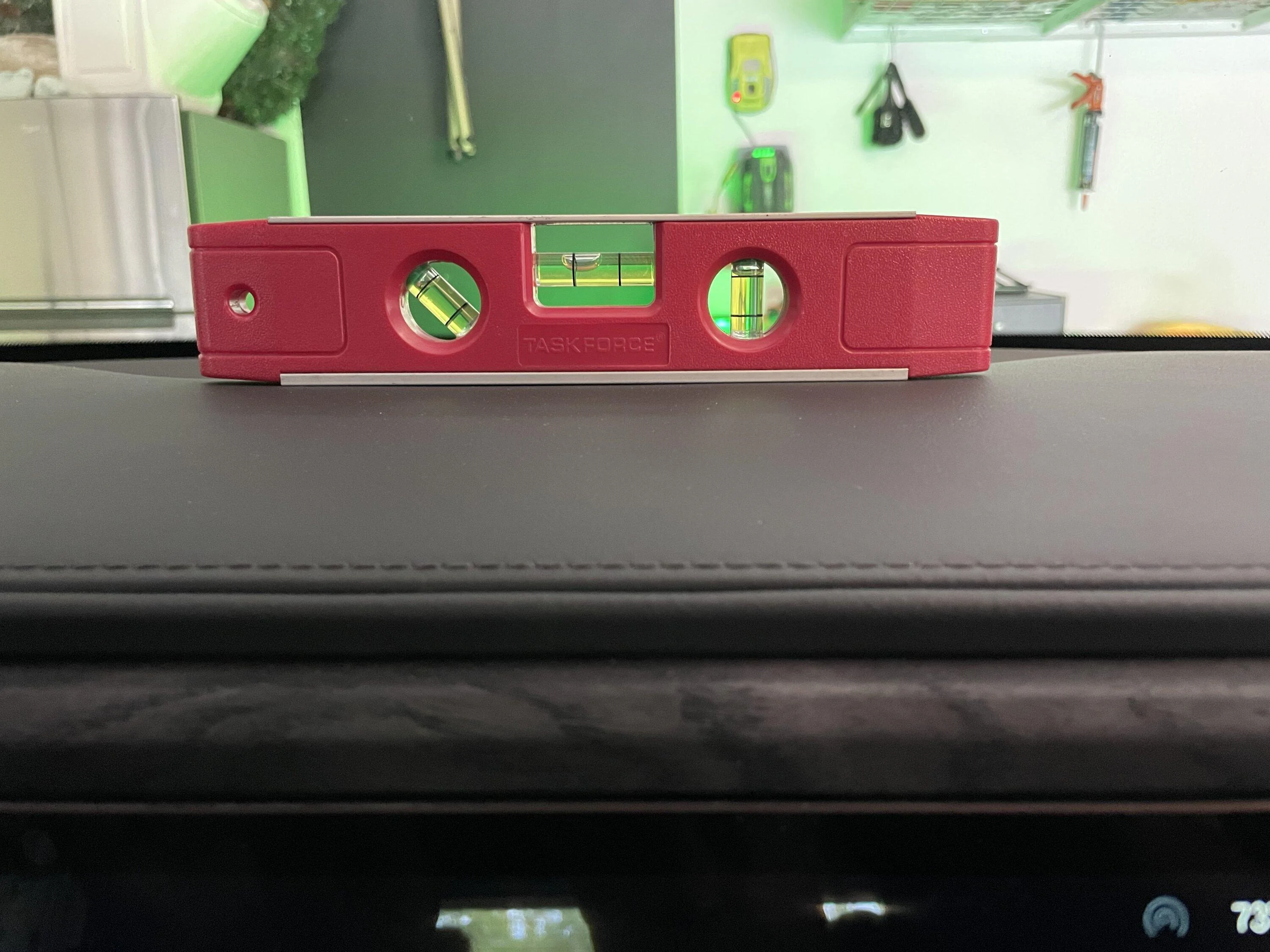

Yea…i agree. I want my level bubble to look like yours…and not the level bubble picture I posted.
Yours was measured after truck was asleep though right? Mine will look like that sometimes too, but it levels itself out once it wakes up and I drive.
They let the vehicle sag when asleep, so that's another topic entirely and there is nothing to "fix" when it's designed that way (at least for now). There's even another variable in that screen to measure the amount of sag.

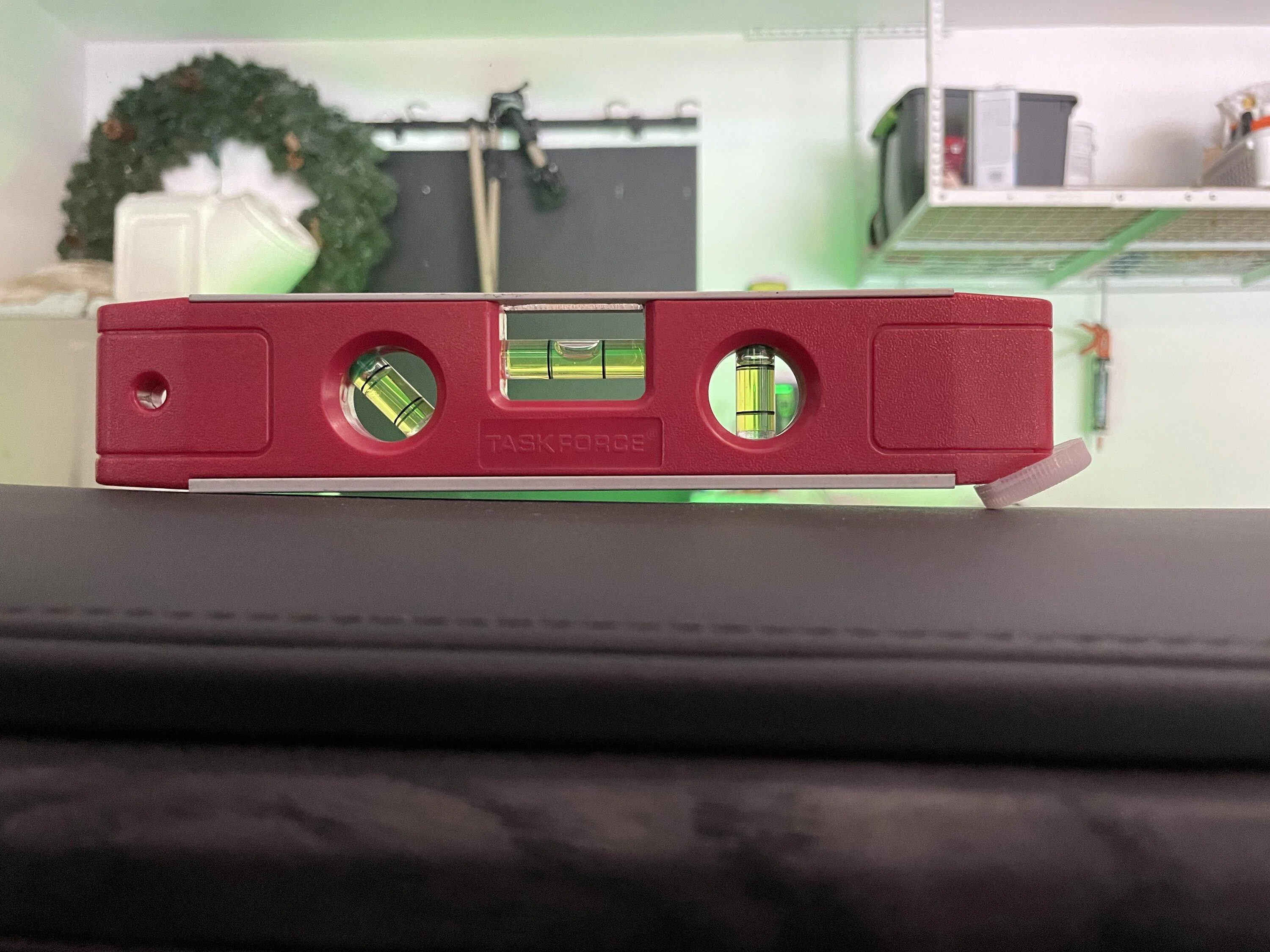

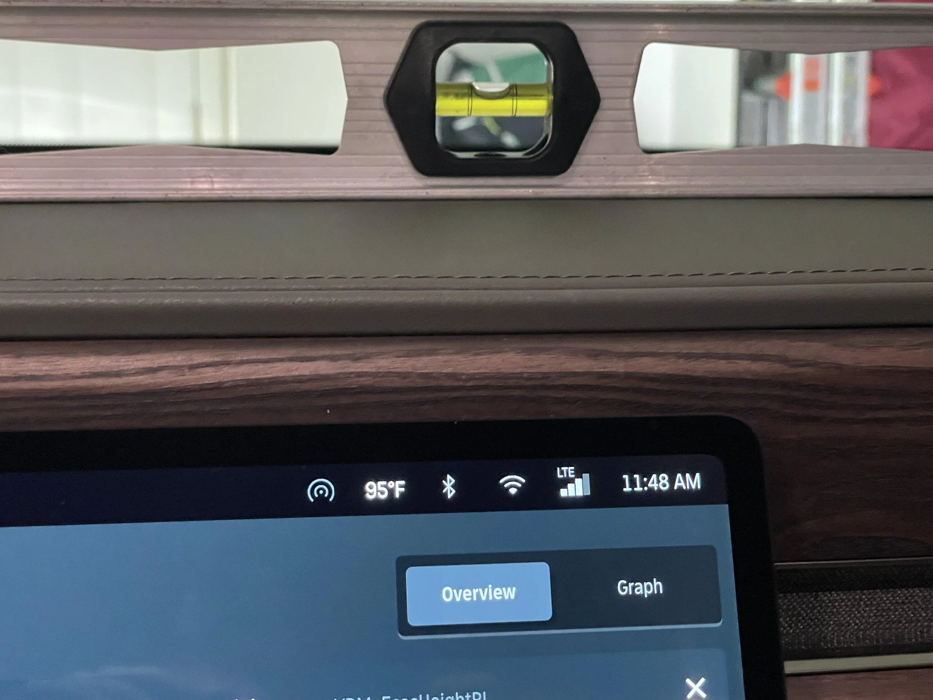

Here it is awake…level centered above the main screen. I stuck a water bottle cap on the end to get level.
I obviously took this pic from the pax seat…cause it’s way easier to get into the truck on that side ;)
